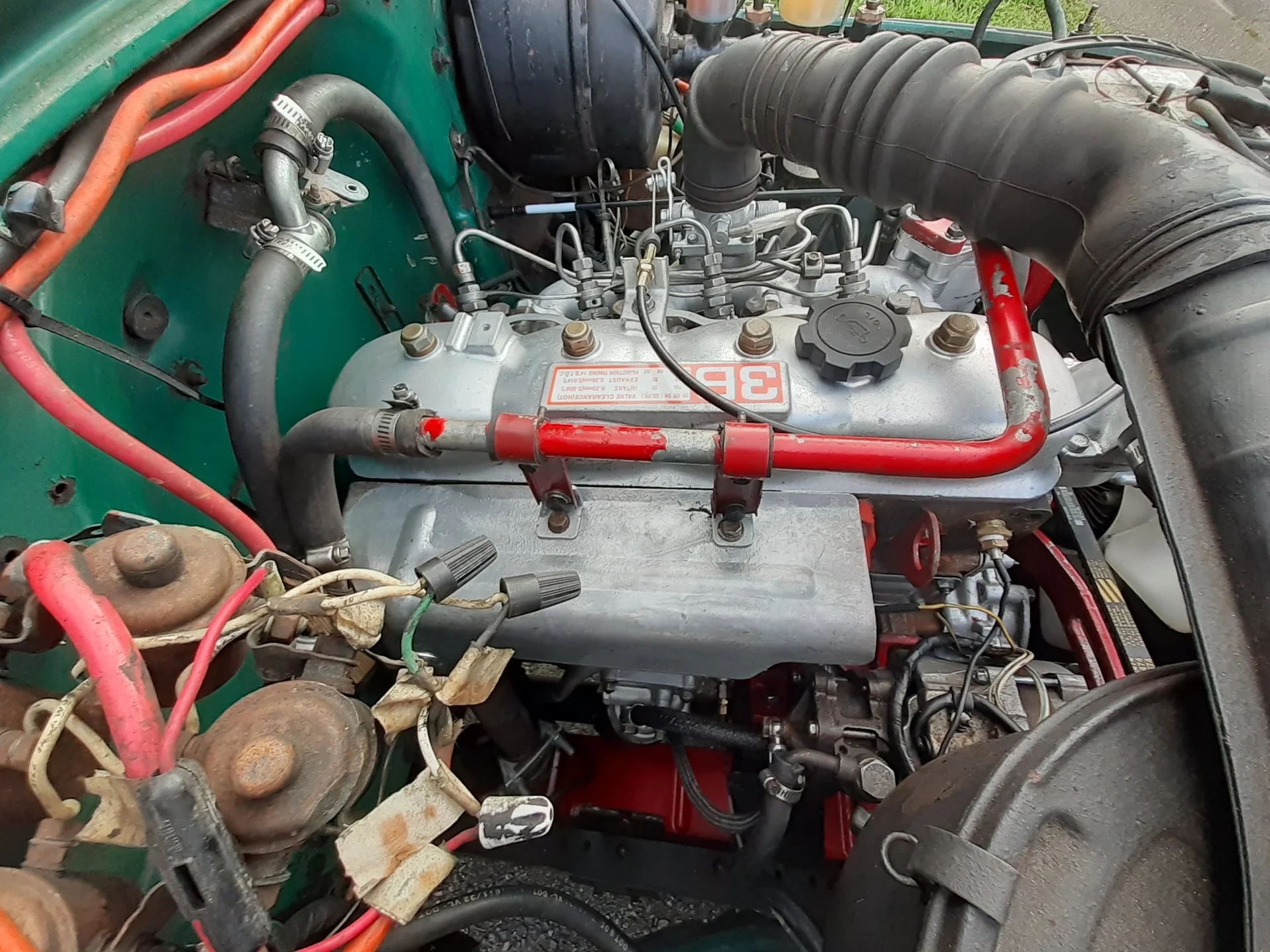

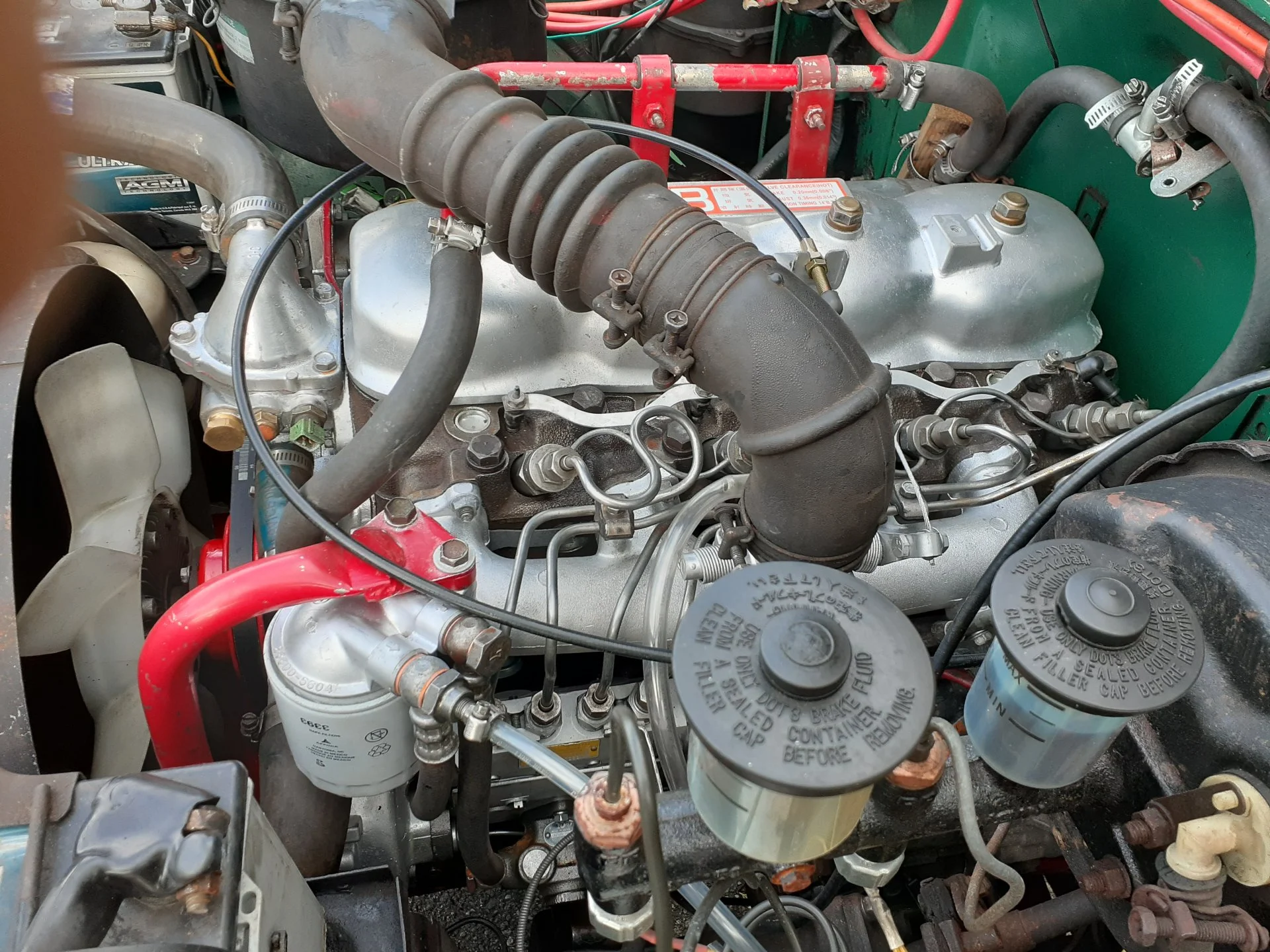

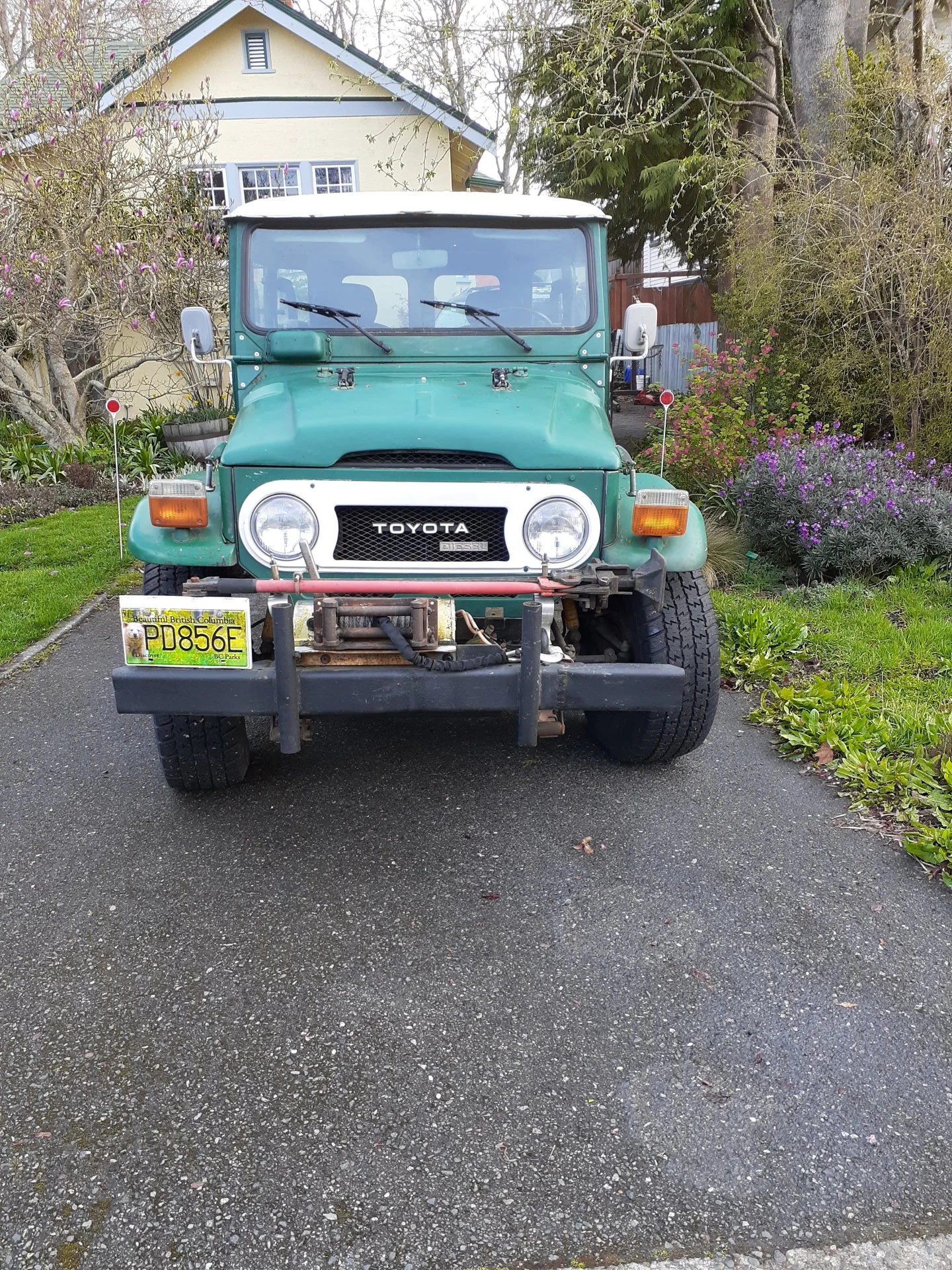

Here is what it looks like:
Wow!! Glad to see it back together! I look forward to seeing in person. Nice work. Is that a rebuilt 3B, or did you get your hands on a brand new long block?
It is cobbled together from two old 3B's - one from Steve and one from the lower mainland - new sleeves/pistons/lifters/oil pump/ .... you name it. So everything that was not within tolerance was replaced with brand new stuff. I have all kinds of spare bits & pieces up for grabs if anyone wants anything, just ask :oops:
