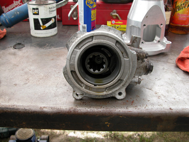

where that nose cone come from ? is it one of Warden's ? Got any more , Poser , Kurt , Dan , anyone ?
Yes that is one of Wardens fine pieces of art....
I installed them on the Orions for the Orange and Yellow trucks, and have one on my three-speed case that I removed from the Red truck for the Atlas...
Right now, I do not want to sell it John, Sorry.
:beer:
-Steve
how'd you get 3 of em . Give it to me , now , hurry , before it rusts. That atlas is gonna break and you'll need money to fix it. C'mon , it just aint right to have that on a stock case , it belongs on an orion , mine . Damn it man , let me have it . C'mon , everyone has a price , throw somethin out there maybe I'll bite.....
the Wardens billet nose cone is nice, but IMO not worth it....protect the nose with a proper skid plate from ANY contact, and it'll survive fine...
Know what a busted rear coarse pinion looks like? the front t-case output looks exactlee the same when it breaks...been there, done that.....the "oh so weak" stock cone was just fine.
I broke my stock nose cone last year in the Hills...someplace before Flat Nasty....figured it was from suspension droop/being forced downward, trying to pull it off the case, as the top ears were broken...and the shaft was fine....
But those two Caterpillar bolts held the cone on, and I ran the trail, and drove it back to camp...
:beer:
Good luck!
-Steve
Yep, I have seen the ears bust and crack the cone on a few cases as well. You can protect the nose with a skidplate, but what about when the d-shaft is sitting on a rock and appling upward pressure on the case. That will crack before the pinion does.
I would think some sort of fabricated steel brace would work very well at supporting the nose cone. Something I plan to look into building... since my Orion will be under an FZJ80.
