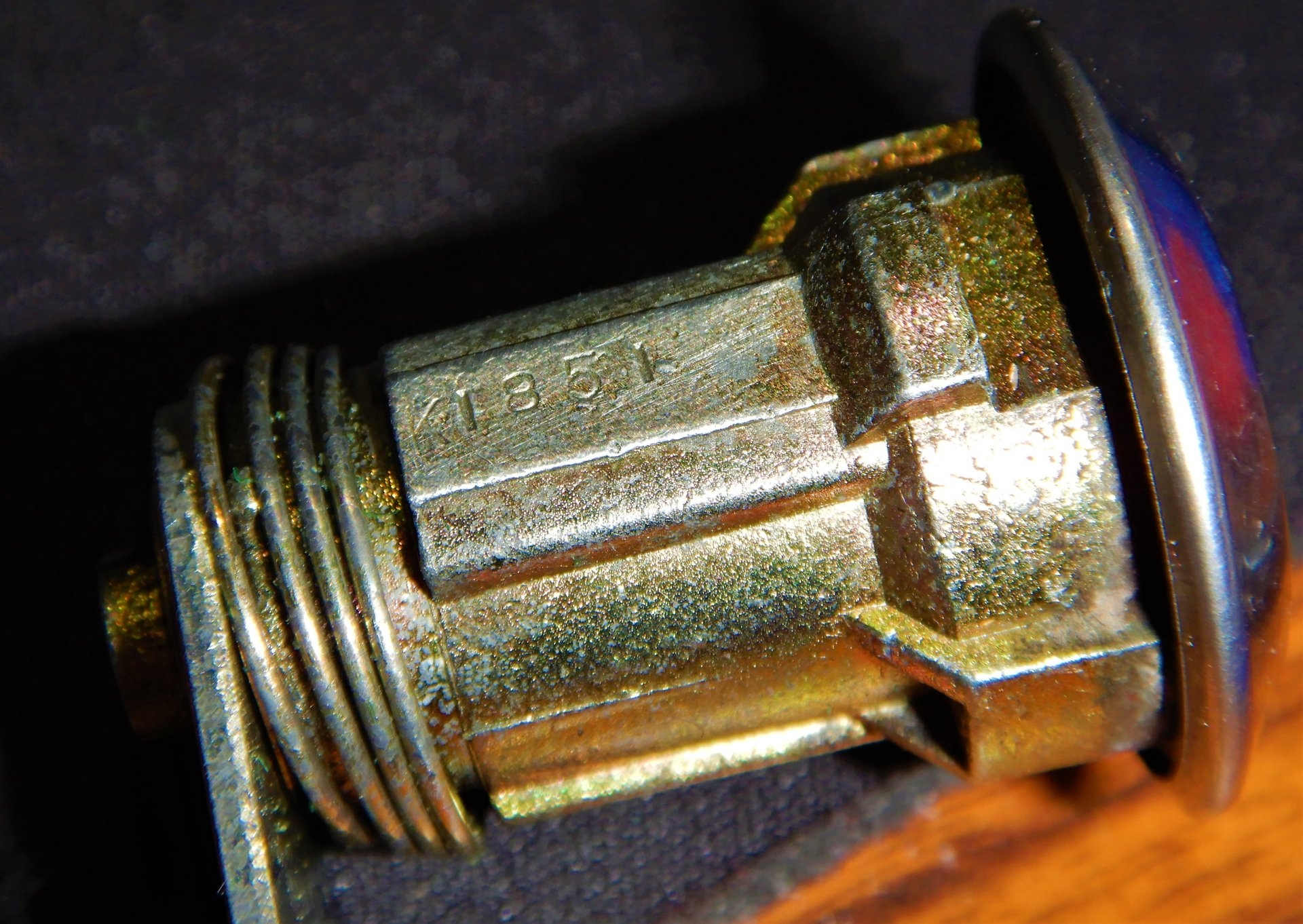

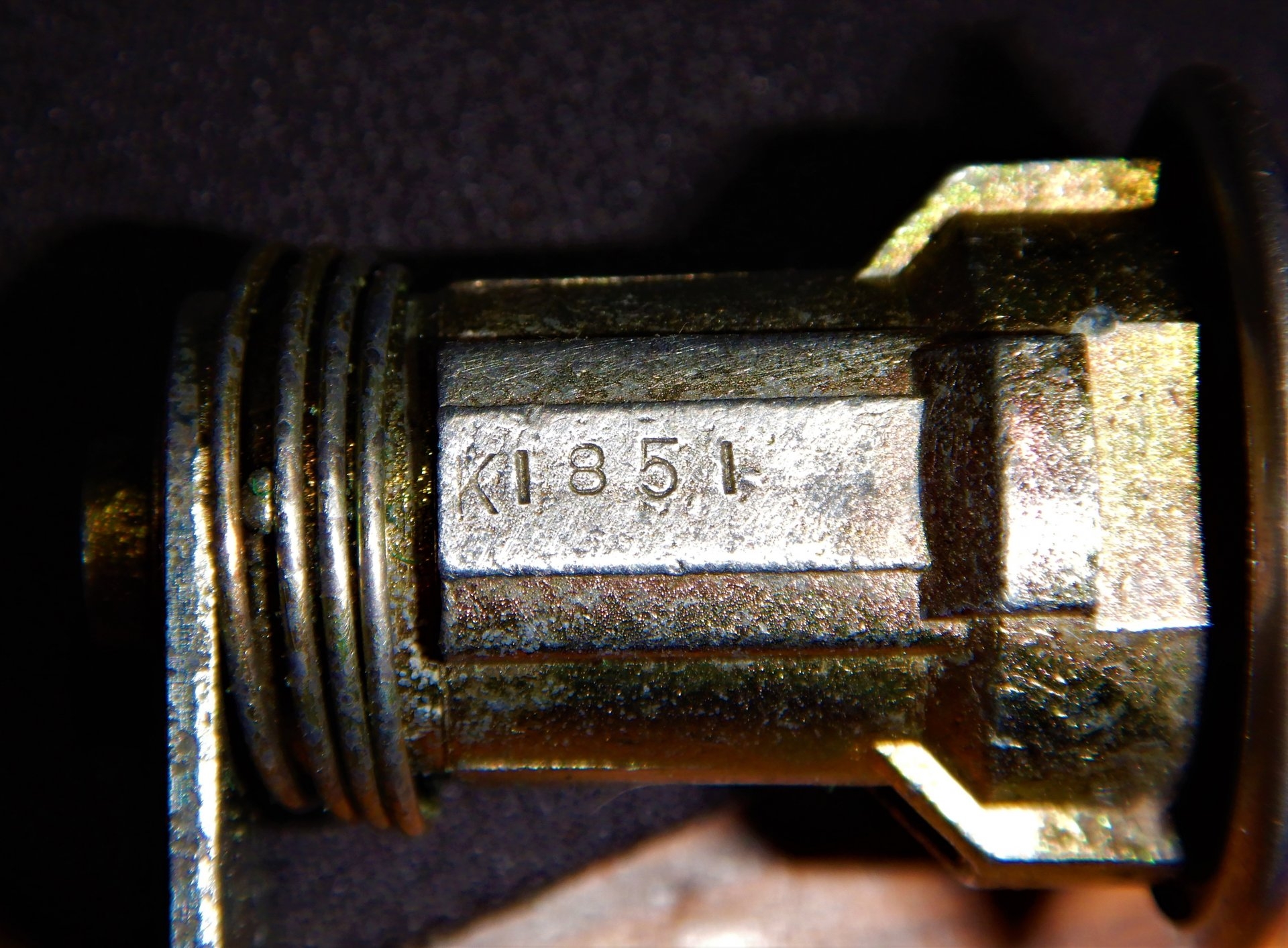

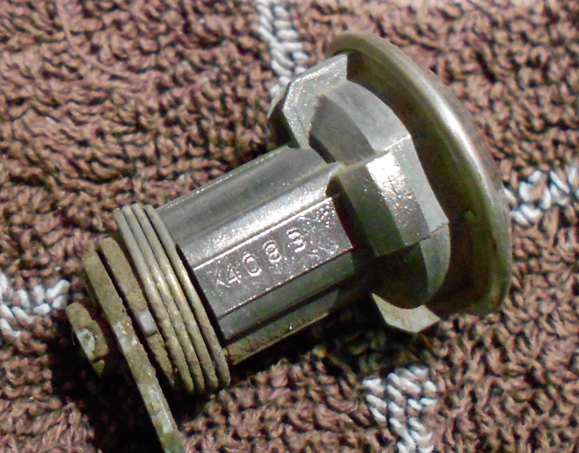

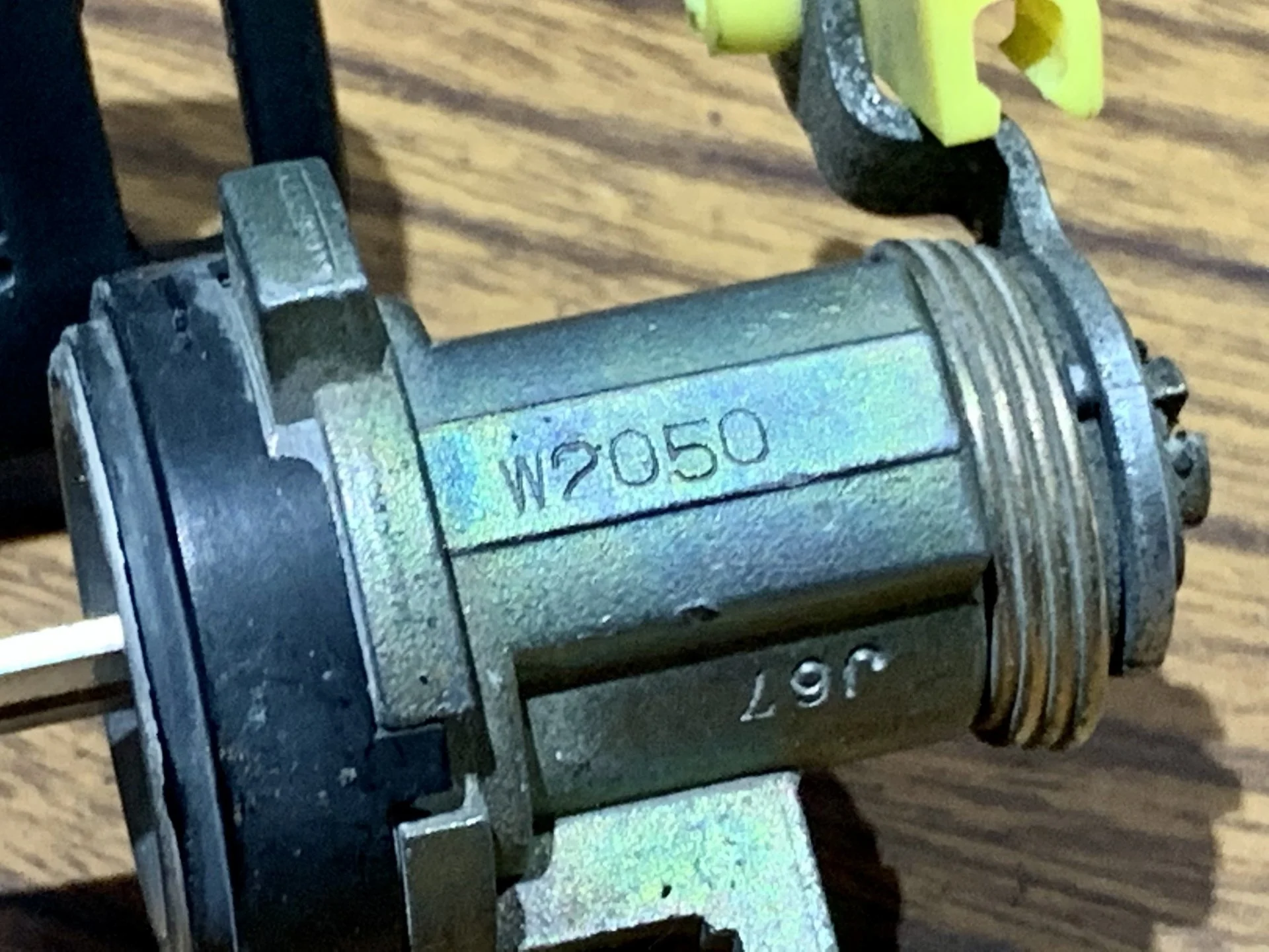

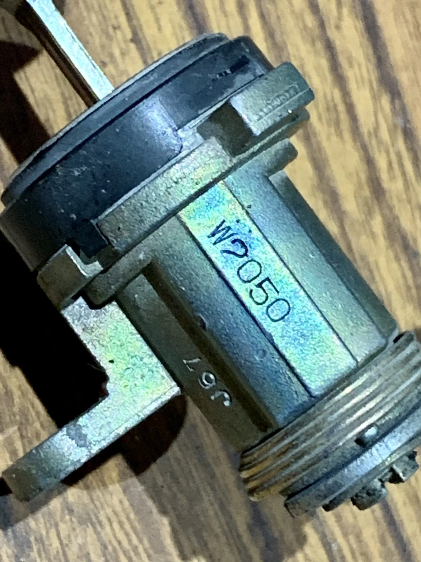

YOUR KEY CODE is stamped on your passenger side Lock cylinder or RH one if you have RHD NON USA truck
you must completely remove the lock cylinder to extract and view the code itself
these are 1980-1990 FJ60 ones , the concept is the exact same ..........
you will have a W series code

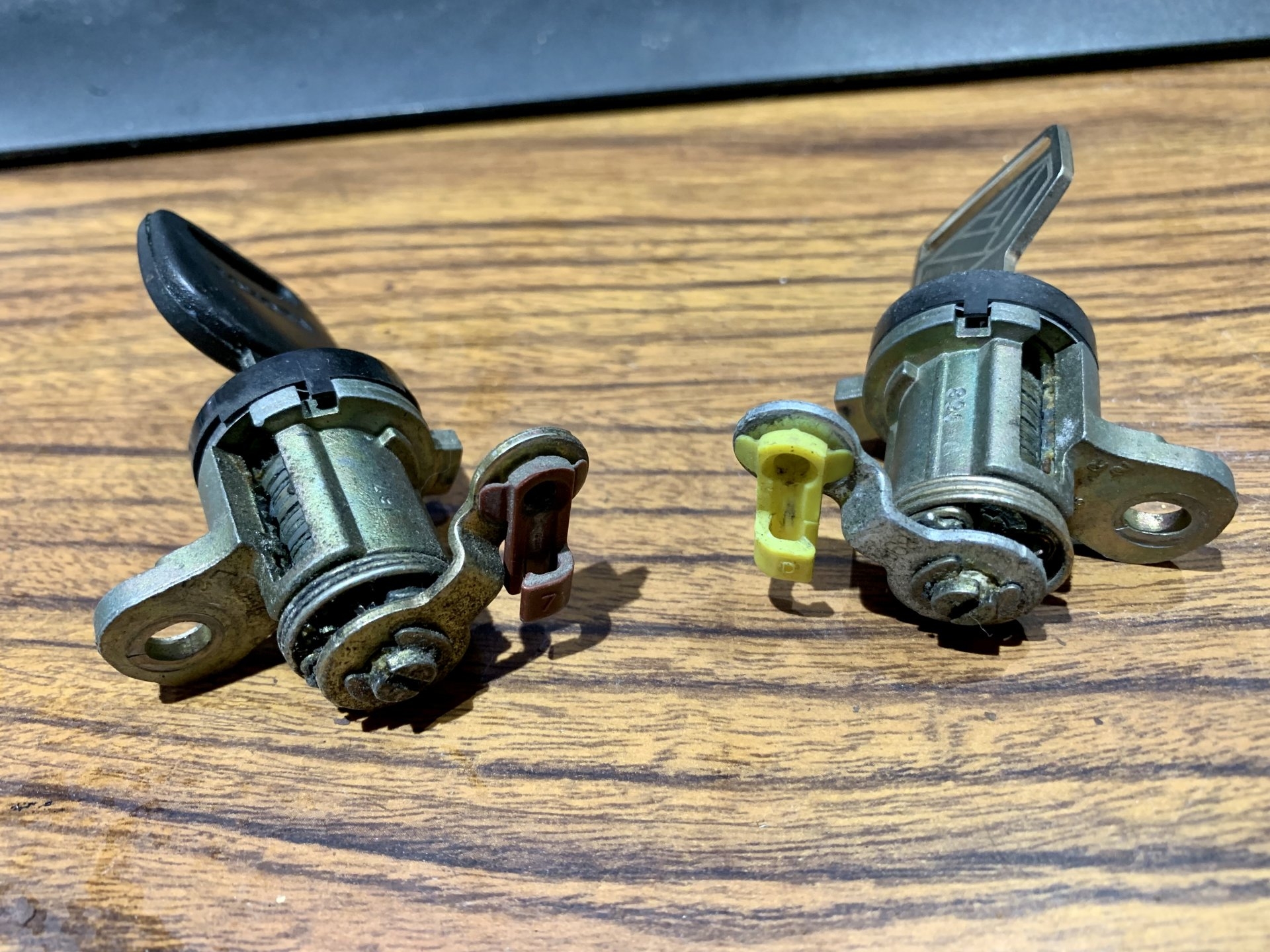

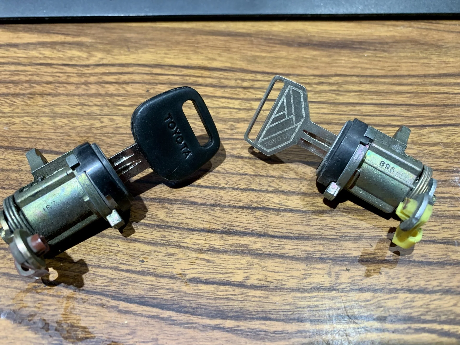

Here is a set of 80 Series front side door locks
I have a specimens and I practice making code cut keys
Note the W - 2050
the W series factory hand stamped key code so some times hard to tell ?
so take photos well

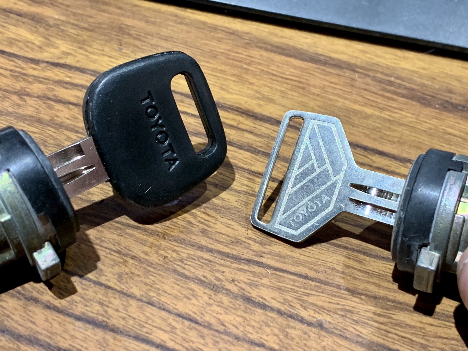

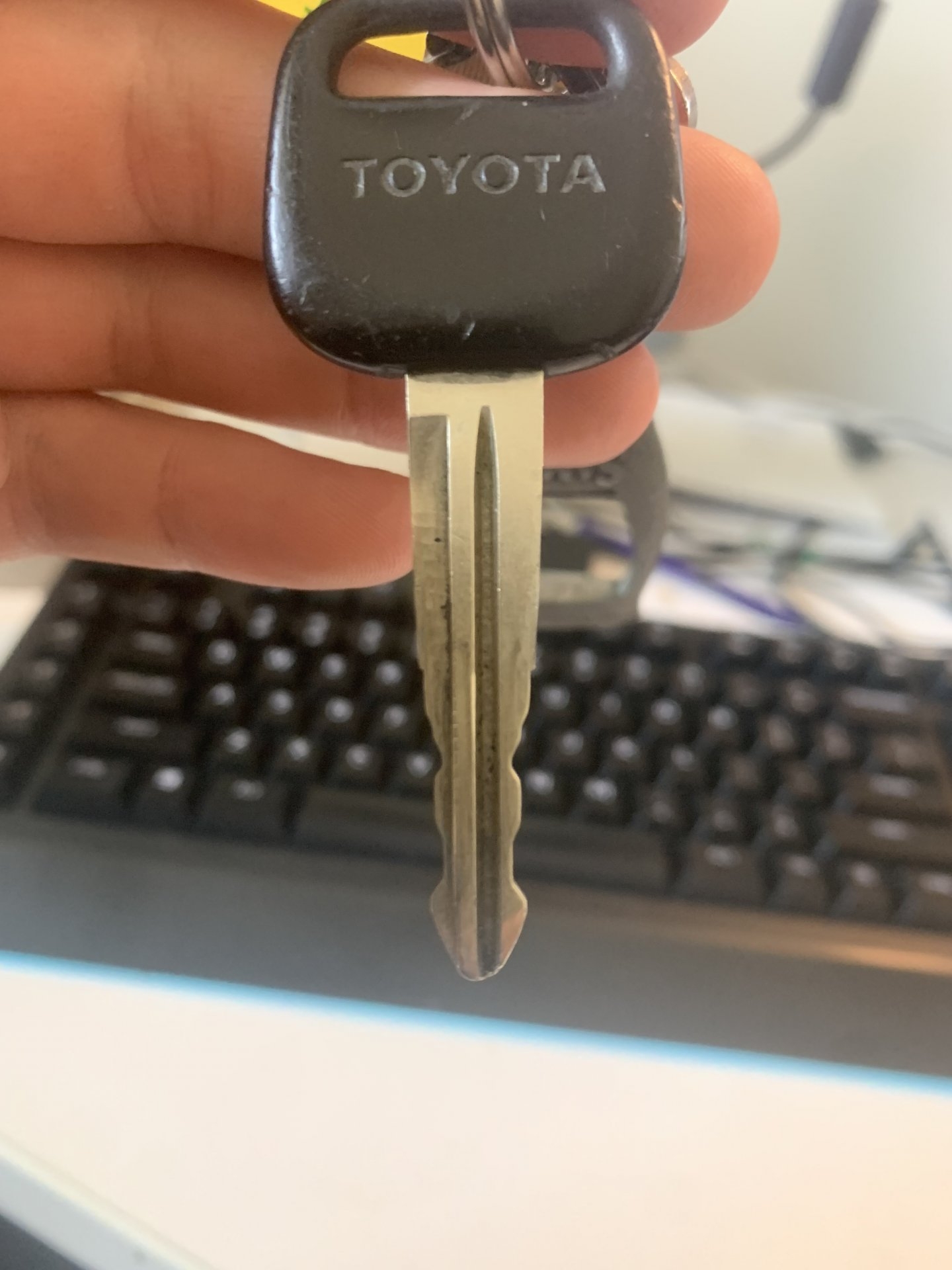

Looking at the key it seems to be an original based on guidance earlier in this thread:
I suppose that is certainly possible, wish I knew for sure. Key works everywhere without any real issue in all locks but the hatch and glovebox. I initially thought it was just the spare/valet key and the spare I have was based on that. But looking at the first couple posts it sounds like maybe only the original master came with the rubber/molded plastic shell and the spares were metal(?).
That key is certainly worn, maybe start with @ToyotaMatt making you a new one? Do you happen to have an ultrasonic cleaner or anything like that? The rear hatch mechanism is pretty easy to remove, and almost all the ones I receive for rekeying are completely gummed up. If you just pulled it out of there and spent some time cleaning it, you should be able to judge if it's the key or the lock.
