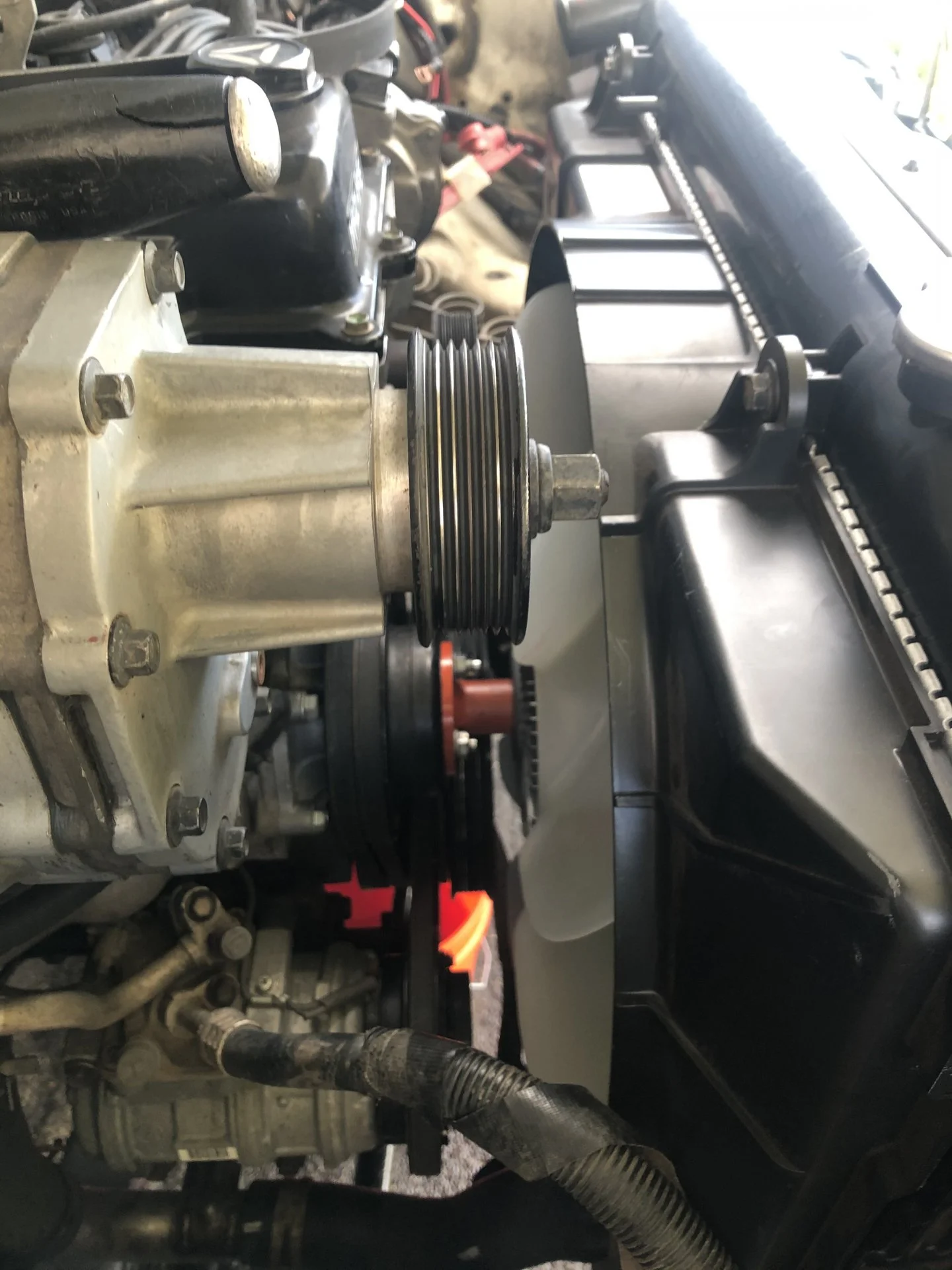

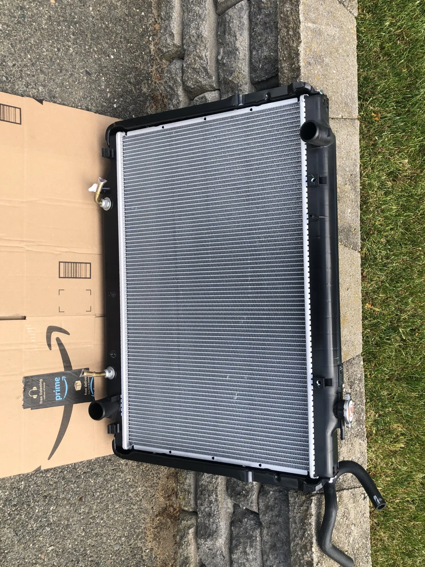

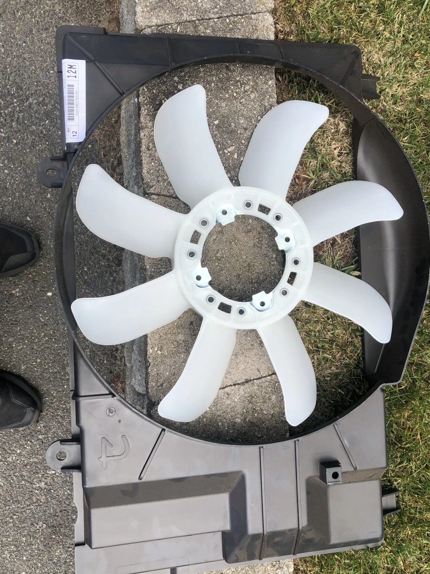

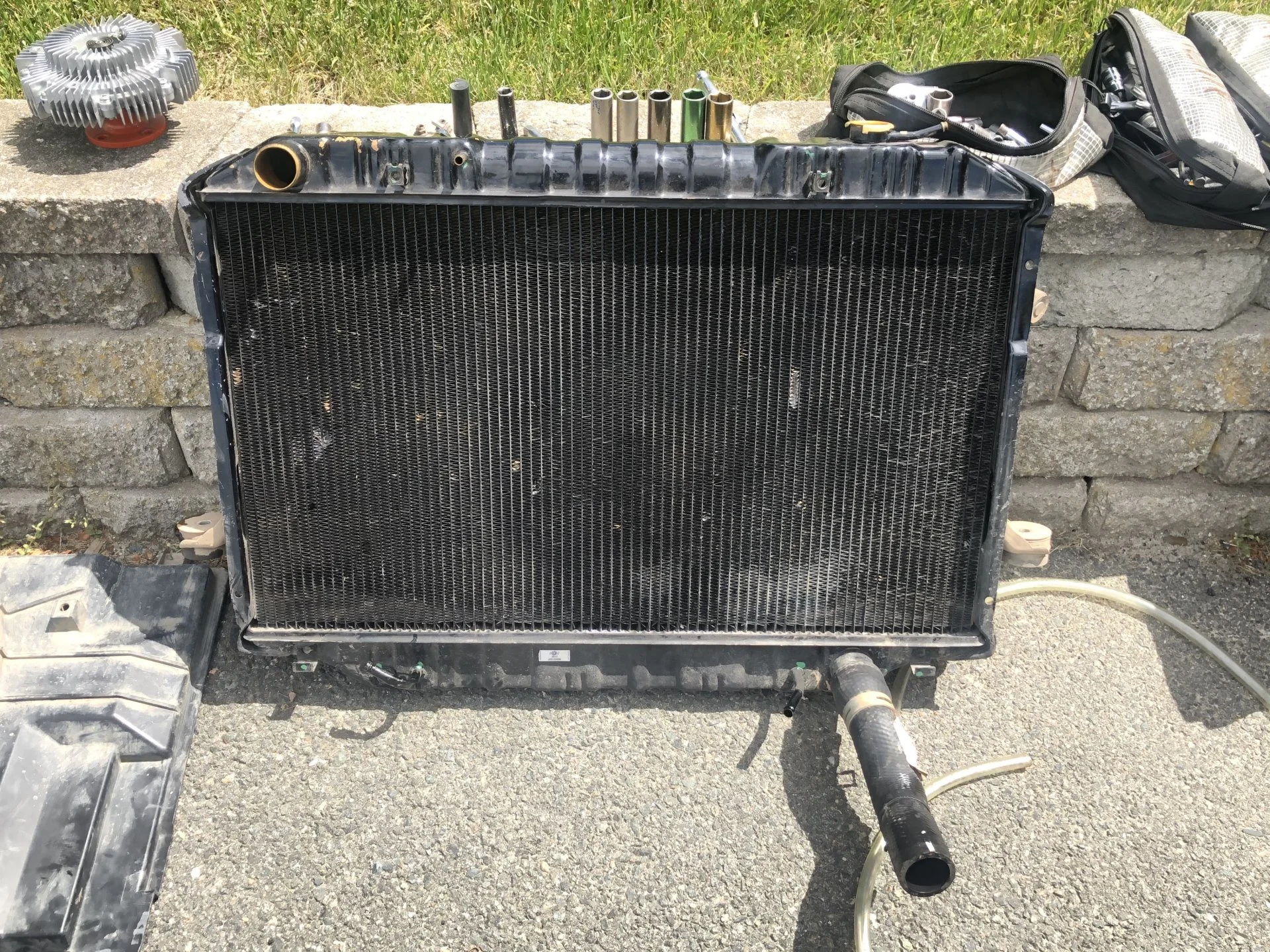

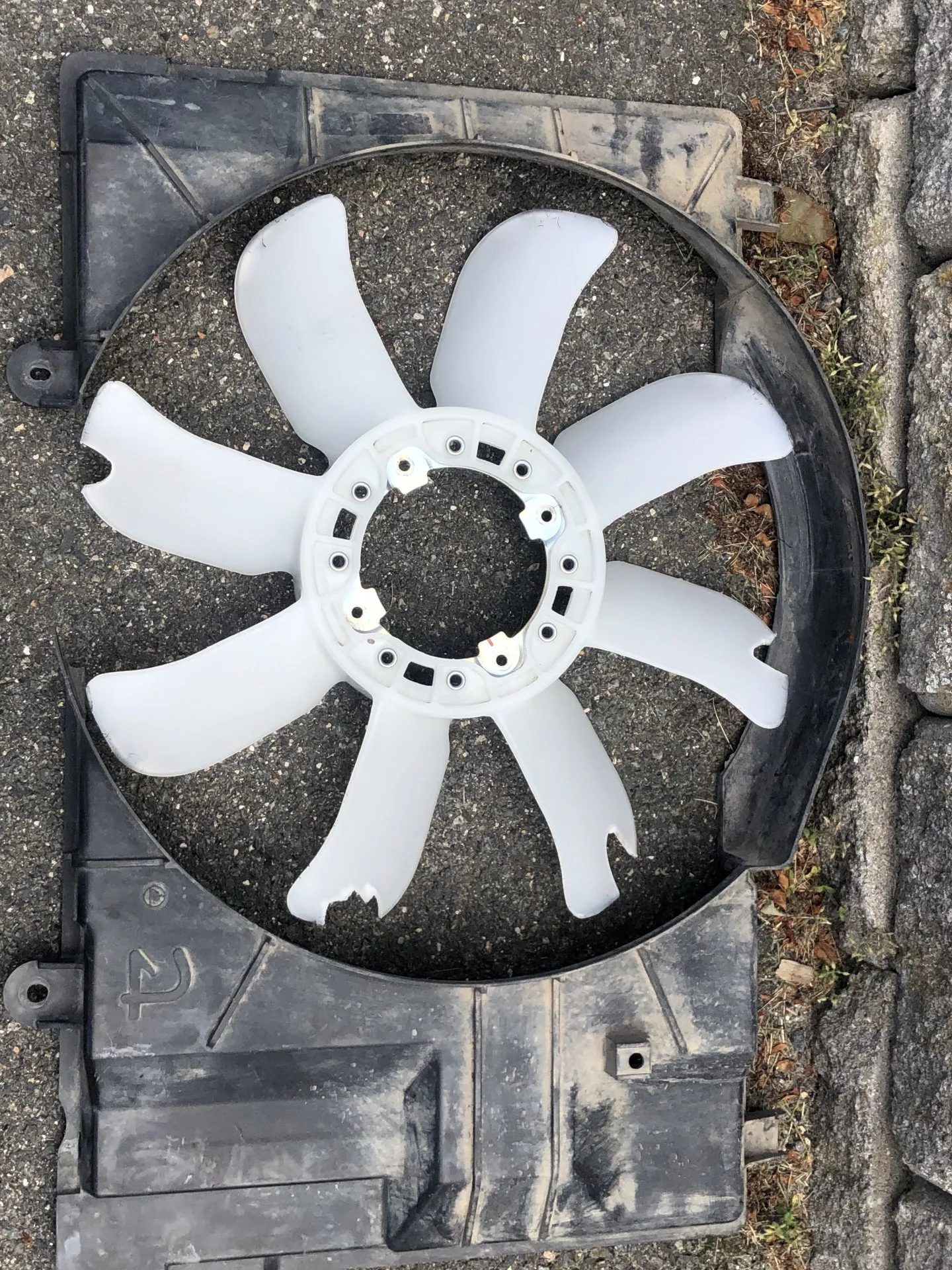

So in december 2020 found myself in Arizona Talking to a locla shop owner about the availability of an OEM 4.5 long block he said Dude I can get that here by tomorrow and he did in it went rebuilt the supercharger and changed everything that moved, AC new, water pump new motor mounts tranny you get what Im sayin. The one thing I really wanted besides headers was a metal radiator found one by CSF put it in hit the road, even in dec. the truck was running hot 197-211 thats not my normal at all My rig has run 186 almost forever with OEM radiator and @landtanks blue fan clutch. So I got home and got hold of Rick (landtank) got my slippery lil hands on an orange fan clutch( modified diesel clutch) install new shroud ORIGINAL 4.5 fan Not the supercharger fan and the trucks running 5 degrees BELOW my normal which was awesome as it was. SO there as they say is that. If your supercharged get the orange fan. or dont. Oh almost forgot the 3 ii custom exhaust KGPerformance built me tied to the cxracing header sounds so good it makes you want to kick a kitten into a swimming pool. now thats JMHO

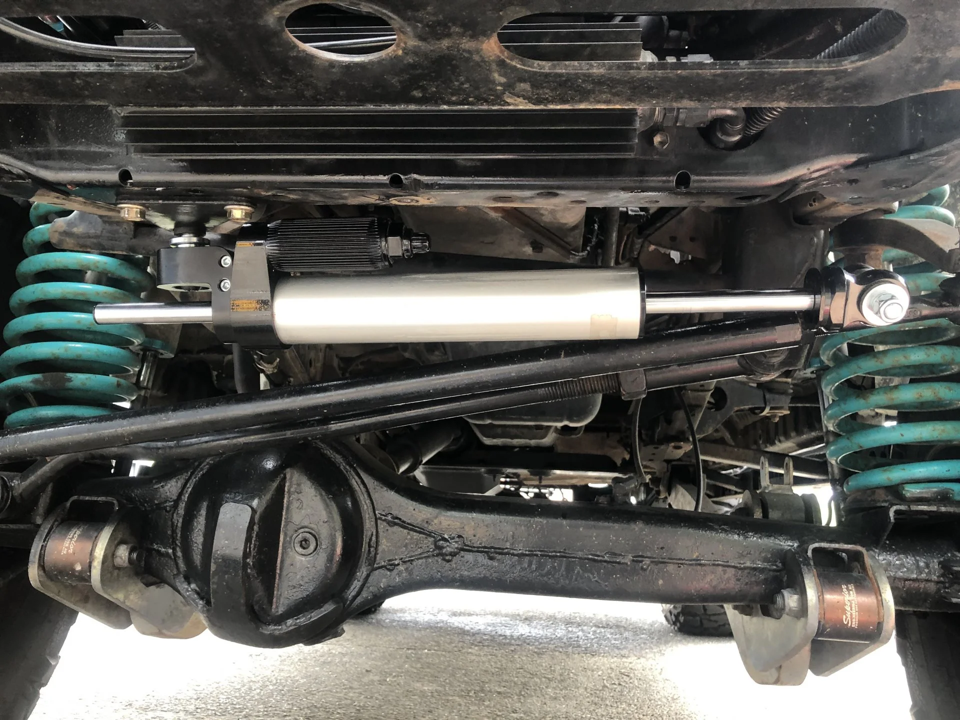

Oh one more thing I installed Dobinsons new resovoir steering stabilizer, and its gone the minute that rain stops. not sure what the deal is but it made my truck ride like all my TRE were junk, and they are all actually brand new because my 37s love TRE's that is all.

I'm not the expert but they do the same thing, the difference is that you dont need to use the fan spacer on the SC models. 1FZ doesnt have a fan spacer.
The only diffferece between the two is that the orange clutch is taller and it costs more.
It’s that additional height that allows the removal of the spacer used with the TRD setup but still allows the factory fan to clear the serpentine belt.
Just run the blue clutch.

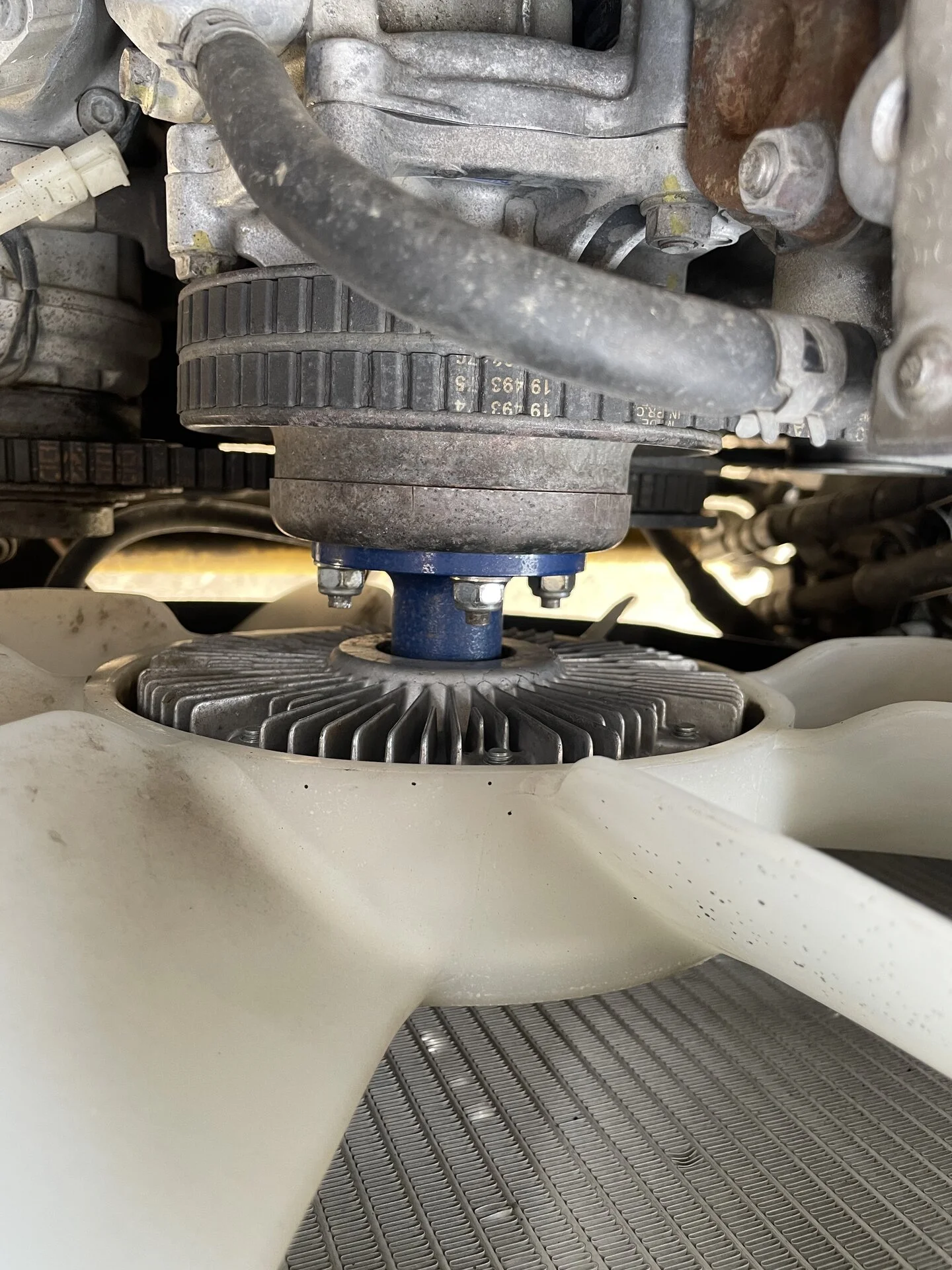

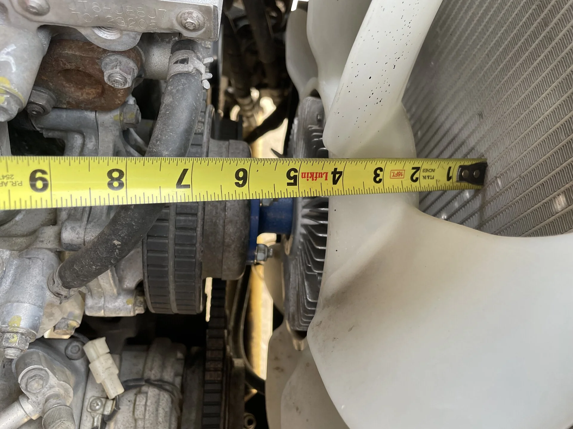

Are there different spacers for the blue fan?
My spacer measures at 3/4” and the distance between the front of the fan to the back of the radiator is an 11/4”.
Should it be closer to the radiator with a thicker spacer?
Longer than two paragraphs, sorry. Moral of story I don’t have a spacer and my temps are acceptable so not sure space makes huge difference. Someone smarter may have better info though.
Are you having any engine temp issues with the current setup, or just curious?
I’ve recently (within 15k miles) put a new engine in, replaced fan, shroud etc. don’t think mine (as long as I’ve had it) had a space for the fan. I’m sitting at face of fan to rad fins, 1 7/8” -2”
In the Utah heat, I now run 177-184 during the spring up to 80 degrees ambient temp. Summer with 90-110 degrees outside the lowest operating temp I get is about 186 with around town driving. 75mph on a 100 degree day I can notice the fan kick in via scan gauge as temp will get to 196 then come down to 186 then repeat every so often.
Replacing fan clutch made a world of difference for my temps.

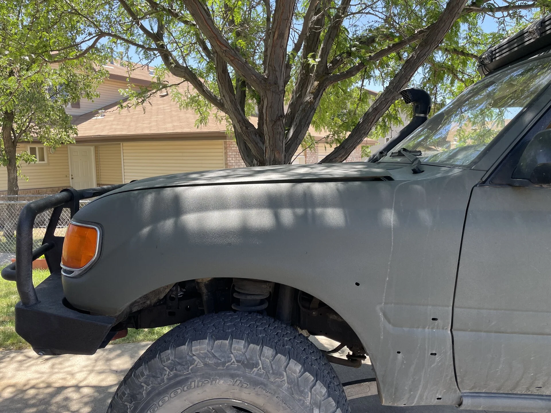

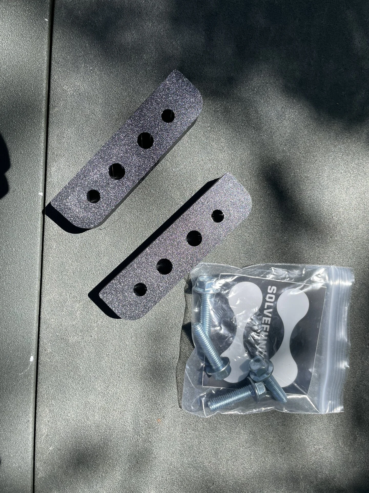

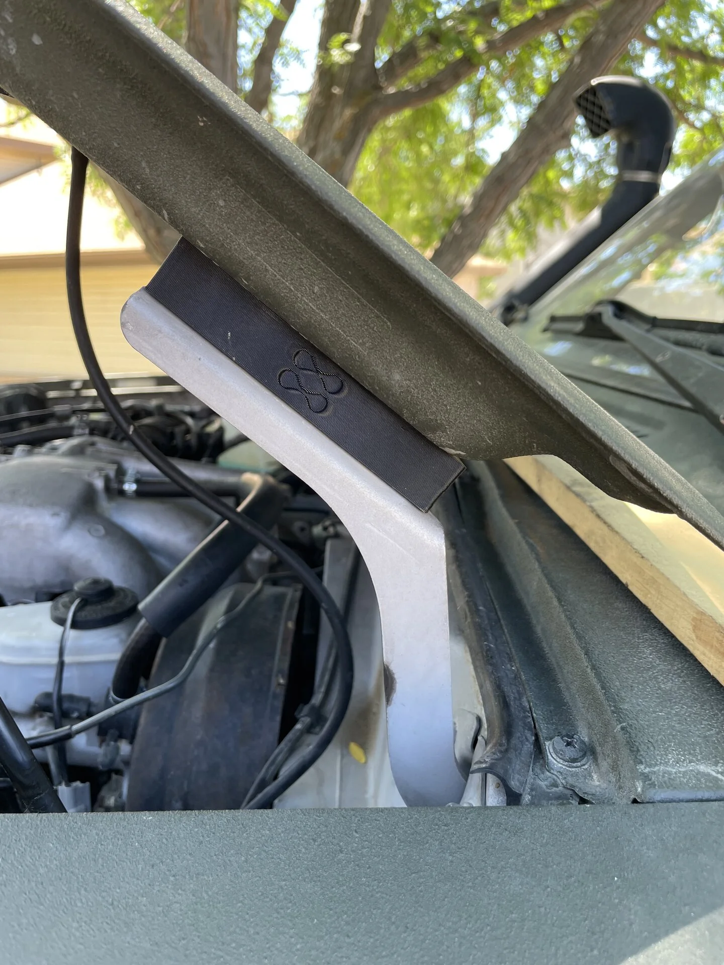

Gotcha. Have you spaced up the hood at the hinges to “vent” the rear?
It looks goofy in my opinion, but I’ve done that and it did help for the 55mph plus drives. Think it was referenced in this thread before but at certain speeds, the nose of the rig more pushes air out of the way than into the engine bay past the rad.
The hood spaces did make a noticeable difference In what I assume would be the vacuum of air flowing through at speed. Basically allowed a path for hot air to exit.
