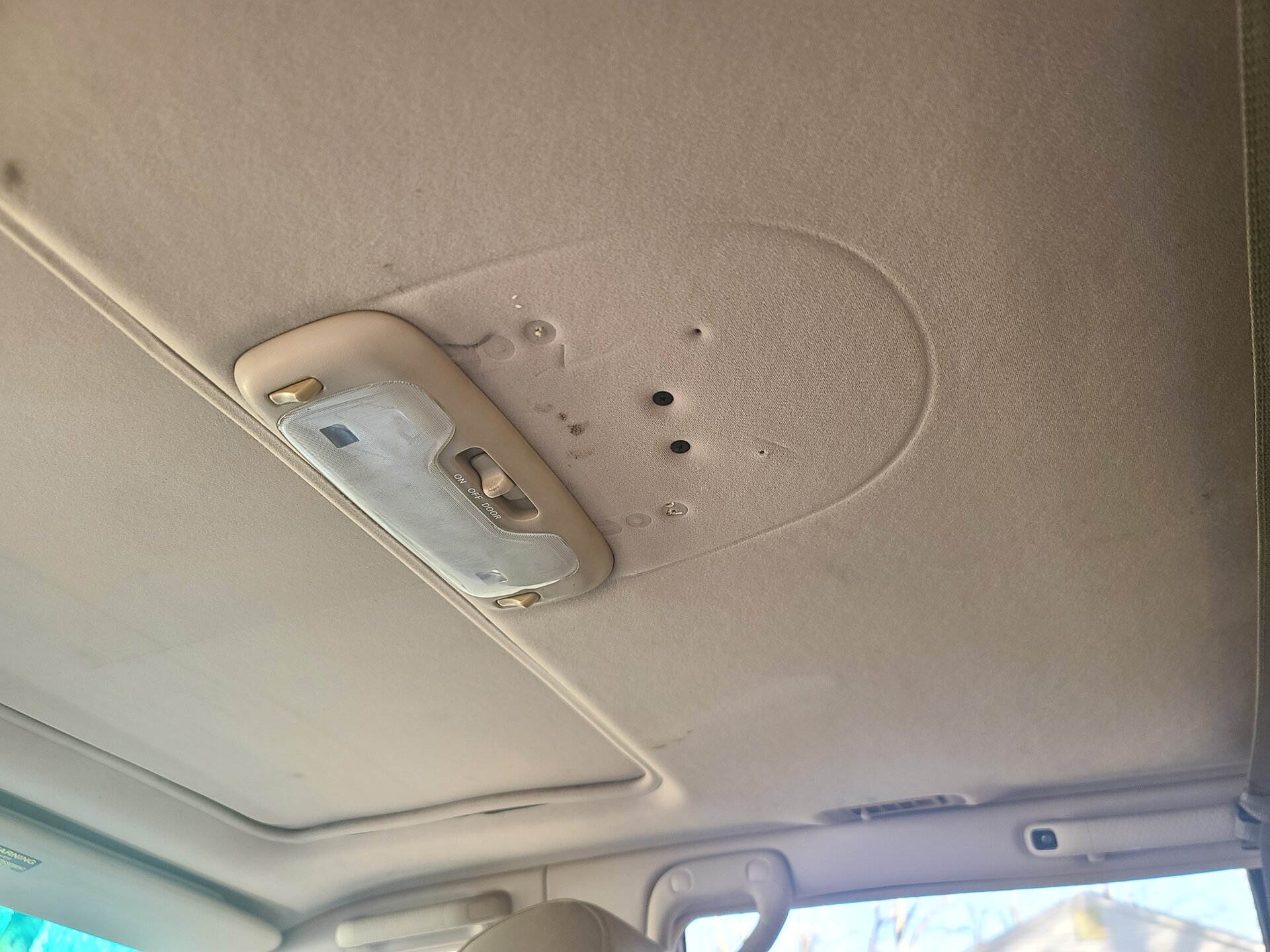

In my 2001 LX, I just removed it and screwed in the OEM light in the same location. Was pretty easy, think I had to splice some wires. Only issue is the indentation on the ceiling fabric from the old DVD player shows. Ill grab some pics later.
Yep, as stated above. I replaced mine with the factory lights from a partout. You have to splice a couple of wires but it's fairly straightforward. I still have the indention in the ceiling where the dvd player was but I'd definitely rather have that than a non-working piece of crap eyesore.

Here's a picture of mine. Definitely need to figure out a way to clean it up.
Crap, that is not what I was expecting and I bought the dome lamp yesterday. I was hoping there was an aftermarket, color-matching, thin flat plastic "cap" for lack of a better word, with a small lip in its outside edge, that would mount in place of the DVD player, with holes to mount the OEM interior dome lamp to/though, that would fit the outside footprint groove of the DVD player. Can't one of you smarties with a 3D printer rig up such a thing? Maybe fashion a hat-holder or something else practical to go along with it?
That was sent to me by a fellow MUD member, skiwpk. When I asked him where he got it, he said that it was a Target cutting board that he painted. Doesn't look too bad to me. Mine is worse than the picture above. The PO cut out all of the headliner material, so I have 1 BIG hole to go along with the creases. Haven't done anything yet, since the lights in the aftermarket DVD player actually still work.

Mine kept falling out if I hit a bump, dangling by the wire. It didn't work anyway, so I put a screw through the middle to hold it. Probably will just live with it unless I do something like skiwpk.
I had a big hole in mine. Found an overhead light on ebay, but still didn't solve the hole issue. I ended up taking a thin piece of sheet metal the same shape as the old dvd player and screwing it to he headliner

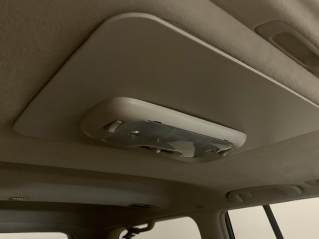

Update: Cover plate made from aluminum and I'm covering it w/headliner material, aftermarket wiring is out and just waiting for the terminal connector pins so I can finish up.
Done!
As usual, couldn't have done it without MUD and my neighbor. He made the aluminum plate, I bought the headliner material from JoAnnes, and @Kamran Khan put me in the right direction for the pins and wiring info. I wish the headliner fabric was a better match, but it is what it is. Maybe some day if a 3D printer vendor can print up a thin, matching panel I'll swap out the covers.
