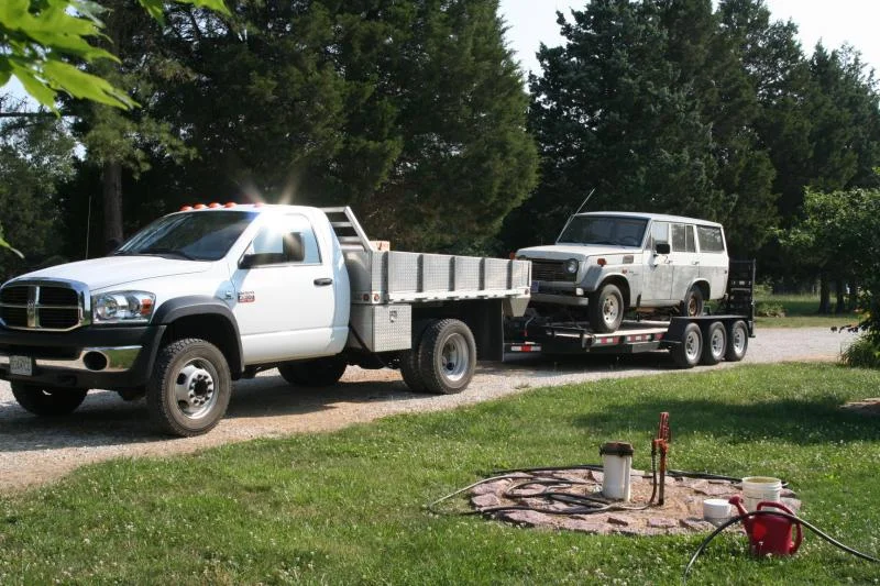

Here's mine a 5500. It's a rough ride, if you're not use to it. I upgraded from a one ton. It pulled that 55 all around the West. No problems.
We had to fly to Idaho, to buy it and drove home to Missouri with no bed on it. We could hardly talk, it was so bouncy. :)
