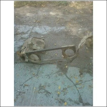

here is a picture of the remnants of my bib and fenders....we had to save the aprons but have new fenders and bib so this should look half decent....for now it will look like this with no front clip at all....gonna do some frame wirewheel and grinder action,rustproofing and rust oleum,plus gonna do my mini-truck PS conversion while i have everything stripped out of there...so it will be awhile....also tried a test fit of the windshield frame....anyone got a set of windshield frame screws...had to cut out all of mine....thanx guys
