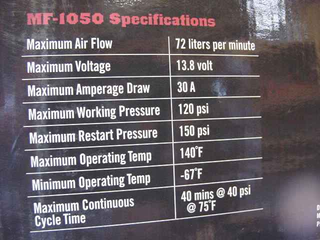

Anyone want to split a 4 pack of MASTERFLOW MF-1050 Portable Air Compressors (it is identical to the Superflow MV-50)??? 4 Case is going for $256.00 (+ $40 shipping to Point Roberts) on eBay, get one for yourself and a gift for someone else.
I just want one, and can not currently get the higher priced air system thanks to creating a hole in my fuel tank with a pressure washer... long story :doh:
Dual cylinder/piston for 4x4 applications
12V unit with gauge
Alligator clip connection
Storage bag with accessories included
Max. 150 PSI
SPECIFICATIONS:
Motor: 12-Volt DC
Fuse: 30 Amps
Maximum working pressure: 120 psi
Maximum re-start pressure: 150 psi
Maximum recommended continuous operating time: 40 minutes
Recommended on/off cycle time: 15/30 minutes
Quick review here compared to the QuickAir2 (click on the pic below)
The single unit on eBay goes for $96 USD after shipping, and this 4 pack broken down has a cost of about $74 USD for one unit.
