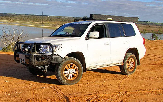

Hello! here is the picture of the wheel i installed! Enjoy!:)
Hi. Looks AWESOME !
Can you do me a favor please....check/measure/photograph the gap between your upper control arm and tire. With this wheel (if it is the 18"x9.5" ET55), the gap behind top of front tires may be very tight so I am curious.
Thank you.
Hi. Looks AWESOME !
Thank you.
Unfortunately, I sold the wheels already and put back the stock 17" wheel with 285-70-17 BFG. :bang:
But don't you worry because the Volk TE37 was designed for LC's so rest assure that there will be no problem on it.
