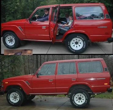

a couple action photos from the weekend testing out the new suspension and 33s. worked out very nicely. great ride on and off and I needed the extra clearance for some areas.

more stiff yes but rides better. much less roll around corners and better over bumps too.
