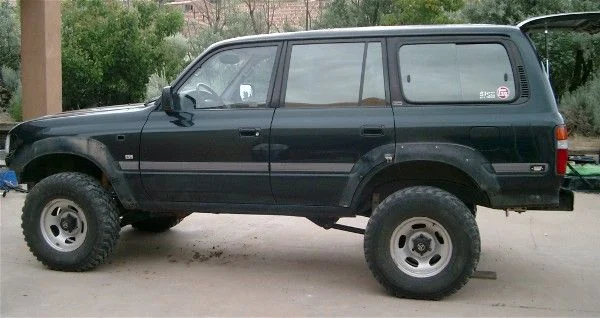

cruiser dan's rig on OMEJ + 1" spacer up front and 864 heavy rears on unloaded 80. You can see it's over the J height. you are talking about a taller spring and a little less spring rate...although still more than the J rate.
attachment.php
to quote GeoRoss here on mud:
The 864's I have are stiff. I am not sure I can detect much difference with 400-500lbs of gear in ride or stance (otherwise stock). I guess the ride is a little less rough, but only marginally. The back will 'jump' on abrupt speed bumps, loaded or not. They flex well. I can say that the stock springs that were on it would begin to sag with as little as 200 llbs.
The ride is very stiff, but I am used to driving trucks, so I am used to it. They do well on washboard roads once you find the right speed.
So considering you are close to that in spring rate, and unloaded your springs are going to ride taller and stiffer than what you have.
