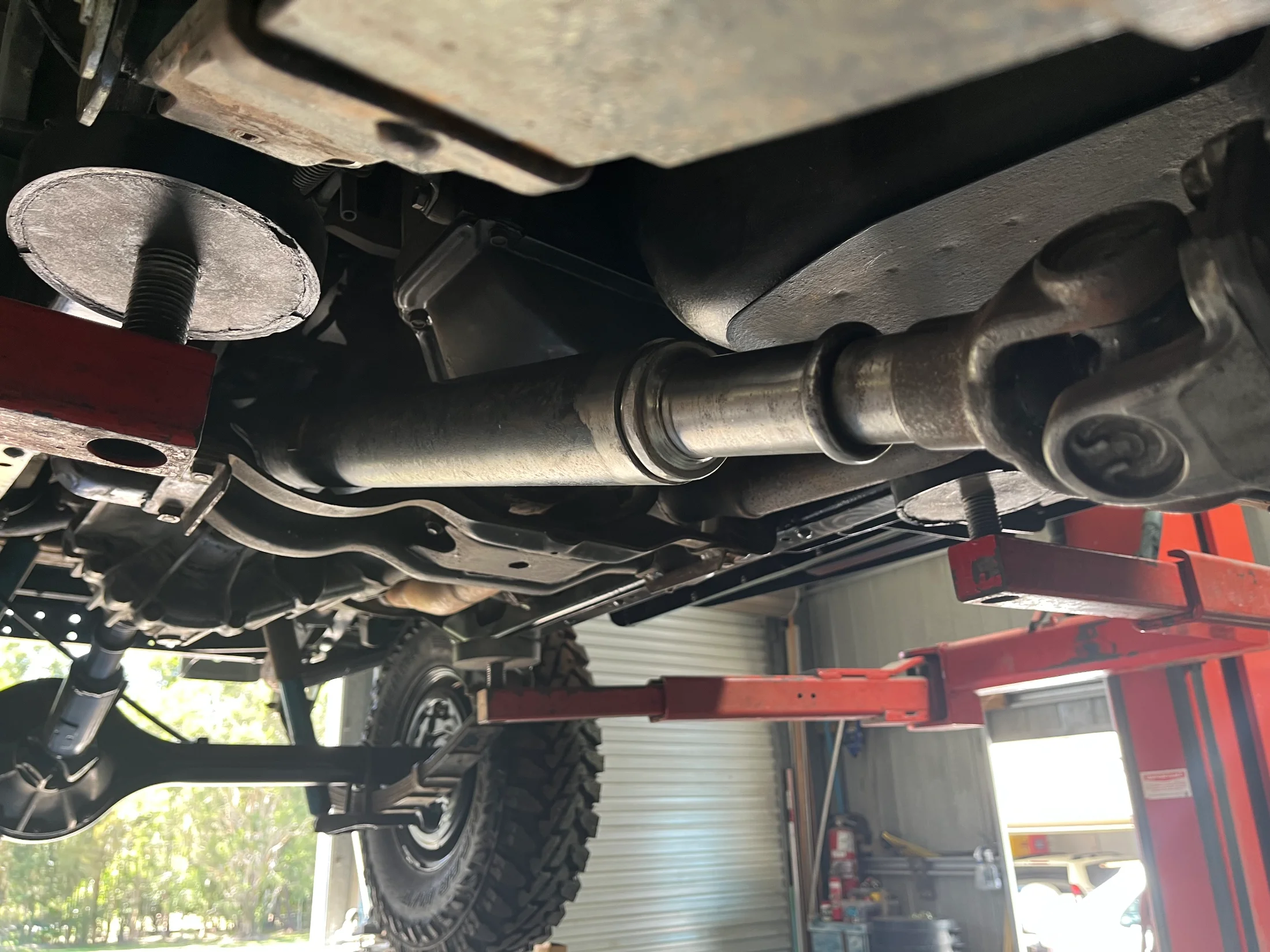

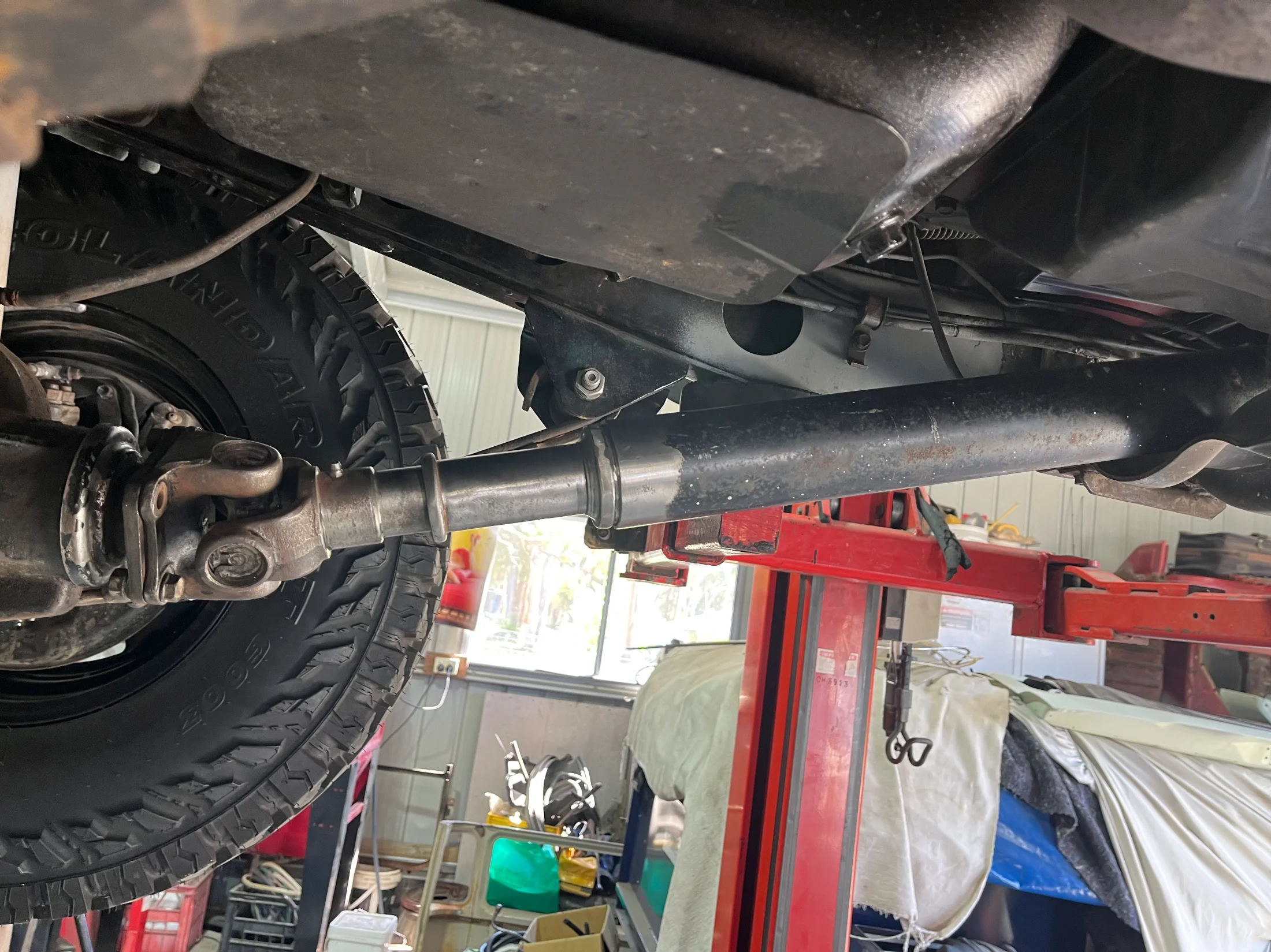

Measured up and made a front driveshaft from spare parts l had, got the run out to a nice minimum spec and burned it in. I am sure the speed of the old tractor will never be an issue for the shorty.
Looks good, missing a driveline bolt(?)
