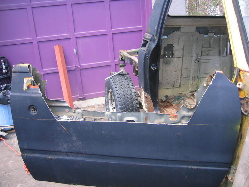

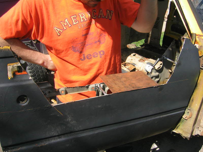

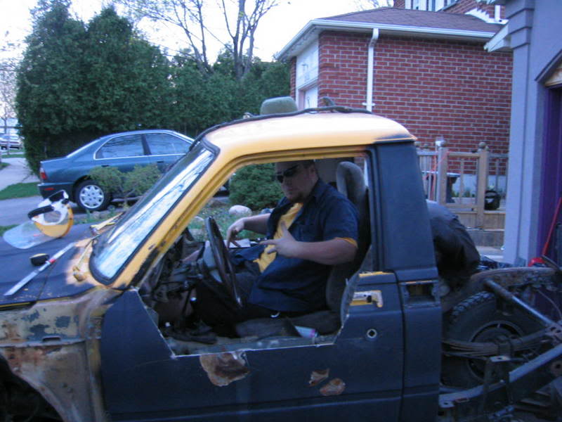

Half doors!

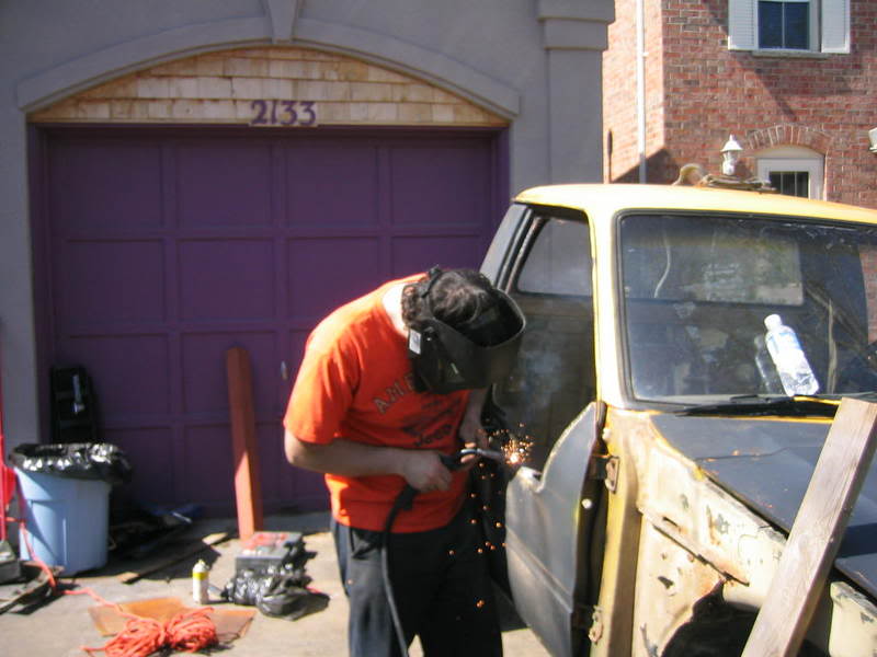

Grinder with cut off wheels made pretty quick work of it. I chopped up some 3/8" bar I had to make braces/stiffeners for inside the door and then started to plate it off.

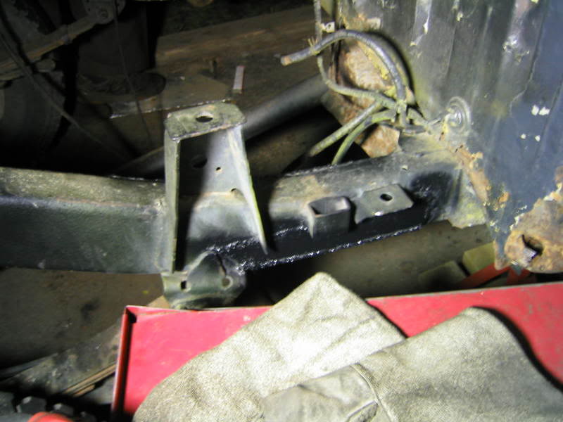

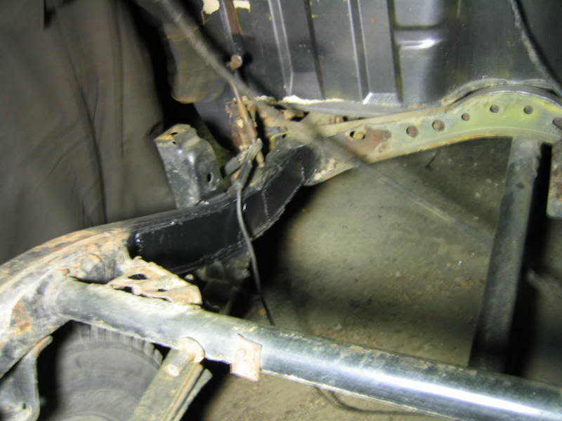

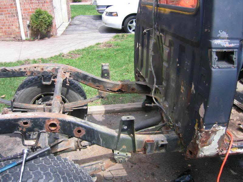

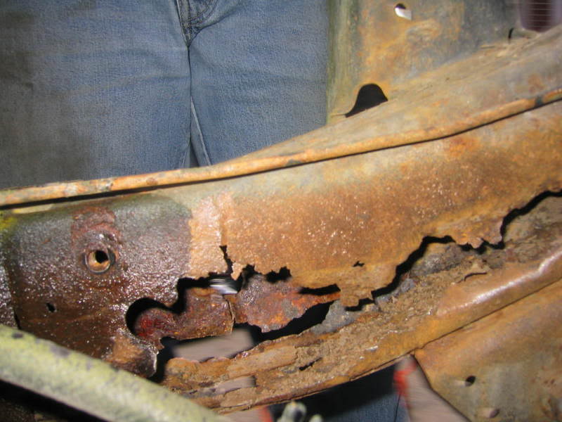

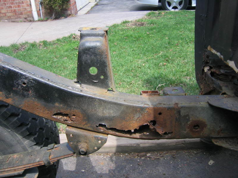

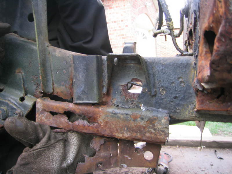

Here's what it looked like when we started.

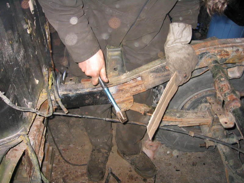

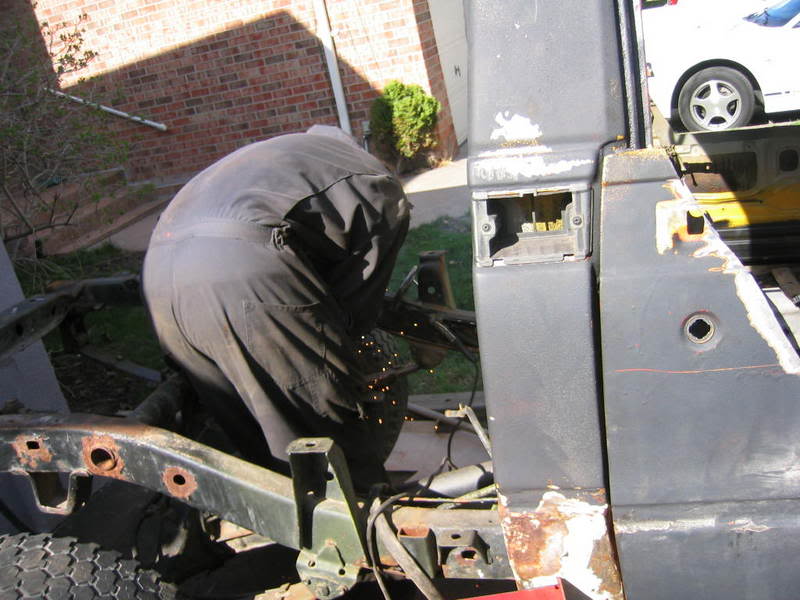

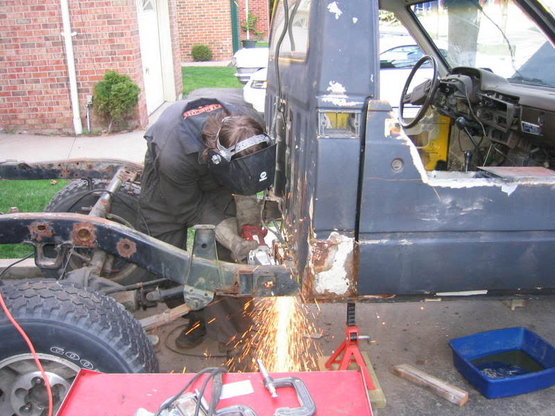

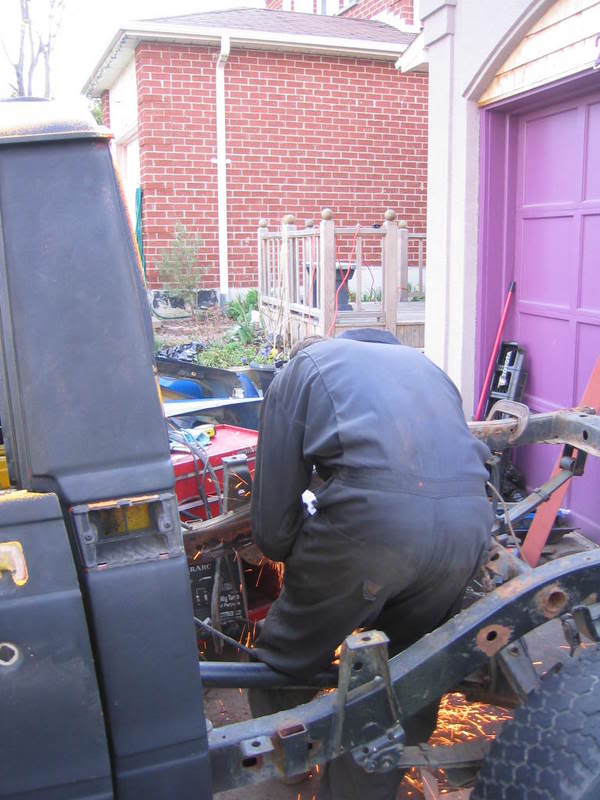

Then Dylan started cutting out the frame, we started with the driver's side.

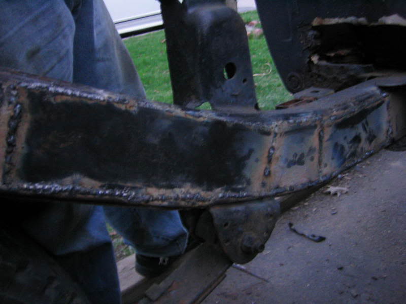

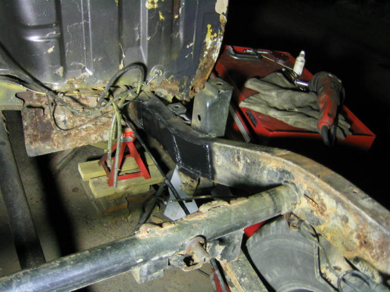

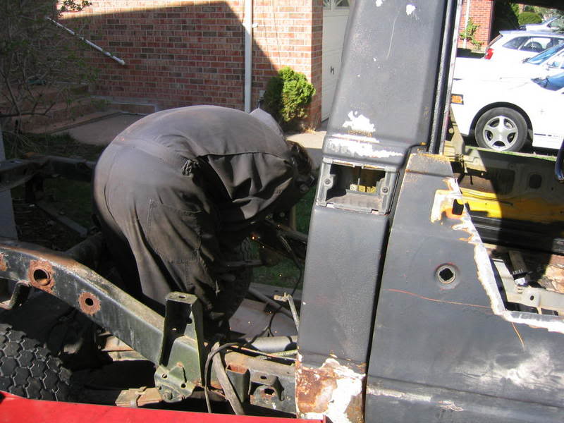

Patch panels were made and Dylan welded them in place. As a note, having breakers in your house that can handle a welder are nice. I kept tripping mine every few minutes and had to go reset thus ADDING time to the whole process.
BAM, finished! No more hole filled rusty frame.
Then we started on the passenger side.
We had to almost totally remake this section of the frame. The only orginal part left is the top and maybe a quater of the outside.

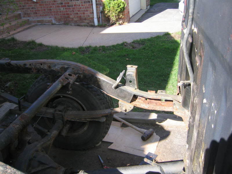

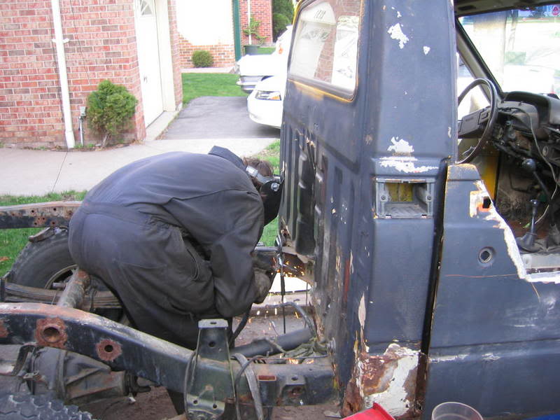

Back to work. Welding started.

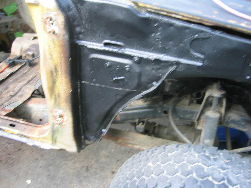

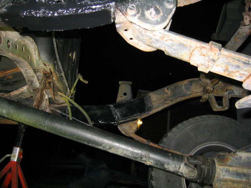

Now I stopped taking pictures for a bit because I was tired and simply forgot but here's the finished product with some black paint on it for now. I'll under coat it in the next week days.
Passenger side.
Driver side.

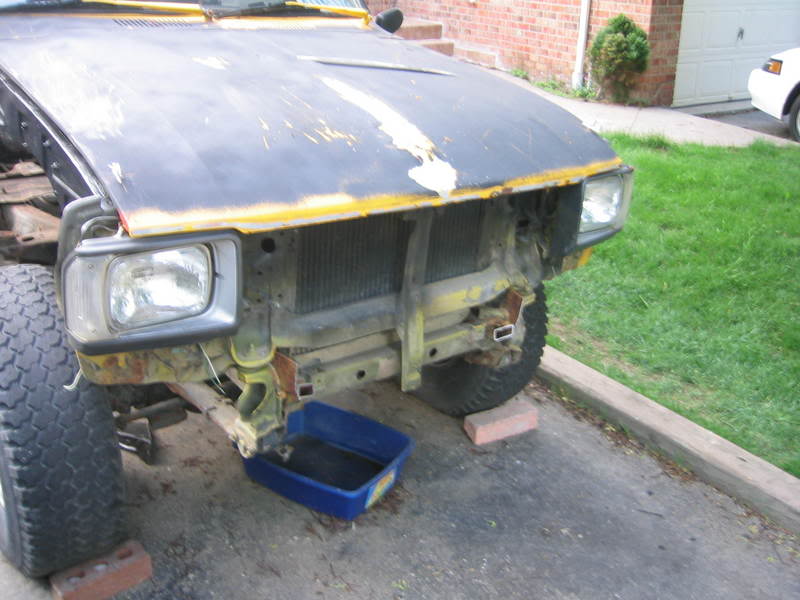

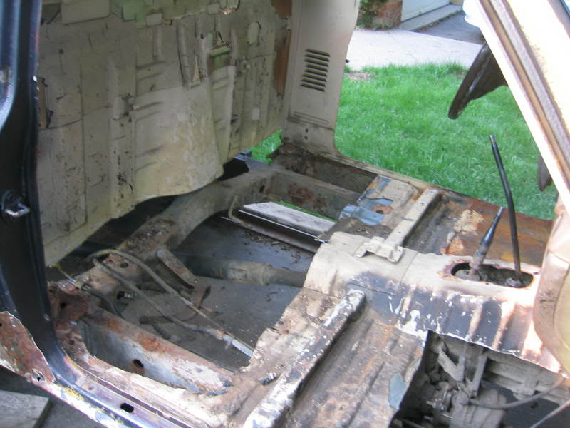

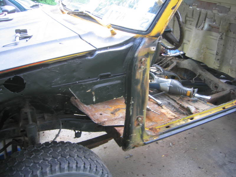

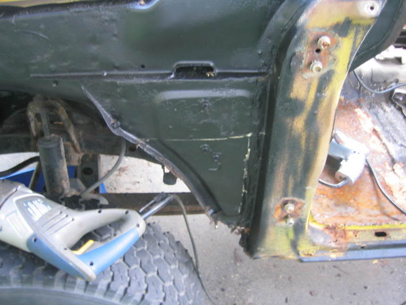

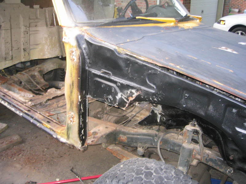

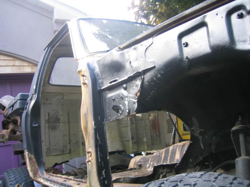

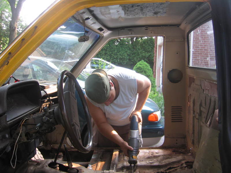

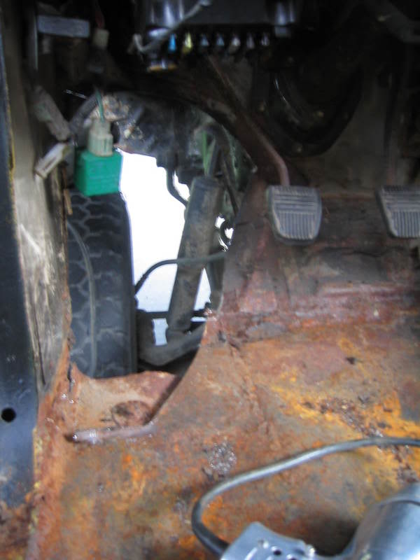

Did some more chopping on the Toyota today.
Finished cutting the floors out of it.

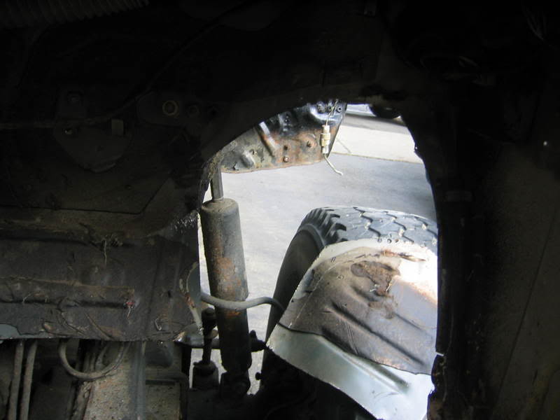

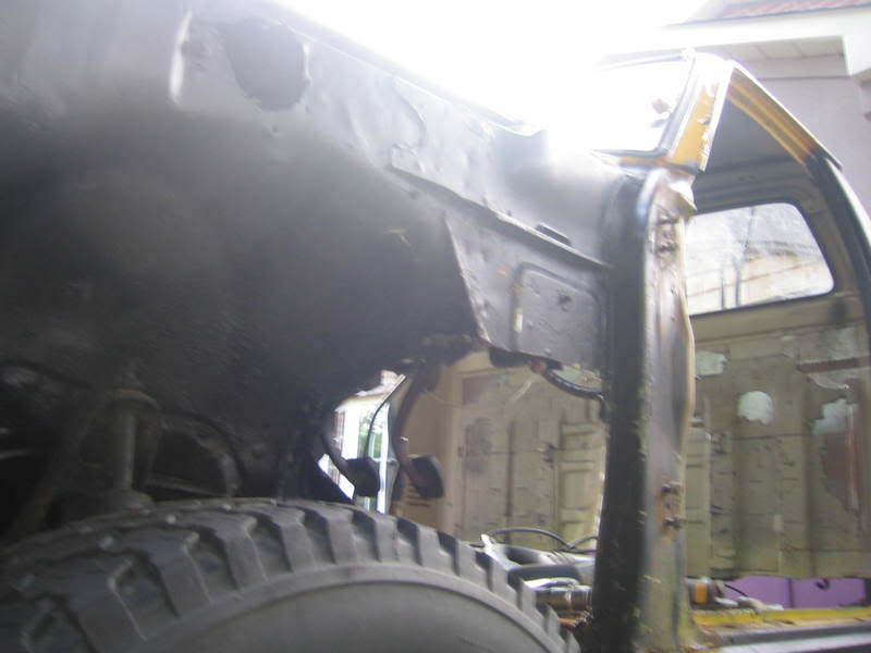

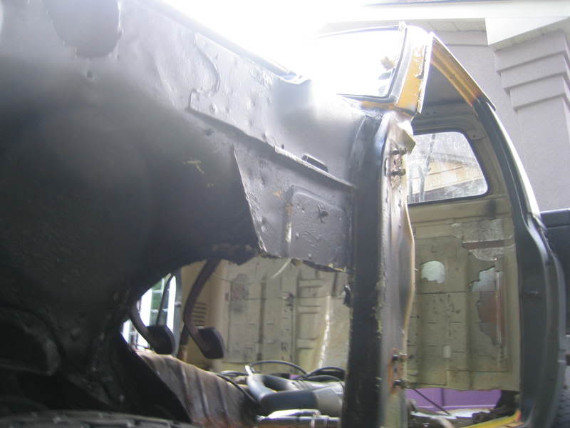

Plus I cut the fire wall so I can tub it for the tires.
I personally didn't think this was enough room. The wheel wells still looked a lil small to me so I stood back and looked at the truck.
:idea:
