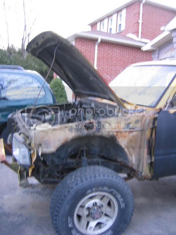

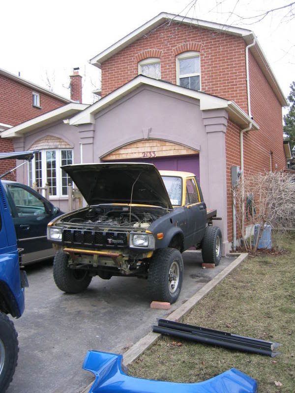

This weekend I picked up a new future trail rig. I won't lie that it needs some work but it's not that bad at all.

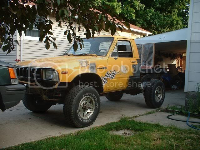

82 Toyota Hilux Short Bed, Regular Cab. 22R, 4spd and a top shift t-case, 4.30 gears.

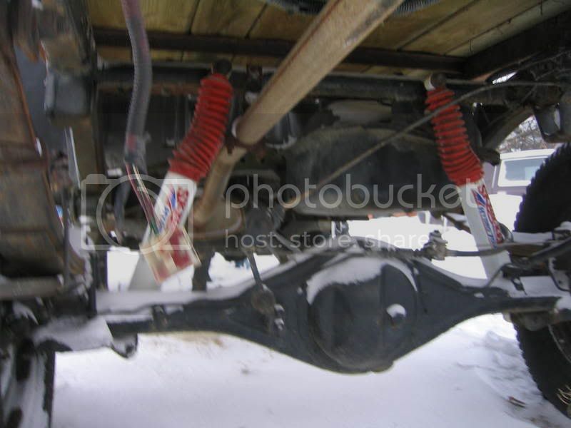

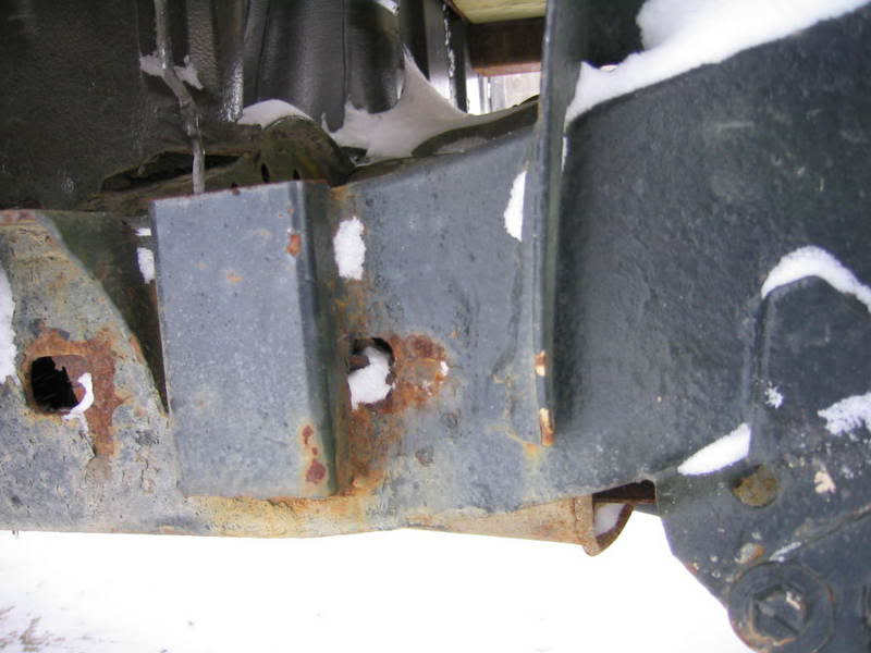

Here's the problems.

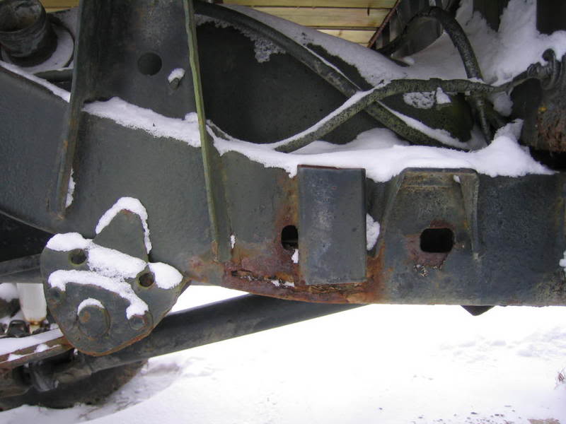

On the 25th it goes to my buddy's place to get the frame and body patched up and maybe set up the suspension, we'll see about that.

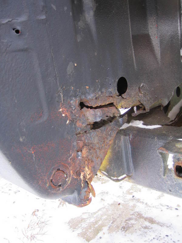

That is almost painful to look at. I have been wanting an early model mini and except for the frame, your looks really good.

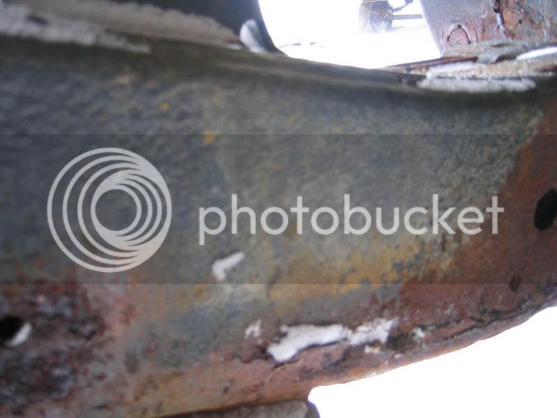

The frame really isn't that bad at all. It'll be fixed up soon too :)
you should leave it painted like that....its sick!! :D
It's actually black now, I need some updated pics of it.
nice truck. gotta love those salty roads. welcome aboard! if that rear has been lifted you should extend the LSPV rod

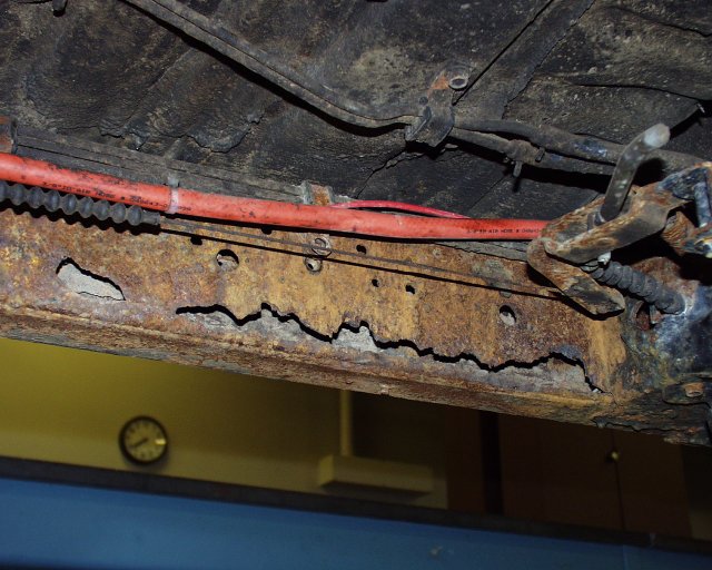

I remember saying that with my old '84 pickup. The rust was a lot less than that, so I figured "eh, I can fix that". I spent hours cutting and welding patches to the frame, it was a sucky job that I will never do again. Two years laters I was parting it out, I sawzalled the frame in half and took it to the scrap yard, before it collapsed on me.
Remember that rust like that is like an iceberg, you are really only seeing about 10-20% of the real damage now. One you start picking and grinding at it, it's gonna get ugly. I had a small spot on the inside of the pass side rail, so I took it into the shop and started digging out the crap. Here's what I had to patch when I was done:
Good luck, I'd start looking for another frame if I were you.

LSPV rod?
I don't think the rear is lifted. It's just Skyjacker shocks.

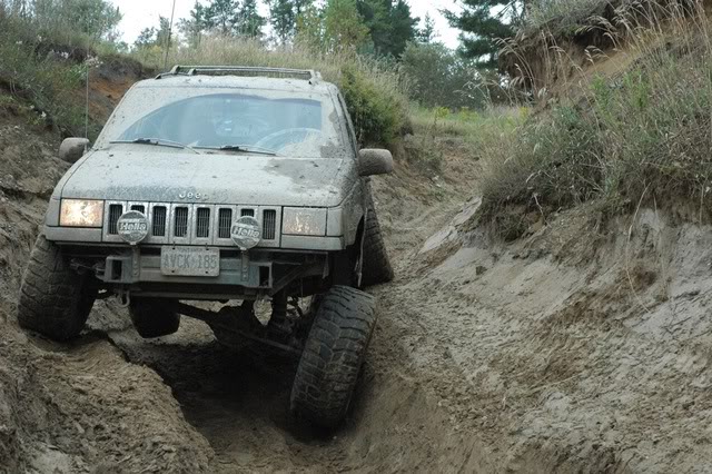

That's not my Grand, it's my buddy's who I bought the truck off. My Grand on the other hand, I blew the motor a few months back and I'm just finishing parting it out. Here's a pic just because:

Ouch, I used a hammer and screw driver on the frame no other problems that I noticed.
We'll see when I tear into it.

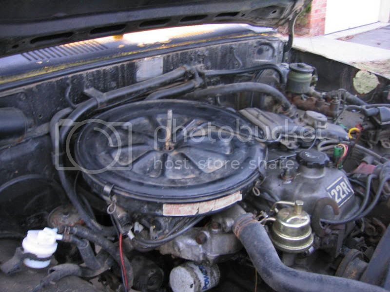

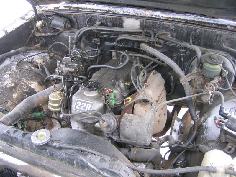

Did some work on cleaning some of the parts up.

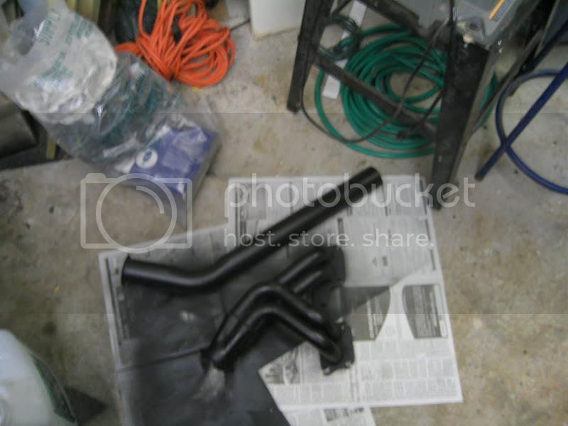

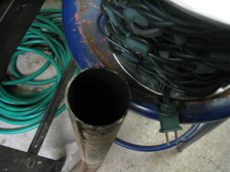

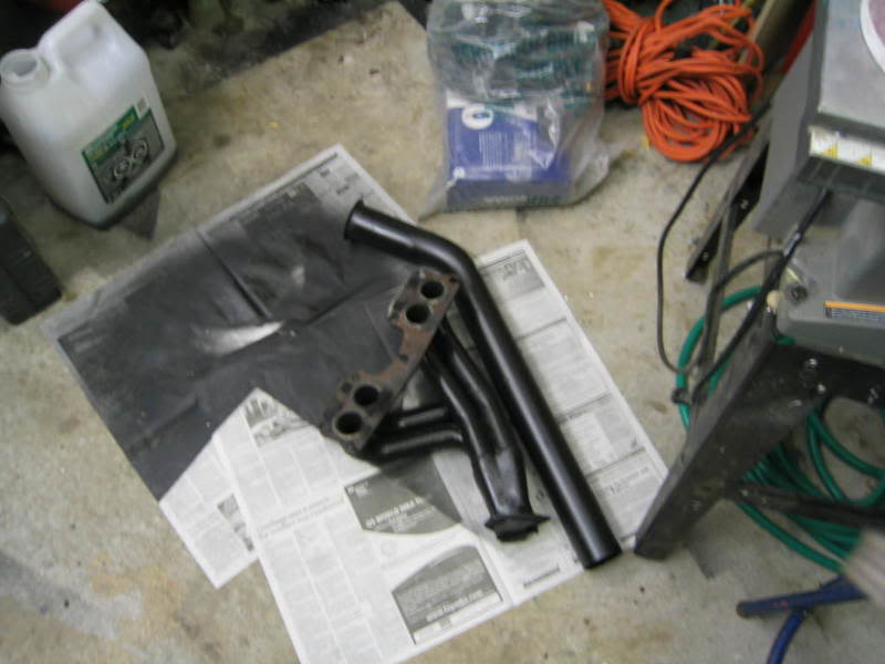

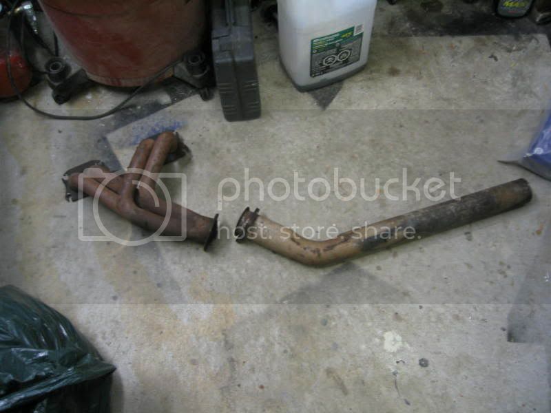

Painted the header up. The outlet looks HUGE!

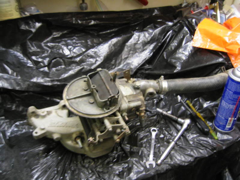

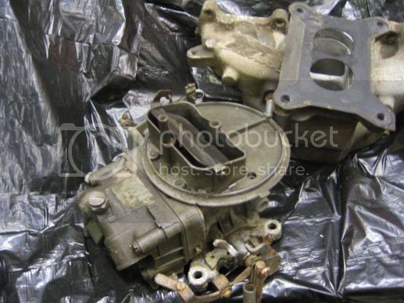

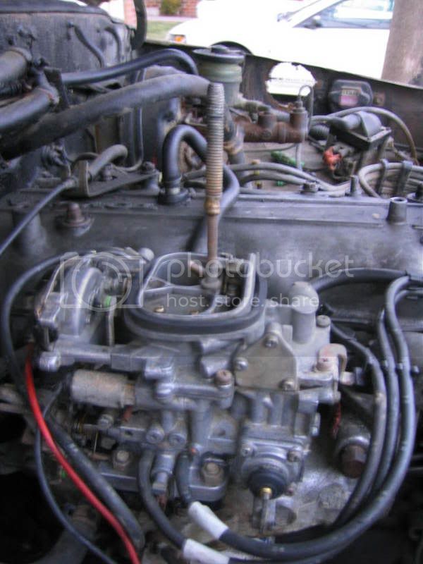

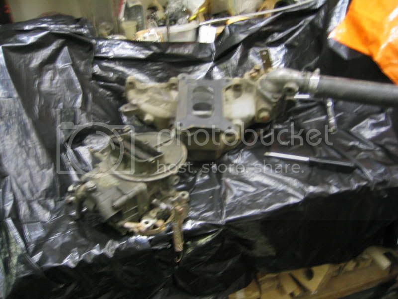

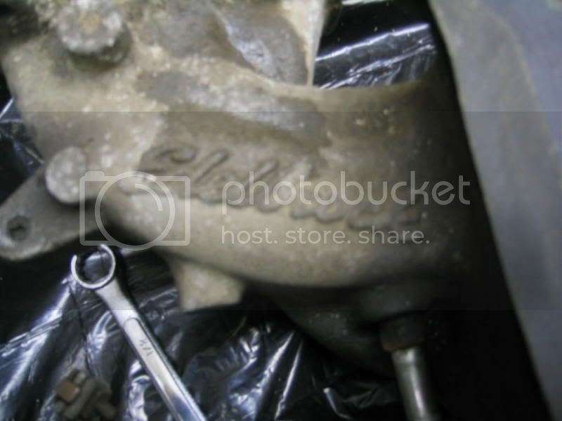

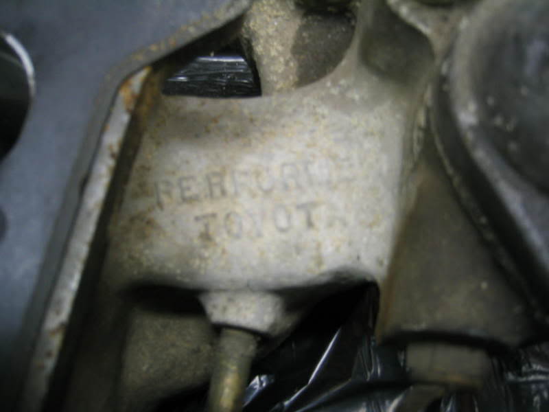

Cleaned up the manifold and carb.
The manifold is an Edelbrock Performer, I think it's OLD because Edelbrock no longer makes it.

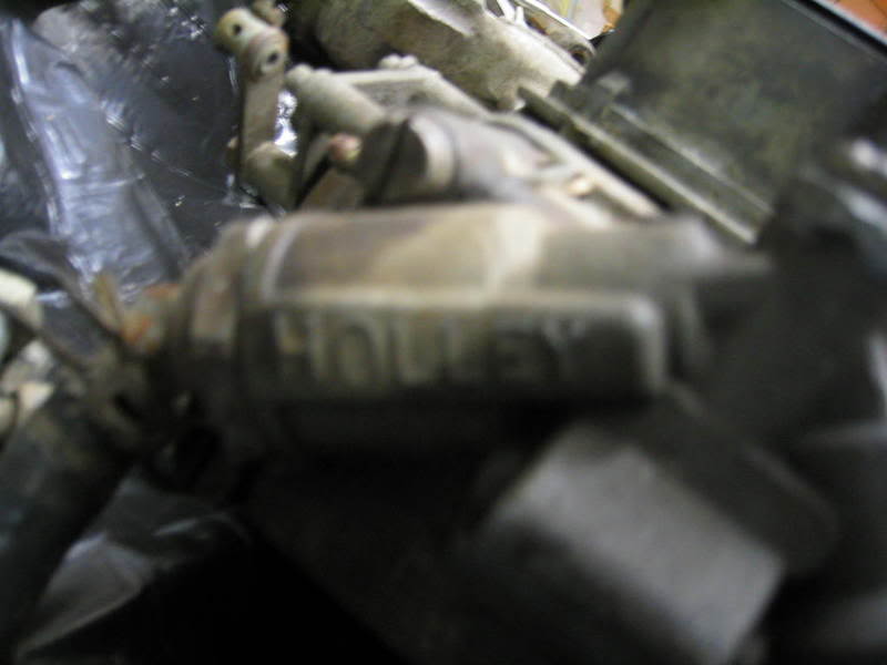

The carb is a Holley, again old!

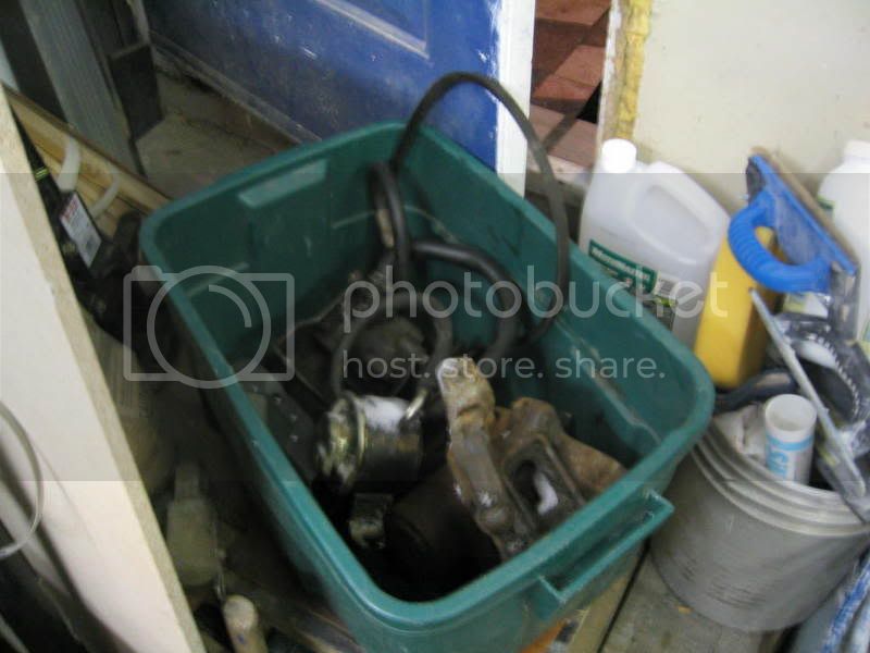

The power steering set up.

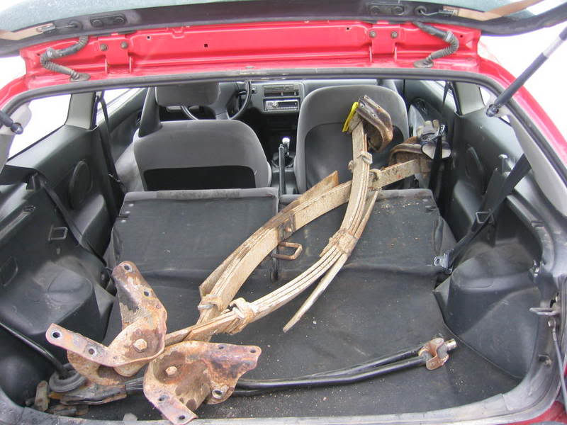

63" Chevys BARELY fit into a Civic Hatchback but I got them there.

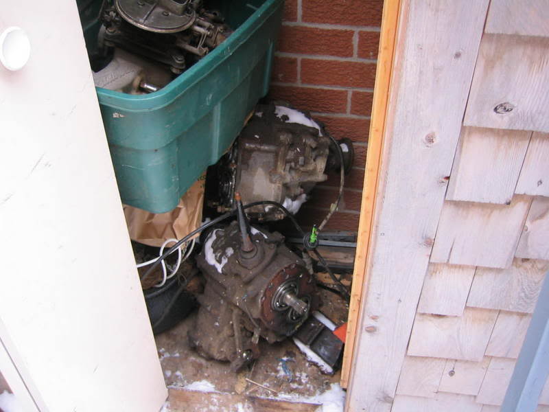

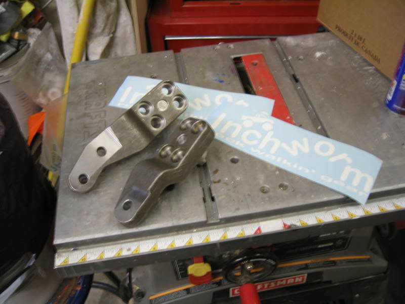

Got my 2nd case for dual (got a deal on a bunch of stuff case included, won't do duals till next year). The top case is for a friend's Sammy.

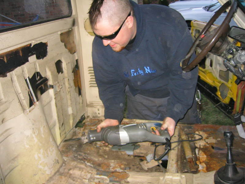

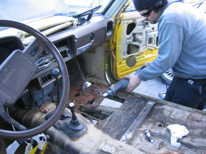

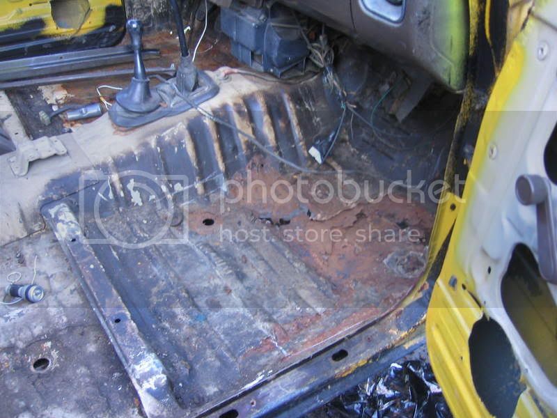

Paintrf my steering arms and clean all the crap out of my interior. Then I helped my buddy work on his Jeep so I never got crap done on my truck.
Then about two weeks later when it warmed up again (fxxxing Canada) I did a lil more.

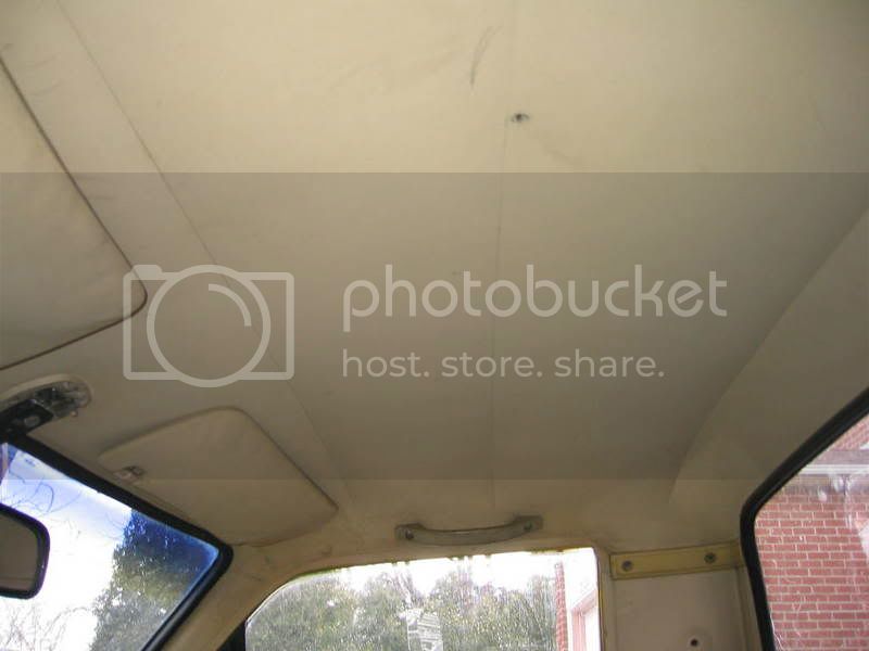

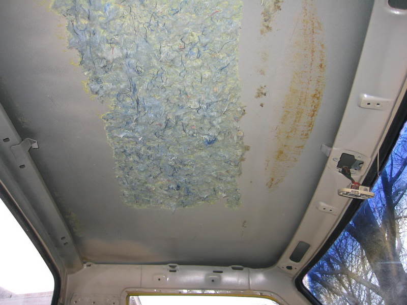

Nasty vynil, we don't need no stinking headliner!
I still need to get rid of the left over fluff s*** but I was loosing sun light and it started to rain so called it a night. I've got Friday and Monday off for Easter so I'll use that to get some work done.

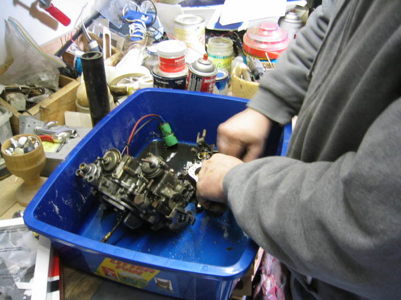

Had my buddy Andy rebuild the carb for the truck. He's been rebuilding motorcycle carbs for years so why not have someone with the knowledge do it.
All done and on the truck with the air cleaner too.

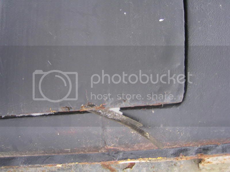

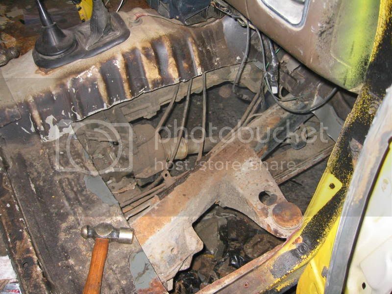

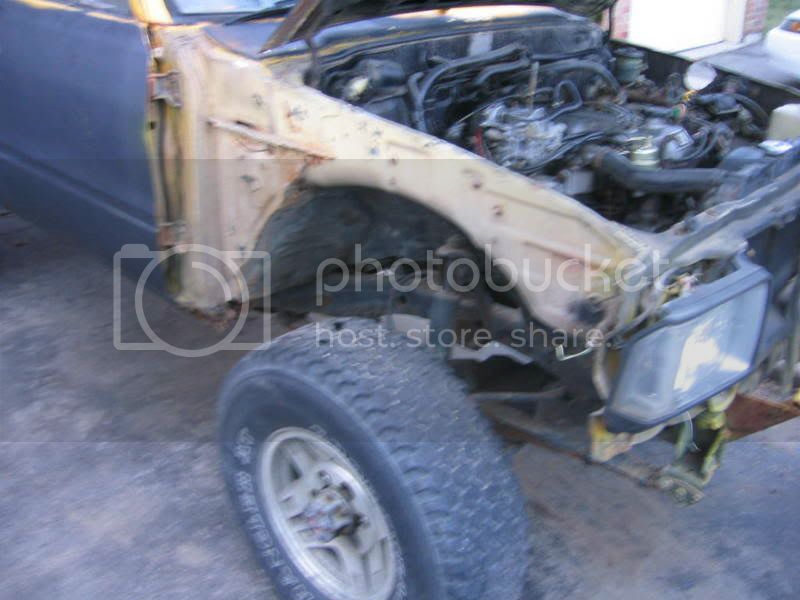

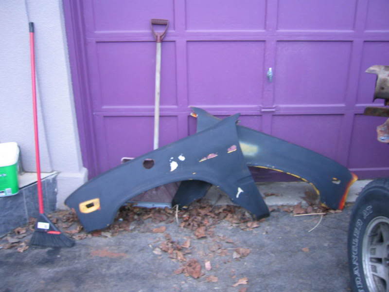

I also popped the fenders off too so I can do some body and paint work. Found out that the passenger side rocker is toast. I'm thinking I'll just cut both rockers out and weld some box plate in their place instead.

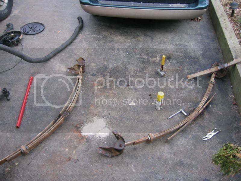

I tried to completely disassyemble the Chevy leafs so I could paint them and replace the bushings, didn't go as planned. Bolts are seized in both bushings on bolt leafs. Tried to beat and torch them out to no avail. I will try air tools on them and see if that works. Couldn't get the center pin out of one, it's spinning in the leaf so I'll have to work on getting it out.
So once they are apart I will paint them all up and replace what I need too. I also want to put some UHMW-PE(Ultra High Molecular Weight - PolyEthylene) between the leafs.
