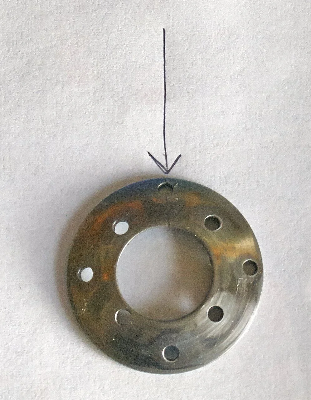

Had a chance today to pull the spider gears to take a look at the condition of the gears and the shaft, all looked real good other than one of the spider gears bearing washers has a crack in it :doh: as seen in the picture. I have no clue how that happened but will need to replace it, anyone have a spare you maybe willing to sell?
Got the date set with that 15 year diff pro on Saturday, so we will know if more is needed other than a pinion bearing replacement. If it all passes but maybe a 50/50 on the spiders I can at least get the R & P setup and install a locker when funds are available. PM sent to RustyNailJustin.
Thanks guys
You will not need one if going with a locker.
He will if he's installing a lunch box locker. Unless they started sending them with thrust washers. It has been a long time since I have used one of those.
