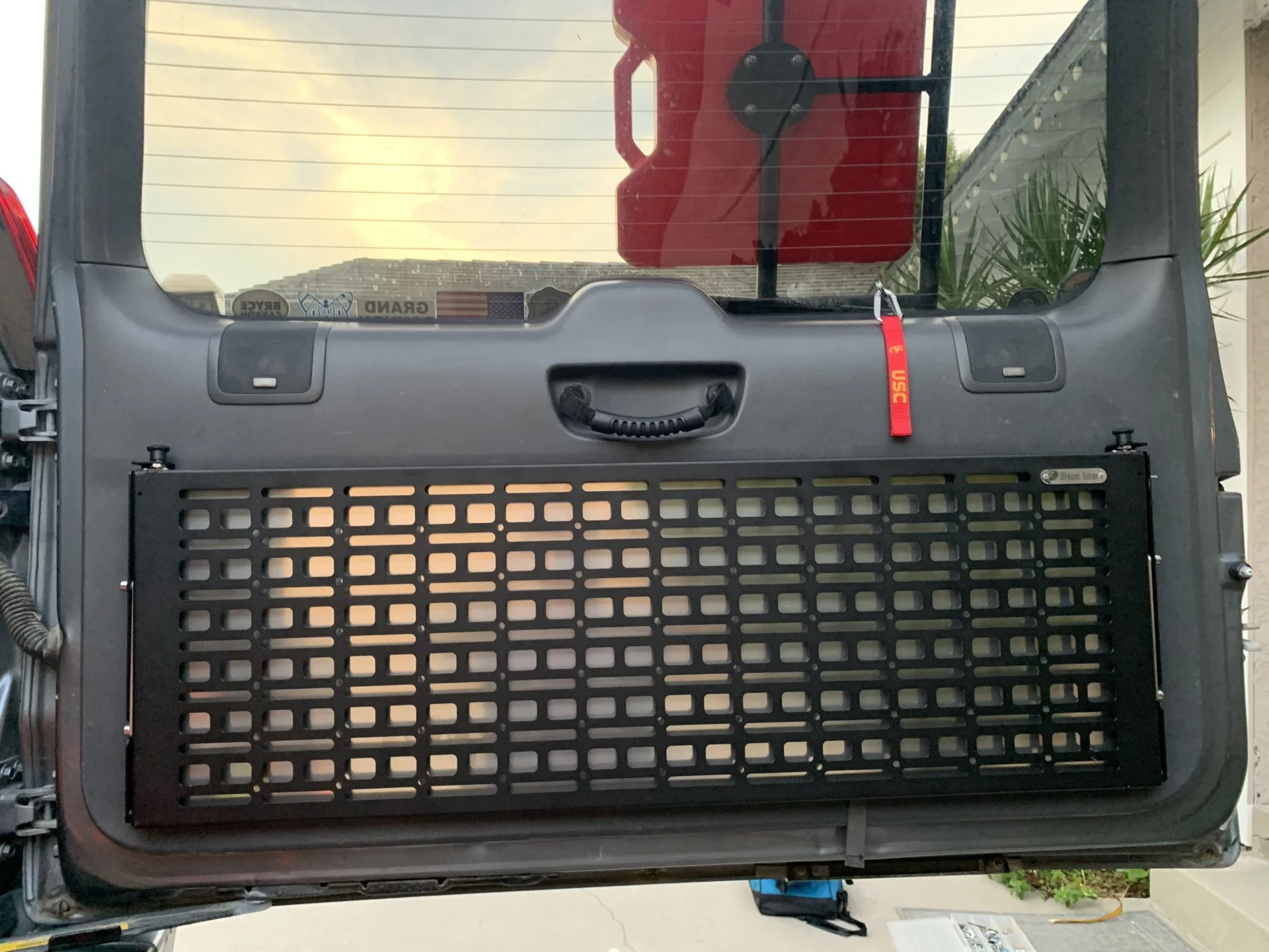

I got the Bison Gear Drop Down Tailgate Table installed on my GX and it is awesome! I am loving this upgrade and the functionality it adds to the rear cargo area. Check out the video below.

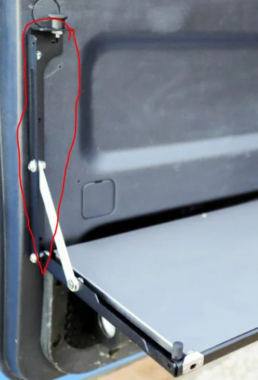

For installation, after doing it I thought of this idea that may be helpful. In the folded position get the table lined up just like you want (not covering your tool kit like I did), then put some double sided tape on the back side of the portion with the holes (circled in red) to put bolts in to hold everything in place so when you open the table to drill the holes nothing moves. Just an idea! Hopefully that makes sense.
That’s a good tip…I ordered the larger table so I should be able to align the curves in the bracket with the curves in the panel and not block the tool kit opening.

Update: my bison gear showed up at my door step in exactly a week from when I ordered. Installed the ceiling shelf and drop down table in a couple of hours. Baja here I come.
And I used the double sided tape idea to hold the brackets in place. They move when you unfold the table so you need to hold them in place to drill the holes in the right place. My double sided tape was weak and it don’t work on one side but it did work on the other side.

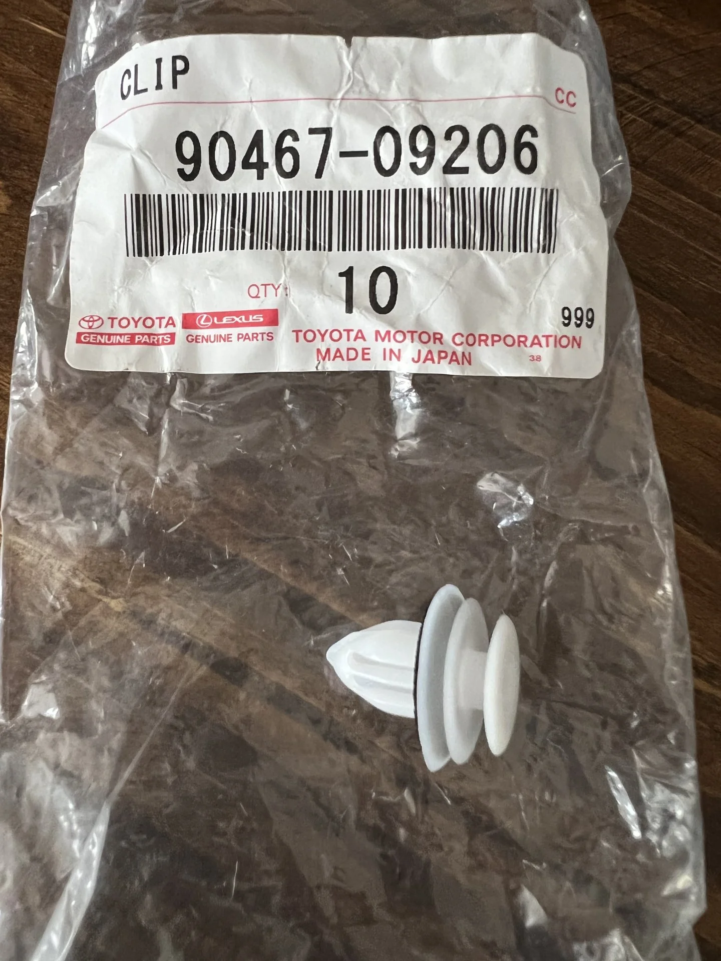

2) most of my stock oem white plastic clips (90467-09206) that hold the barn door panel in place were in bad shape and they didn’t hold the panel well after the table was added.
Both are minor issues and relatively inexpensive to fix. I got a little bag of bolts and nuts at Home Depot for like $2.50 and ordered 10 toyota clips for like $0.65 each.
Both minor problems are fixed. I didn’t reach out to bison gear on the missing bolts nor on my need to replace all 9 plastic clips (those are almost 20 years of age on mine).
