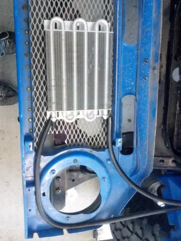

Wise choice! The plastic pins through the rad core will wear through the thin copper tubes especially when they get normal road grit on them. Takes a while but it will happen!
Argh! I hate caveats! I might just make a frame for it then....
2 pieces of aluminum angle stock spanning from the sides of the rad support are very easy to whip out, are very strong and look super clean!

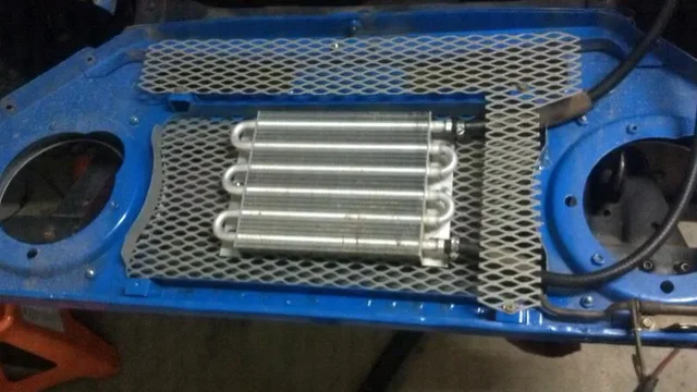

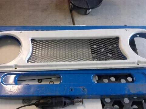

Yeah, I have the Winch, bib and cooler off now. I'm going to pick up some Aluminium <sp> tomorrow and get to work :grinpimp:
Cooler swing out bib.

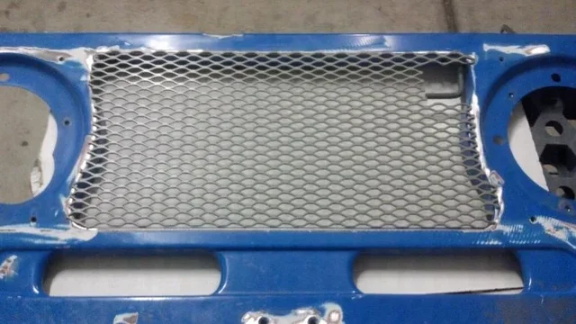

Cleanup and ready to tack down, then touch it up.
I think this will do. Need to do some off road testing. ;)

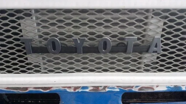

Its looking great. Bob does great work.

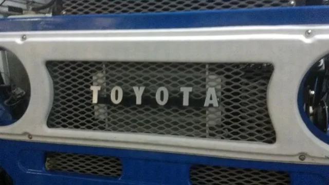

Cooler has been great so far. No issues on two trail runs, with no leaks or looseness. Shock tower 1 is on and ready for a longer damper. It is a narrow fit fit with room for cleaning on both sides of tower. I will check flex on next run to get a range of motion measurement since I don't have a forklift handy. :D
