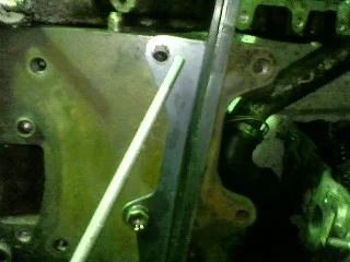

heres my kit,
a band saw or grinder is needed to trim down the guide to fit behind the cover, I had my 1st one done at a machine shop(cost me $15). Don't know yet if heat will mess up the glue from the rubber but it shouldn't encounter more heat than sitting in a engine all day.
I did not have to grind down the top of the tab shown in pic 1 the HG should give you enough room. The dozens of times I've held that 20R guide to a 22RE block its been able to go in place.
20R guides (not any news) will not fit behind a 22RE timing cover without modification.

You want the kit with the steel guide. $57 to your door, you'd probably have it in a couple of days. I've used this kit a couple of times, it works well, although truthfully I didn't like the timing cover gaskets and the front main seal that came with it, I tossed them and got OEM.
This is important stuff, don't be cheap to save a few bucks. You may be sorry later. When I did my engine a couple of years ago, I bought OEM chain, sprockets, tensioner, and gaskets, but I got a set of DOA guides. I also installed an engnbldr "turbo" oil pump, but unfortunately he doesn't sell them anymore. I had horrible chain rattle before, but it's totally quiet now.
all the pics I've seen look like they are cut downs to, I thought they were full custom? :confused:
anyone got any pics?
(look$ like I'll be cut'n my own guides, that I can get in the same day)
