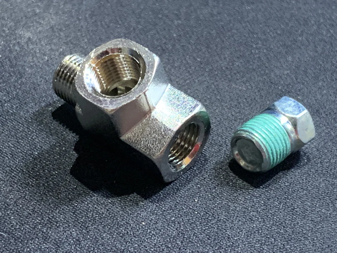

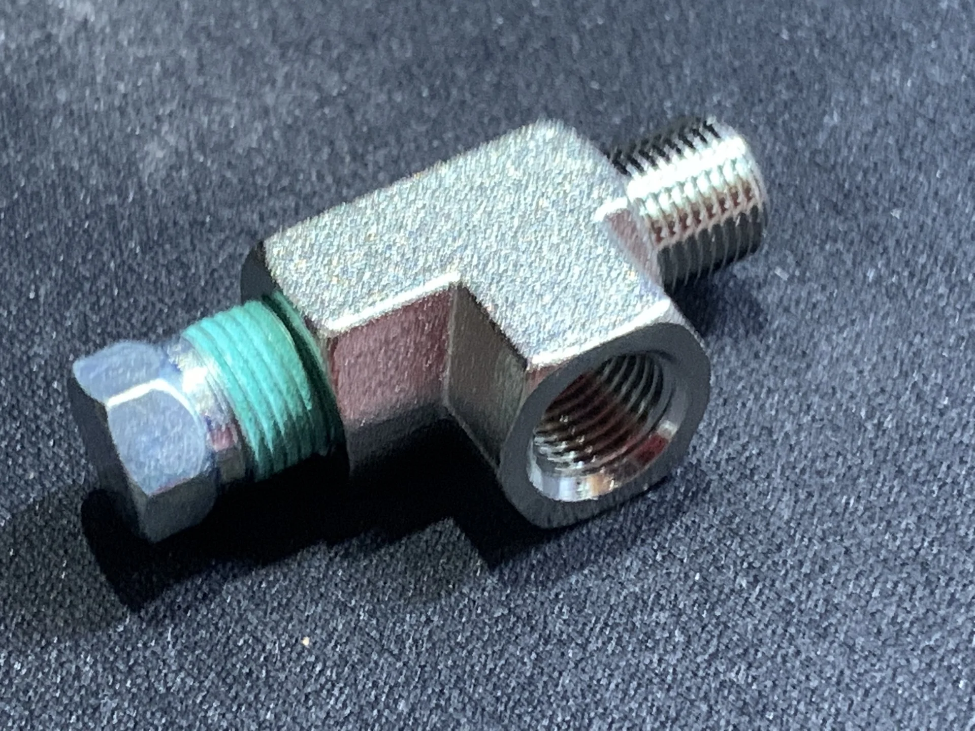

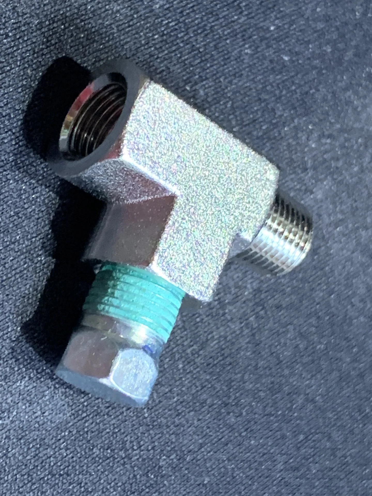

@ToyotaMatt what are the dimensions on this?
Curious if male end is inserted in stock location for 1HZ sender will the stock sender then fit in the "straight through" female end without hitting the starter, leaving the 90 port to feed oil to an added turbo?

ALL Male and Female Threads , are TOYOTA JIS Pipe Taper .....
i have only ever seen 1 single TOYOTA Vehicle anything platform engine Mechanical and or Idiot Light Oil Pressure Sending
unit MALE Device Side Pipe Taper Threads , and that particular TOYOTA Engines FEMALE Oil Galley Threads also
- i have also , reproduce coutless DIESEL Land Cruiser Engine Wire No.4 's in my land cruiser life time that have a unique 2 Sender Sensor Buddy-System of sorts , 1 bell sensor , 1 smaller Idiot light sender
- all have the same threads as my SOLID BRASS , Nickel Alloy Plated kit above ...
does this better help your questions above ?
let me know ?

@ToyotaMatt - plenty of details in your reply but was just asking about that part's size. Would (or does) it space a stock 1hz sender away from the block too far that the sender would hit the starter motor?
ToyotaMatt
the LENGTH it adds is LESS the 24mm / 1"
