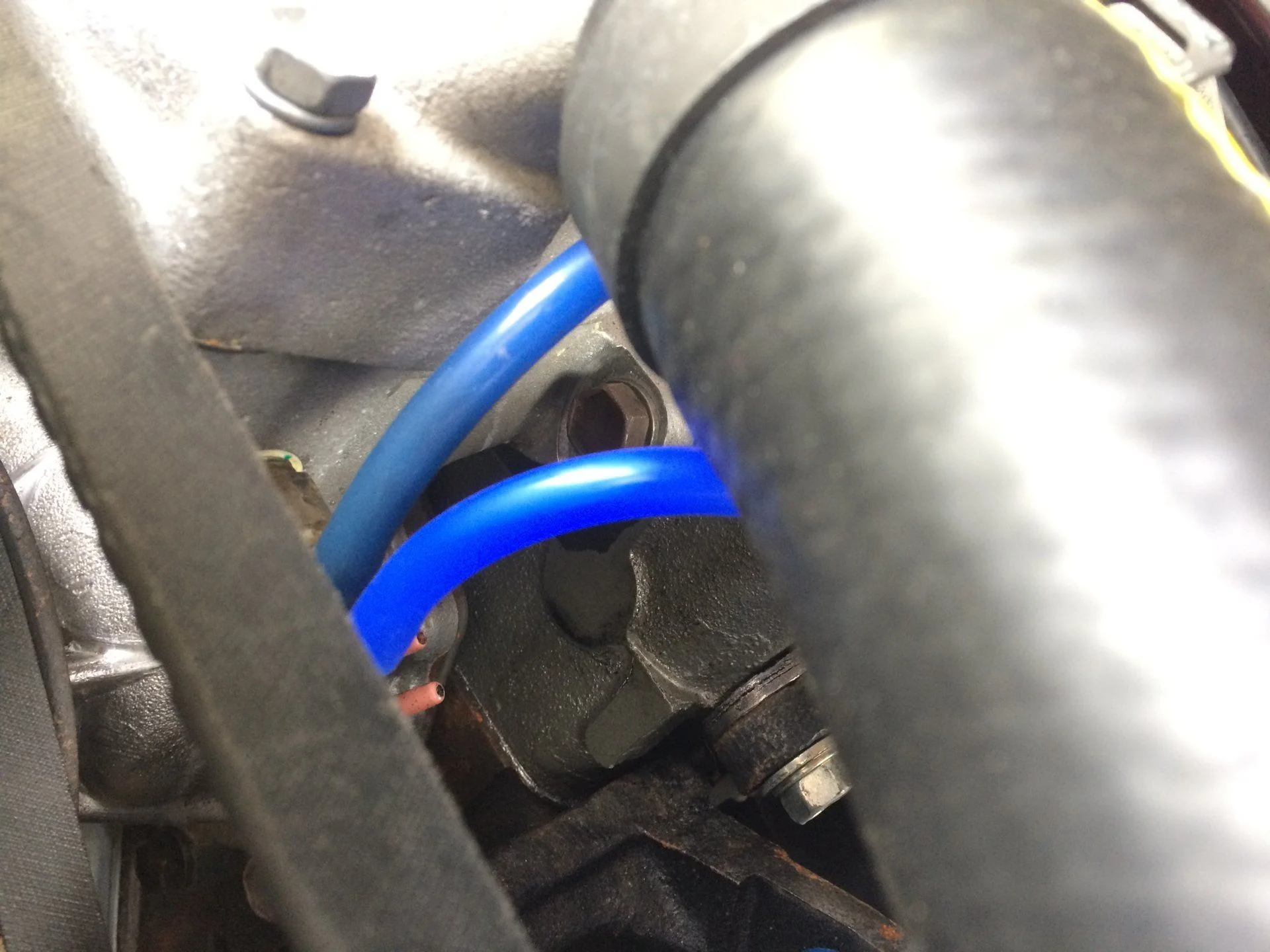

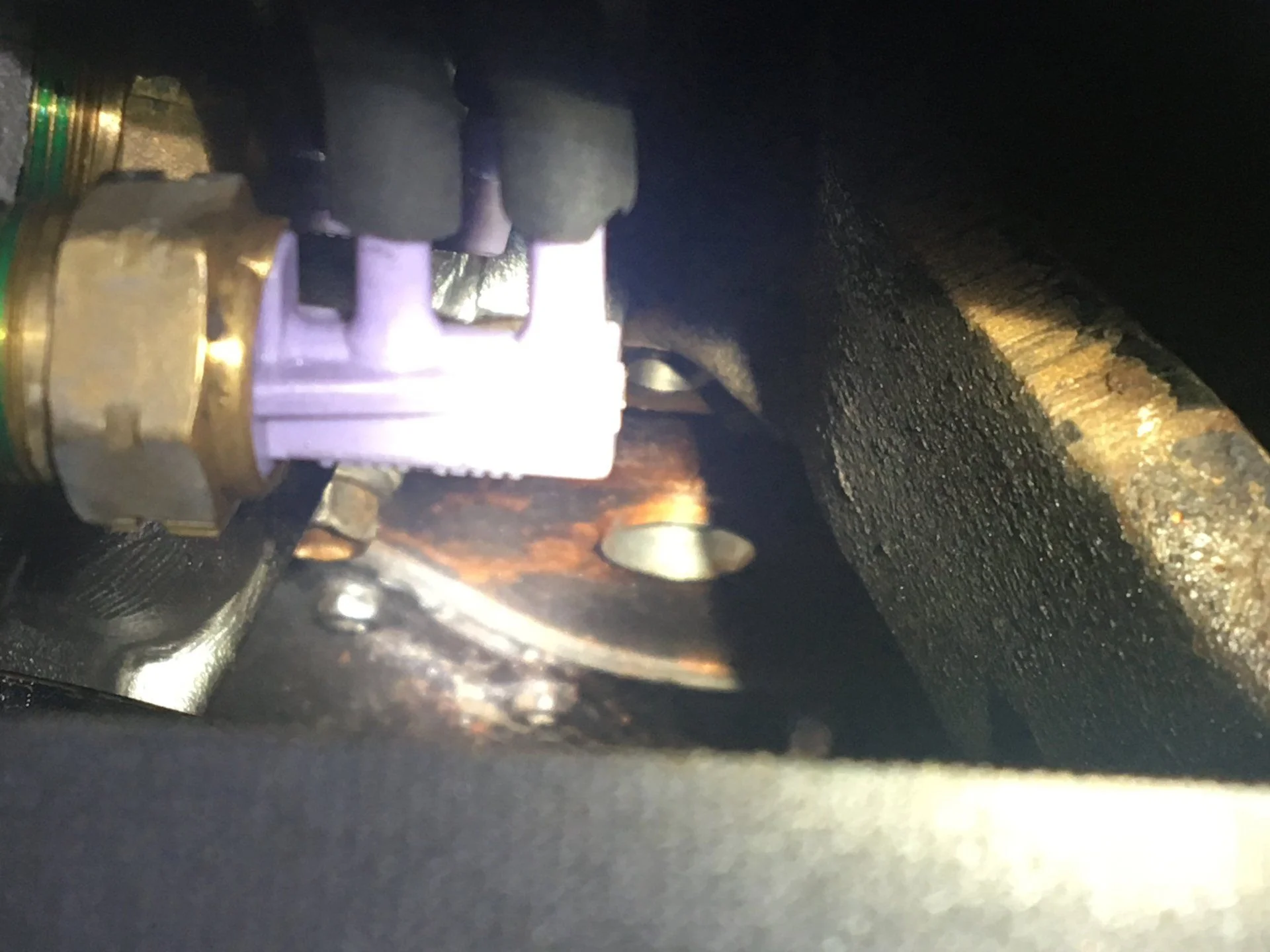

I have been reading up on the Oil Galley plug and looked for mine around the spark plugs from all the pics that are posted. I do not find one anywhere on my engine around the spark plugs and am wondering if on some models it was relocated to the front of the engine. This plug is about the size of a dime. Lucky I caught it quickly, but I am wondering now if I should get the hole threaded and fixed as described for the oil galley plug fix???

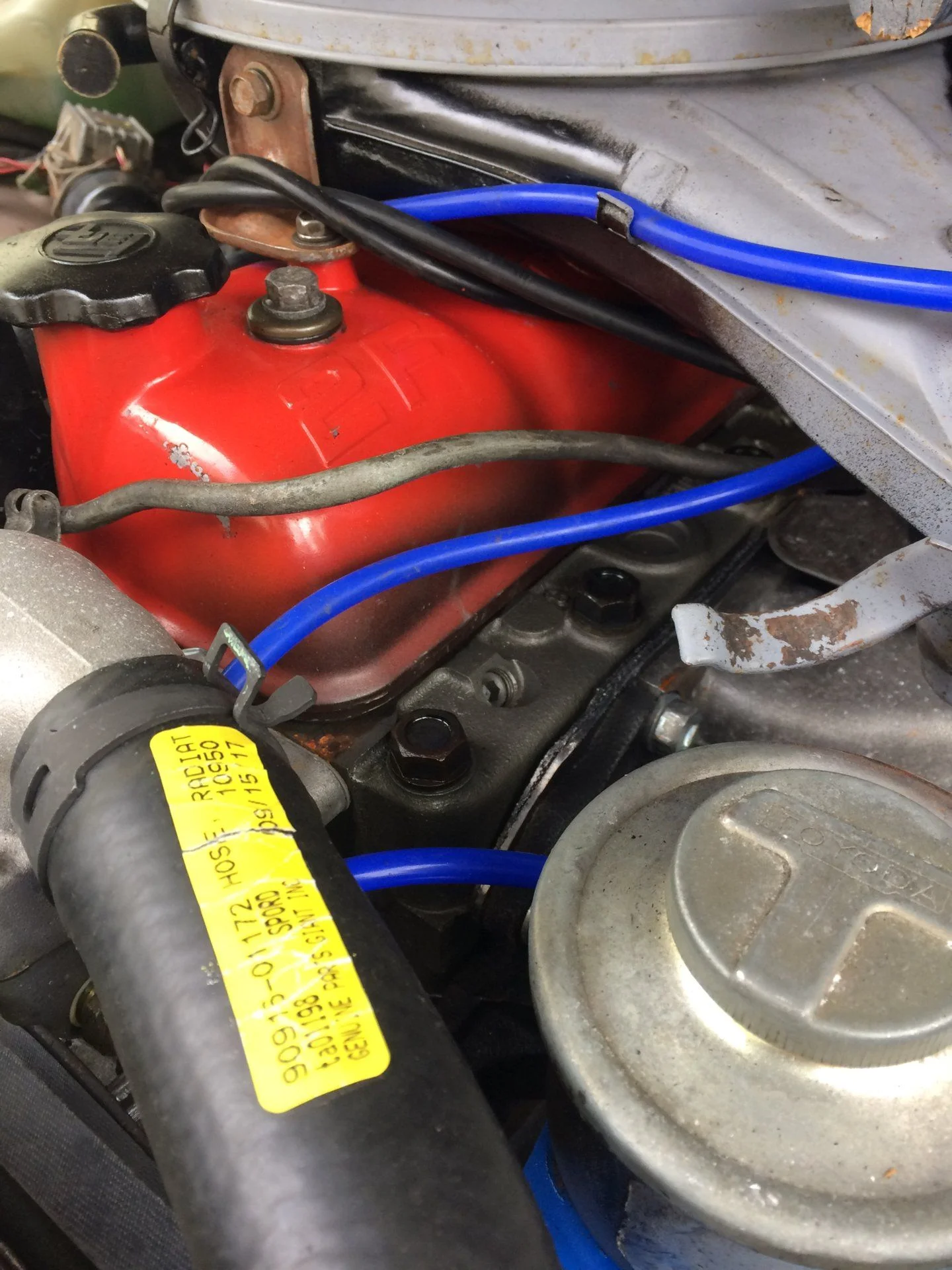

Thanks....I have read a almost all of these but have not seen a plug in the front, only by the spark plugs. I cannot find a plug anywhere near a spark plug...only this one in the front of the block and it is much bigger...about the size of a dime.

the oil gallery plug. The hole you depict in the photo, judging by it's proximity to
BVSV#1 and BVSV #2 (the blue and purple sensors w/ 2 vacuum lines each)
looks like a head bolt hole and should have a bolt holding the head to the block there.
Call me crazy but it looks like a head bolt is missing.

And what’s in the spot I circled in red. Looks almost like a slotted bolt?

It honestly doesn't look like it aligns with the rest of the head bolts either, perspective-wise.
Your right, air rail holes are on an angle. There’s a funky ridge along the horizontal surface too that I can’t grasp. I’d go look at my own truck but I’m trapped under a sick needy child.

Yeah I understand that but the ‘bolt’ that’s hard to distinguish in my circle ought to be a headbolt too.

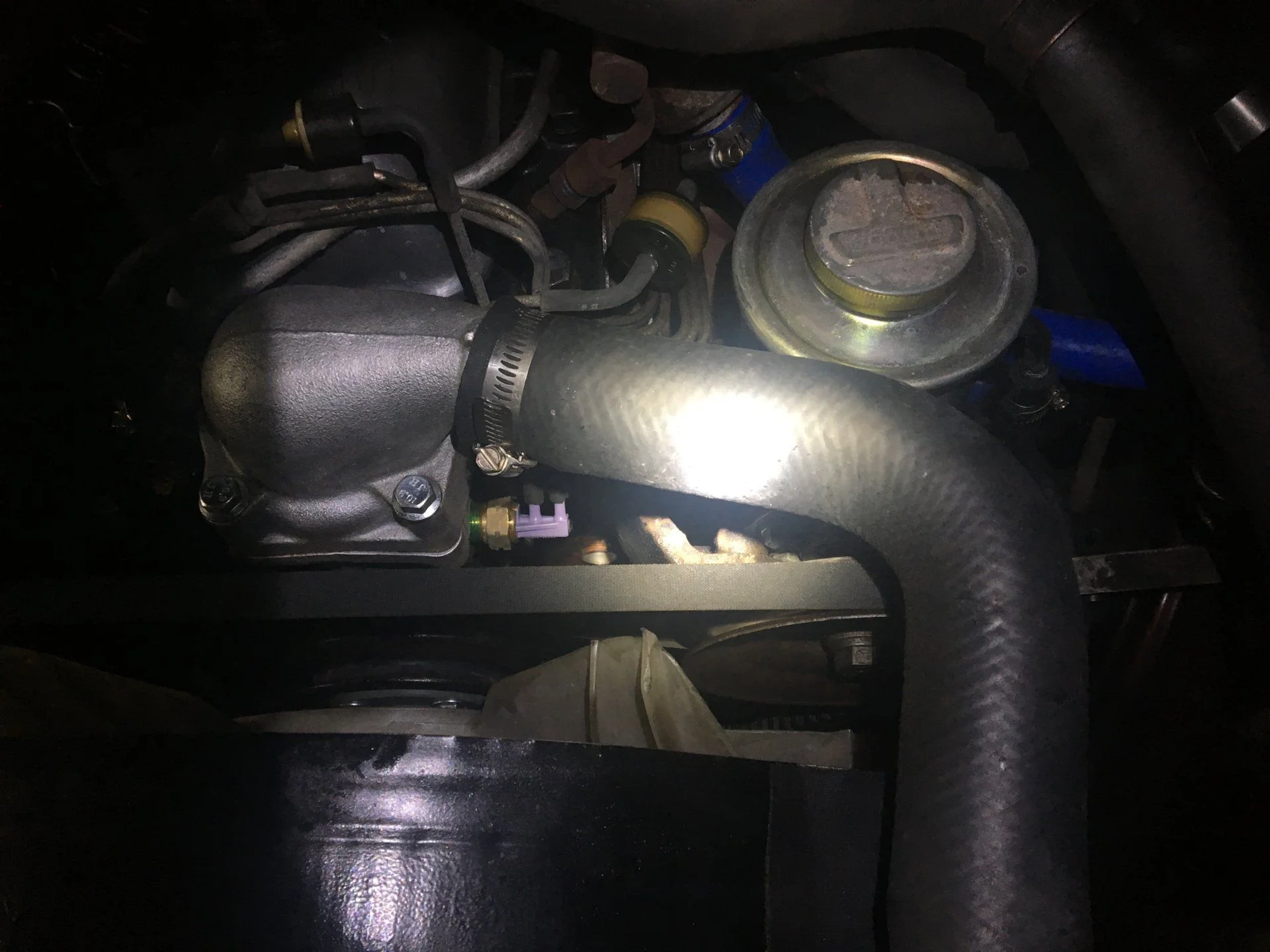

I grabbed a couple pix when I ran outside for my stethoscope... (my kid sounds like crap!)
Pic I’m adding is a very obvious headbolt.

went out and looked again and it does appear there is a bold missing. Looks like it holds a bracket in place. Will have to see about getting that replaced. Good eye. I noticed blue vacuum line and noticed the same thing on a used rig I was looking at before I bought this one. I often get surges when the engine is not cold and thought maybe it was vacuum issue. Did you just go and replace all your vacuum lines with good quality lines and is there a kit you can buy to do that??
Is that hole your questioning on a horizontal or vertical surface. It’s really hard to see in your photo.

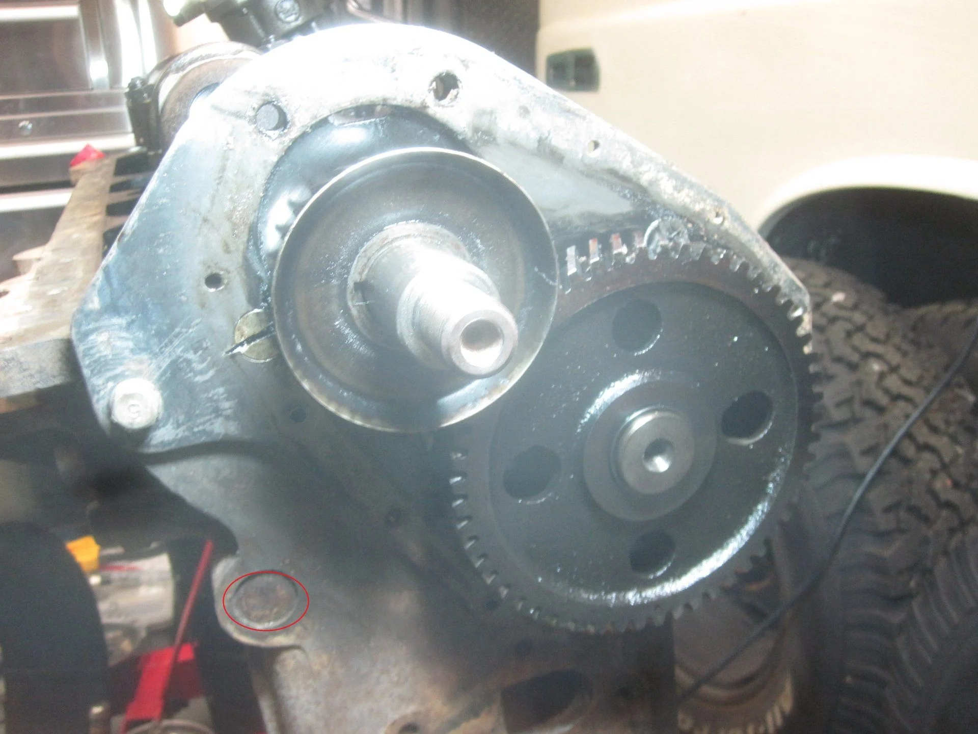

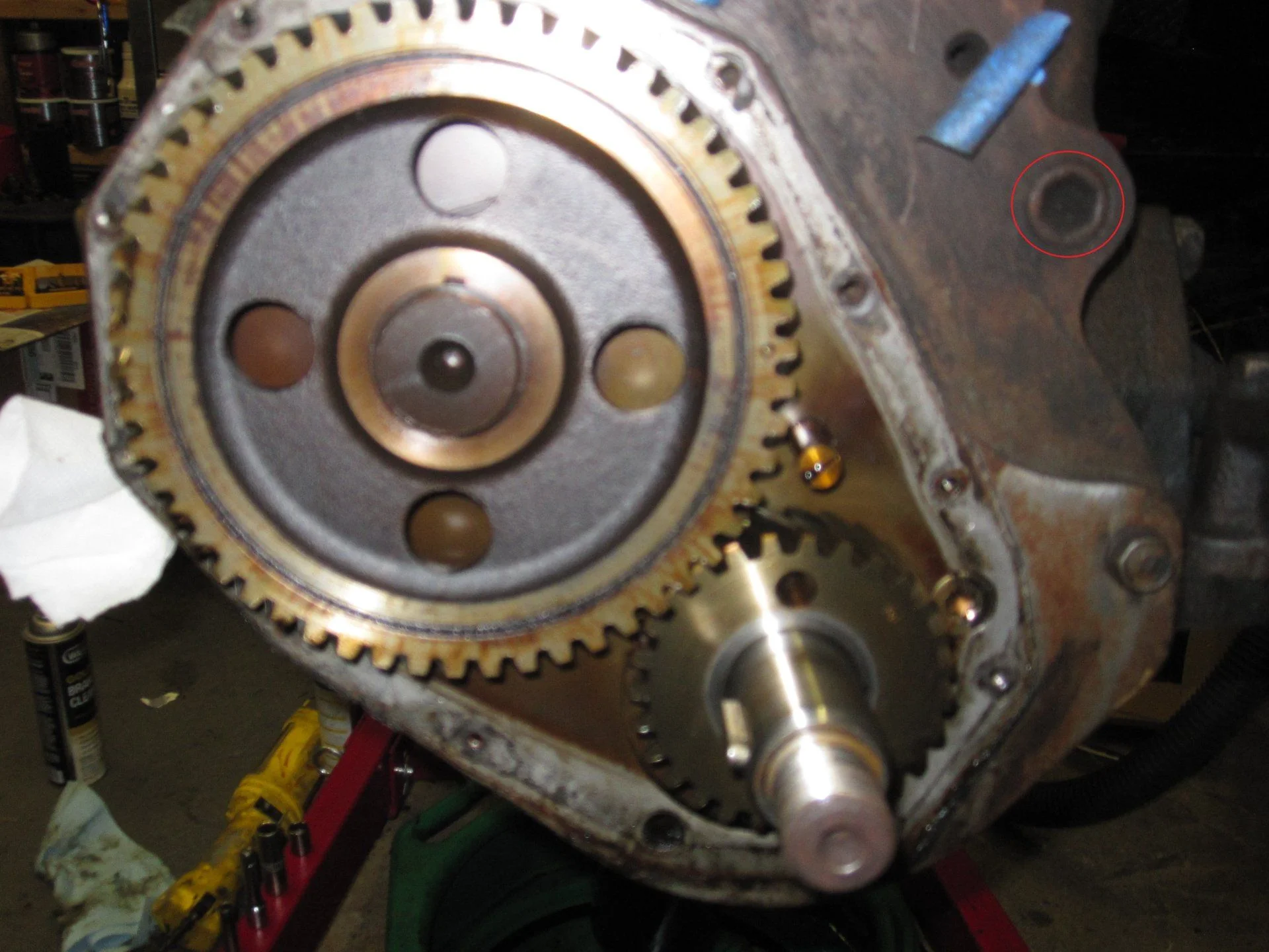

This is where your leak was. It is a press fit plug on the pre 85 2Fs, like your engine. In 85 they made it a threaded plug. See pictures below. The plug they installed is sitting quite a bit raised from the block surface.
