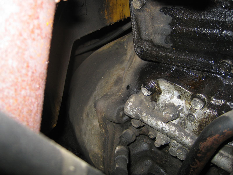

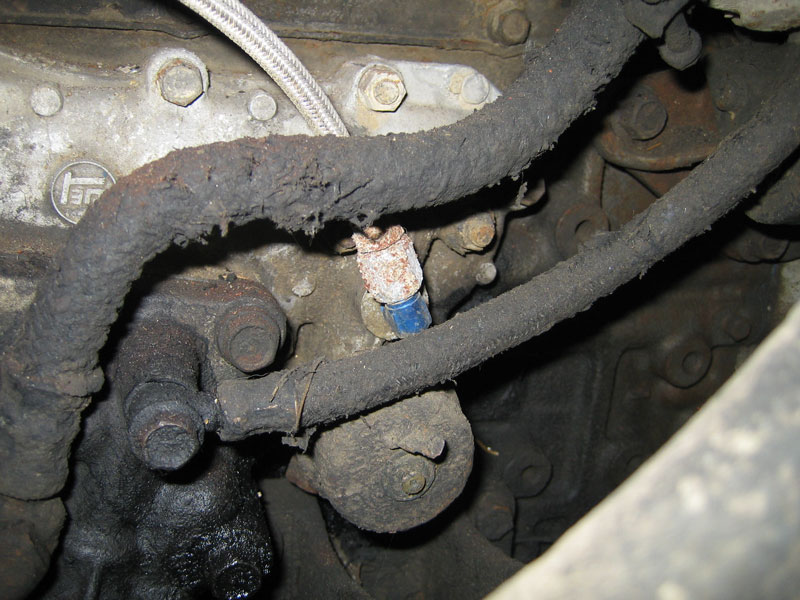

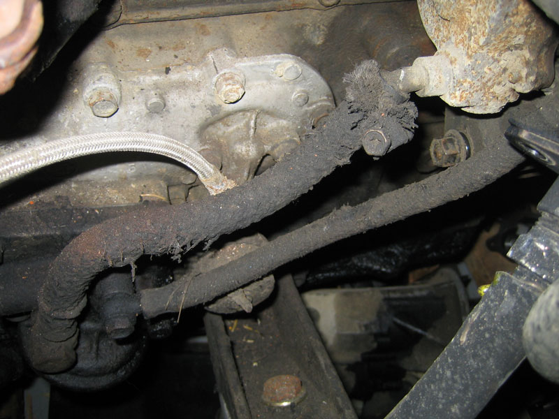

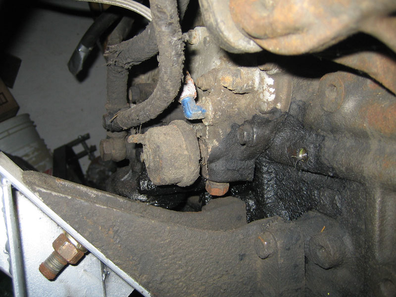

I have two 3B turbo engines. Each uses a different location for the turbo oil fitting. I have no idea which is the preferred method.
Here's a photo of one system:
And here's a few photos to show how the other one is hooked up:
