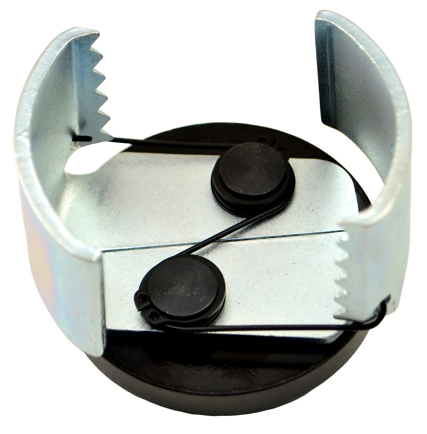

i found one of those circular expanding dealies to be just the trick. I have 2 extensions on it and a 3/8s cheapo ratchet. Looks like the below. dont use the tri tip expanding ones, they dont work. No effort with the below

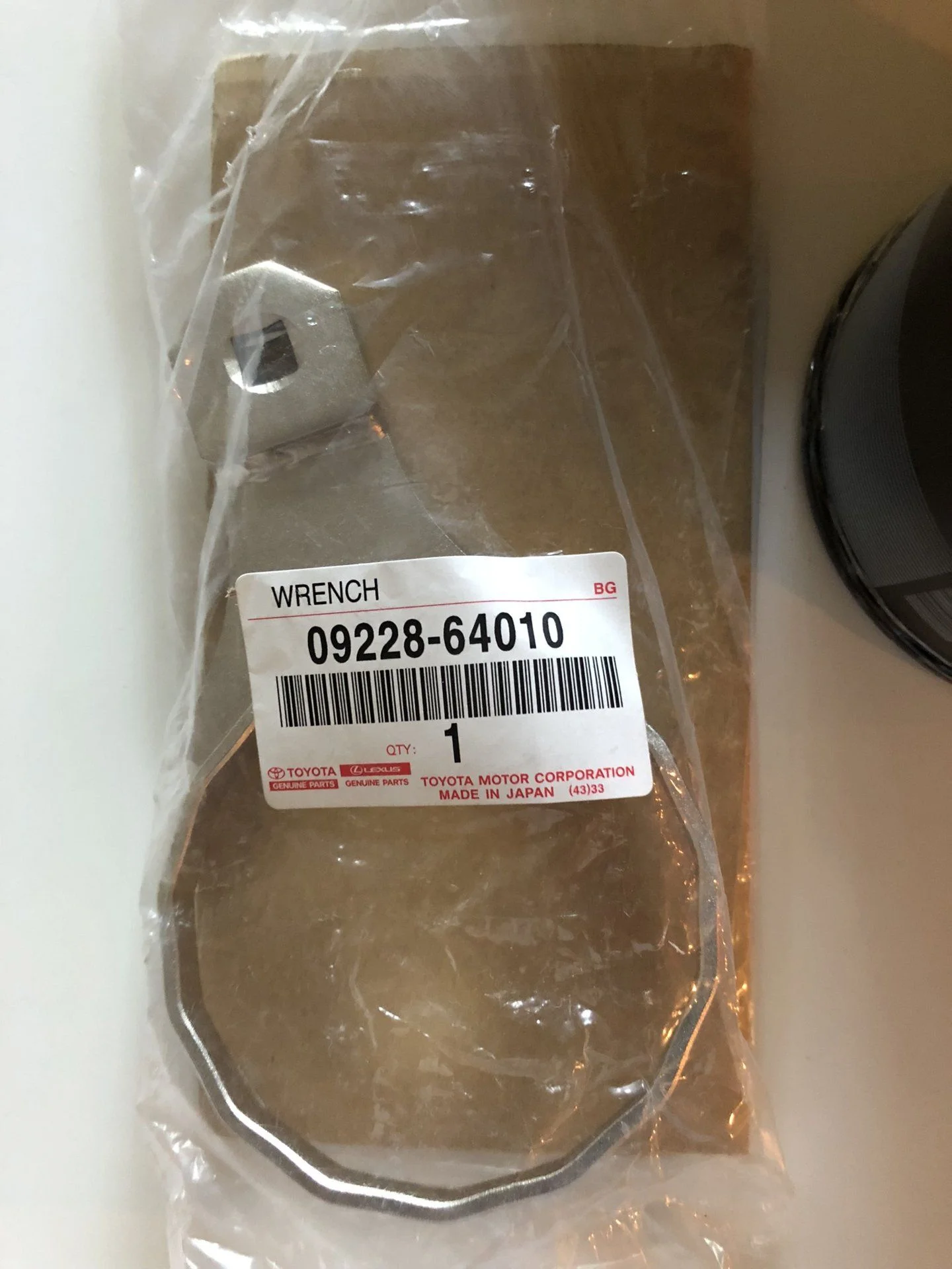

Here is the one that Beno got me. 09228-10002 My apologies if the one in the book was incorrect.
1997634
1997635
I might as well add that the SST for the fuel filter has also made it easier for me to remove that as well. Beno got me that one as well.
P/N: 09228-64010

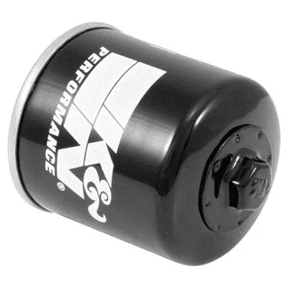

With motorcycle oil filters I buy K&N filters and they come with a hex nut fixed to the end of the filter. No wrench needed. Anyone make those in larger sizes?

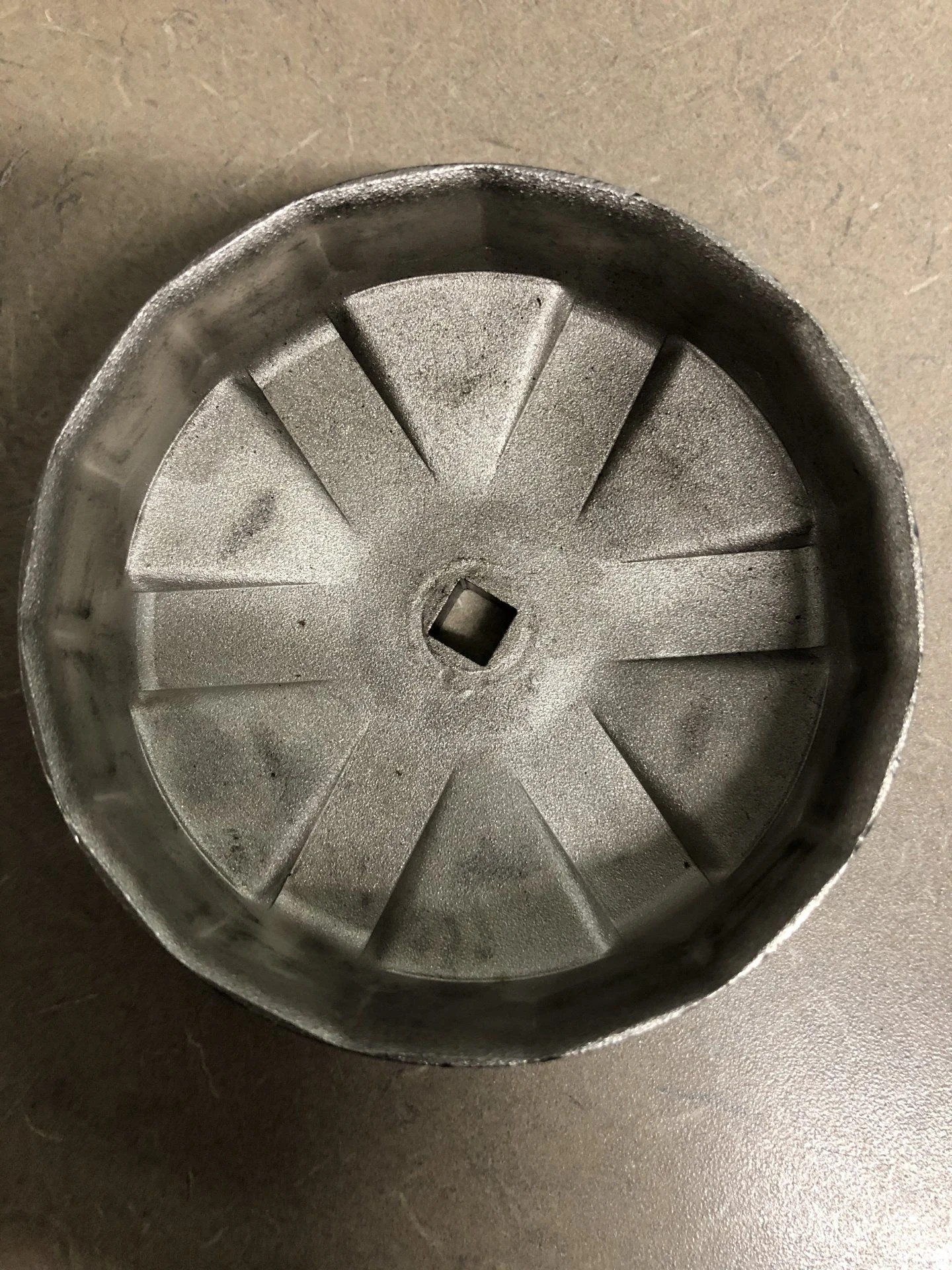

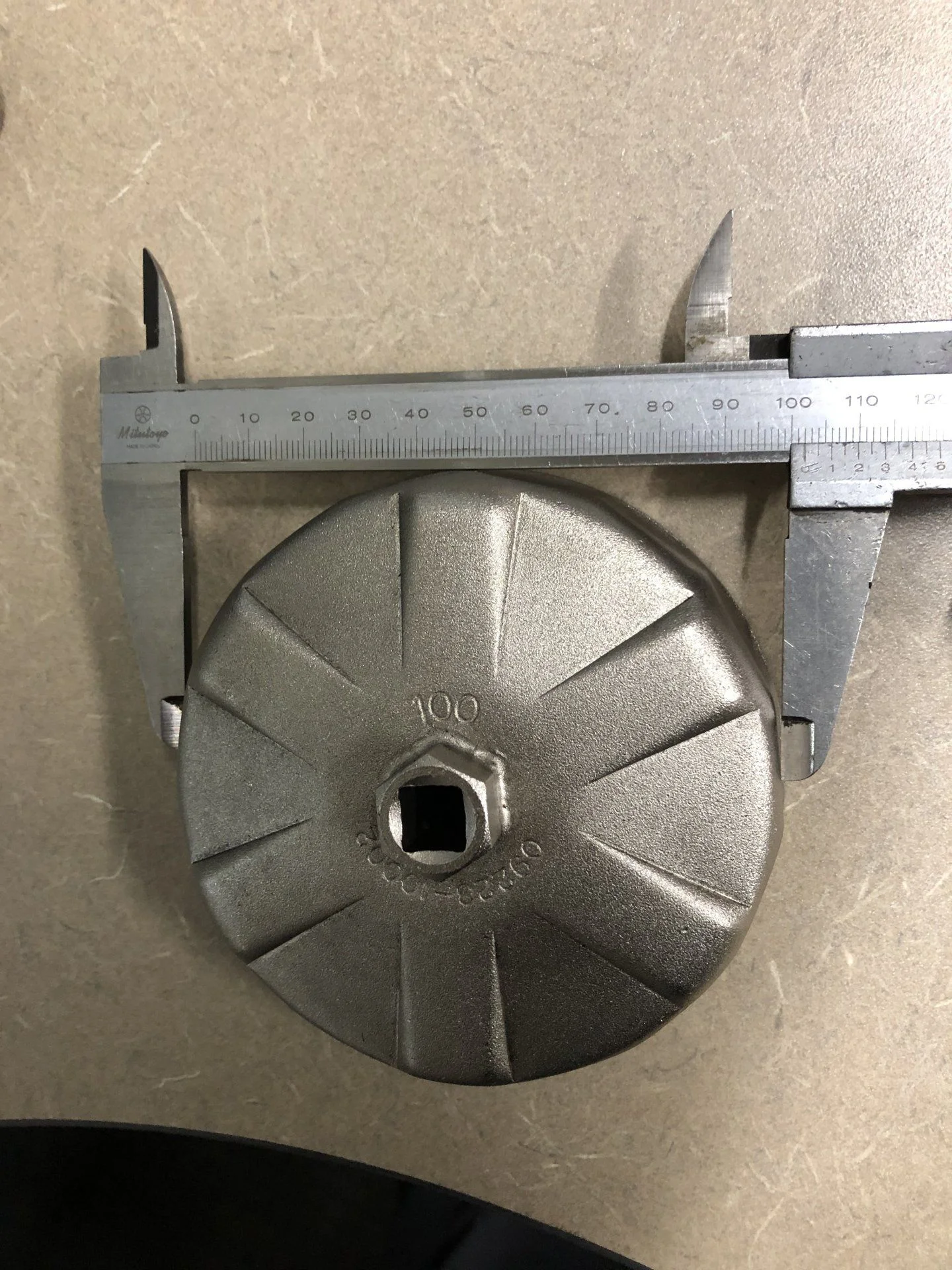

15 flute. I had the tool in my truck so I brought it into the office to measure. Not sure how you measure one of these properly but it is close to 100mm ID and 100mm OD.
