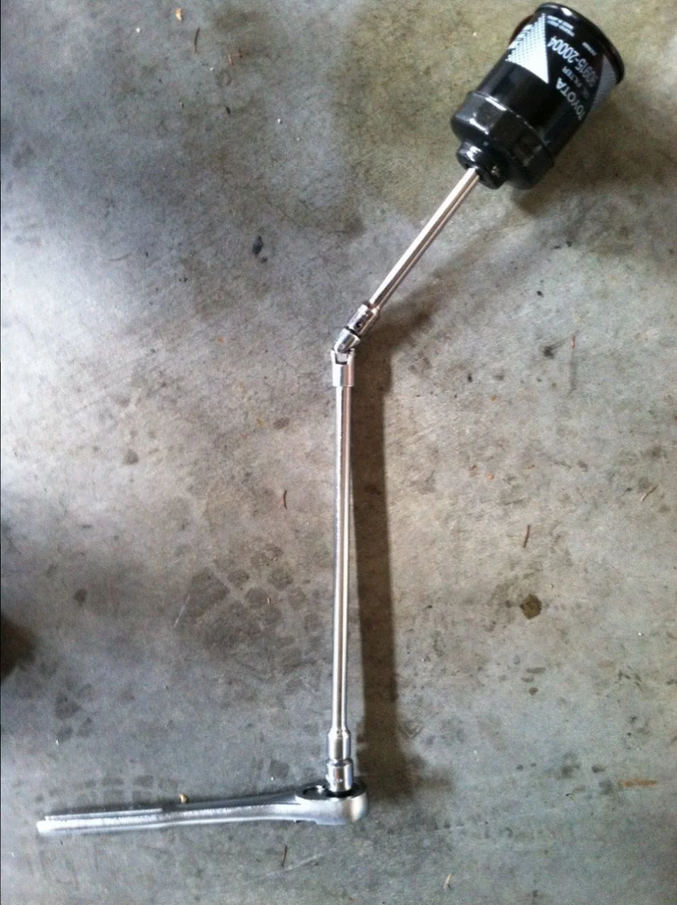

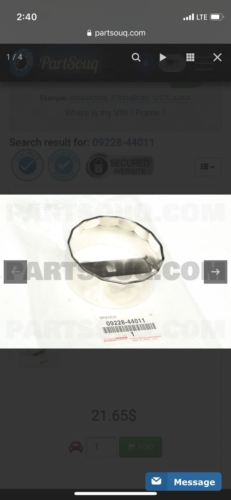

I used to do this until I got one of the sprung kind that slips over the end of the filter. It uses a rachet and tightens on the filter when loosening the filter.
Looks like this

This is what I have been using for quite awhile. Works great!
1/2" ratchet
1/2" to 3/8" adapter
12" - 3/8" extension
3/8" universal
6" - 3/8" extension
Metal oil filter adapter: Vector p/n 17050
^ Yep, that's the same style adapter I use and was describing in my post. Never had an issue removing the oil filter since, especially if it was only hand tightened in the first place.

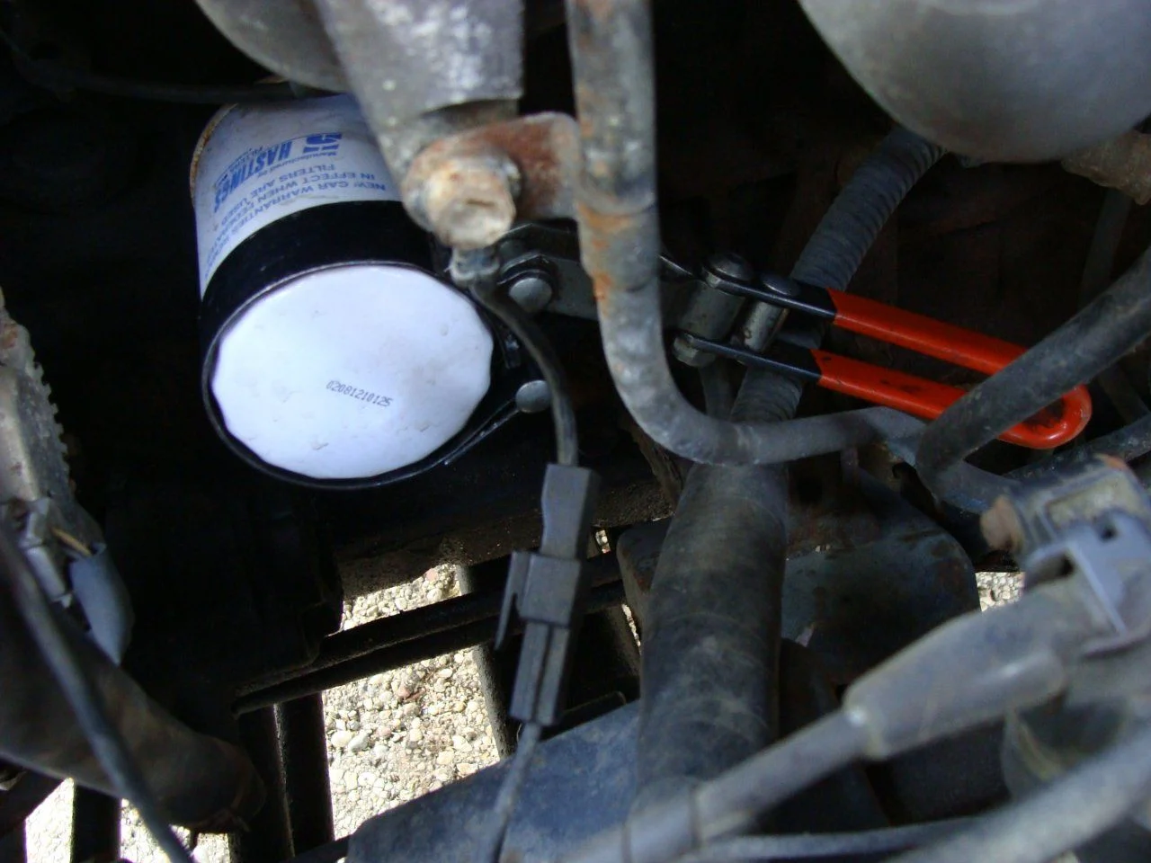

Most filters used to say-1/2-3/4 turn after making contact with base to tighten. -many many hundreds this has worked for me-problem is when someone else installed it-same with drain plugs but that's another story. Stay away from quick lubes. . Many times on stuck filters I hold heavy pressure on the wrench for a minute or so and it will slowly start turning on it's own. I prefer these wrenchs for 90% including on these . Any destructive removal as a very last resort
Today I struggled with e filter. Removed the right front tire. From under the hood attached a chain wrench and got it broke. Then a filter wrench and hand turn got it the rest of the way off. The chain wrench is also good for removing front shocks.
