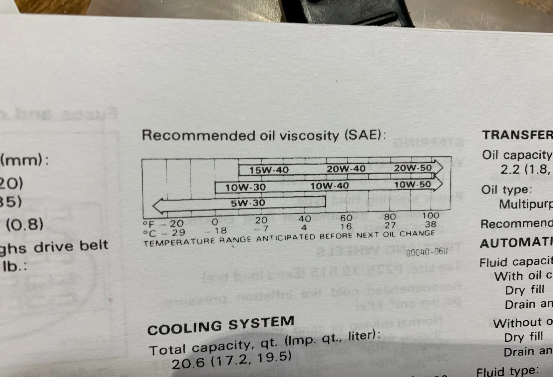

if you simply follow the 1985 FJ60 owners manual you can't go wrong on the viscosity
we are entering WINTER here now , and since your in Oregon , the 10W40 weight and the chart rules should apply to you for sure ...
- as far as paying $10 QT for any oil , FULL Synthetic is simply gonna hover around that no matter what brand you choose from .........
- you get what you pay for with 99% of all auto parts , you install $2.99 GHETTO-GRADE Conventional oil , you can expect Ghetto Grade $2.99 results when it starts burning and making various deposits inside your 2F and hardened seals and O-Rings etc.......
- a 10W-40 High Mileage full synthetic like MOBILE ! is what you should look to , at Walmart or SAMS club comes in a 5QT container ,,,,,,
- YES , this is indeed rocket science , when it comes to this topic , so treat it as such and install space-age modern oil in your 1985 2F
This is a 1985 FJ60 USA spec owners manual page …
You can either obey the OEM original print media stated facts or consider urban legends and wise tails …
I personally obey TOYOTA on this topic …
Why would I not ?
