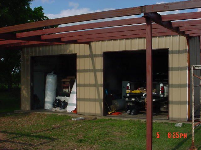

Boys done commenced workin' at the crack of noon on Friday and made good progress. Got the uprights welded up against the existin' shop as well as the the other vertical posts. The short ones in the middle will have a major friggin' beam goin' 'cross 'em for the floor of my loft that will go over to the horizontal beam shown on the right. Be 10' x 30' of extra floor space. :cool:

All the tabs are for hangin' the purlin deals. Lot cleaner design than the existin' shop which has the purlins settin' on top of prefabbed trusses. What you see is what you get .... no bottom beam ... freespan 'cross the new 24' shop section. :grinpimp:
We trimmed the existing wall just enough to clear the new uprights and truss.
When the new shop is all done .... just tear down the existin' wall .... so the shop's never open to the elements during construction. :cool: :cool:
