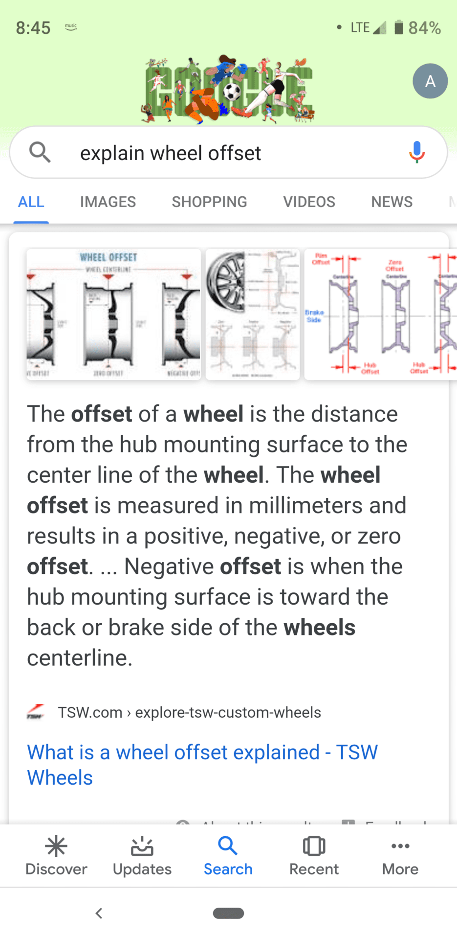

Hoping for a quick clarification from someone that knows more about wheels than I do. I understand the principles behind offset but not sure how to tell what the offset is for these wheels I’m looking at buying for my 80 series.
Are these wheels the -6 or +6?

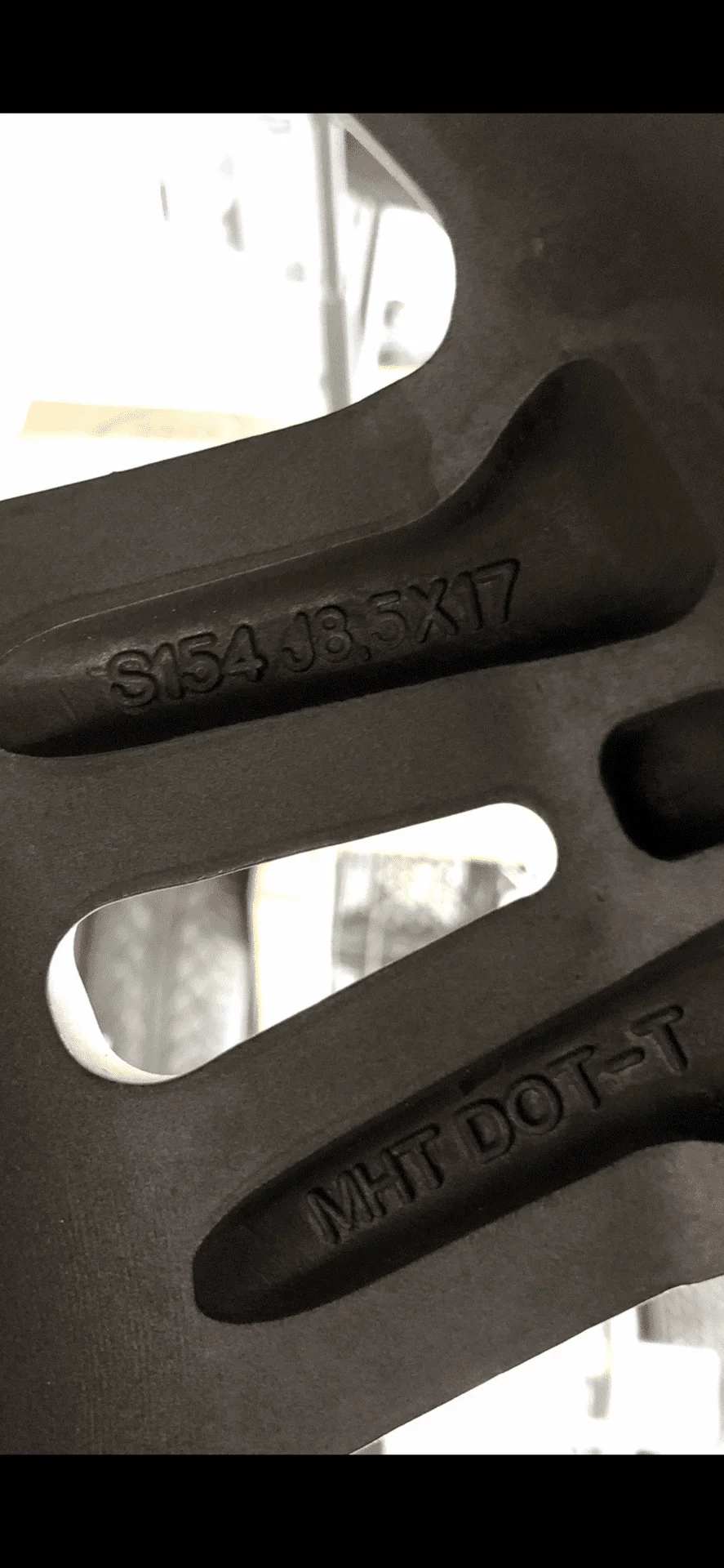

Not sure where you are getting 6 from? 154mm ~ 6" but those wheels certainly don't have 6" offset either way.
The offset spec typically denotes MM from wheel centerline.
Yeahhhh, that’s why I’m asking. They’re 17x8.5 with the 6 lugs and they either come in +/- 6mm. Trying to figure out which these are

Have you got a better pic of the wheels from both sides? Have you measured the back space from your wheels
that you have on the truck now?
