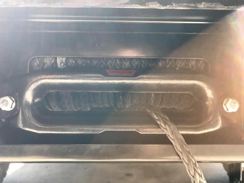

Sorry for all the bumper questions. First time installing one and it went pretty well but left me with a few questions that I'm not sure about.
Everything I've read about a synthetic line with the ARB deluxe bull bar bumper makes it seem like I need an offset hawse fairlead, like the one from Slee. I spoke to Slee about it and they couldn't confirm 100% without seeing the truck but made it also sound like I needed it. For now I've installed the Warn fairlead that comes with the winch and it looks OK to me. I think if I got an offset fairlead it would throw the angles off even more and have the rope being pulled up and out.
here's a pic of what mine currently looks like, with the spool full:
Obviously that angle is going to change with some line out but does that seem OK or should I pick up one of the offset fairleads? The other benefit of the Slee fairlead is it's thicker which would help protect the line a bit and get it out closer to the edge of the bumper but it's only .25" thicker than this Warn one so I'm not sure it's enough to make a difference.

IMHO, the TT recovery points are the best US option for use with the arb bumpers and yes you would benefit from an offset fairlead, especially when pulling on the last wrap of the line on the spool.... which is proper. I've not been able to locate the Roadsafe nor ARB frame mounted recovery points stateside, I'd love a link if you have one.
Stack another fairlead on top of the one you already have. That will eliminate any worries. It brings the fairlead out flush with the ARB opening.

I've also had my line all the way out to the last 8-10 wraps for a single line pull and it wasn't rubbing the fairlead, it was actually nearly perfectly centered. The only fear I would have is what Stan outlined regarding the fairlead being so tucked back in that it may rub forward of the fairlead on the bumper recess if you have to pull from an extreme angle.
I wanted to sanity check myself before I posted this (lies, internet, blah blah blah...), so I ran out to the garage and pulled my line out. You'll see that it's not touching the fairlead when pulled straight out... granted you rarely ever have a straight pull, but you get the point.
Hard to tell from pics but it looks like you either need to move the fairlead up or the trim the metal bumper behind it. Test: try unspooling all but 8-10 wraps and then spool in while feeding the winch line from either the extreme driver's or passenger side. In other words, make the winch line bunch up to one side. Not desirable but sometimes not avoidable. Also hold the hook/end down towards the ground. Will the winch line rub on that metal?
I see what you're talking about in the photo, but I assure you there is no metal anywhere inside of that fairlead... That's an optical illusion from the terrible lighting in my photo. What you're seeing is the light reflecting off of the metal lateral support on the winch. If you look at the photo I posted above, you can sort of see what I mean. I'll take a better photo later.
