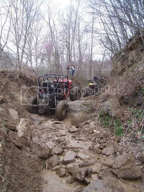

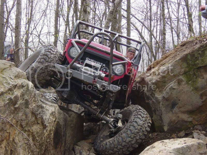

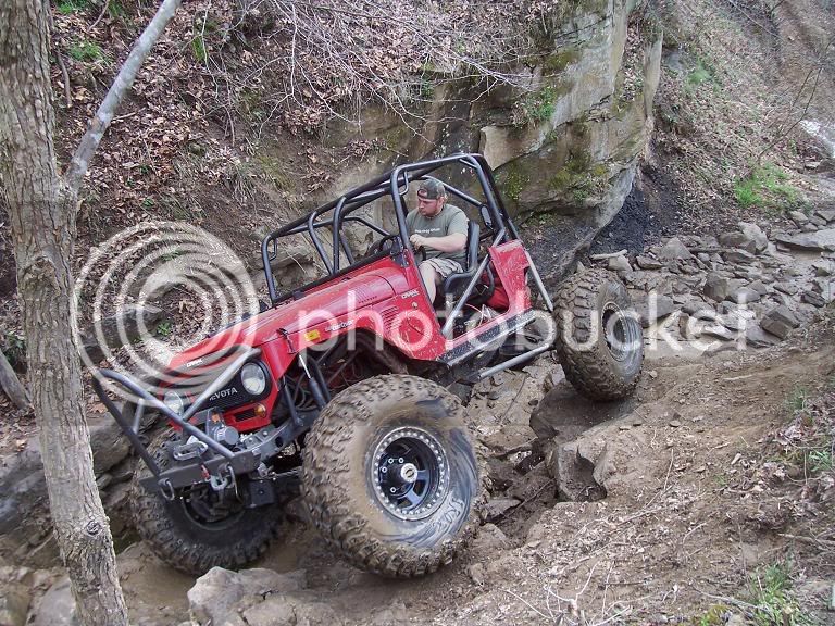

Here's my Cruiser. It's a '74 FJ40 with a Vortec 350/SM465/LoMax 205. It's sprung-over with the front springs flipped and a shackle reversal. The rear springs are stock XJs with a couple of leafs added in. The shocks are Ranco 9000s. The wheelbase is 103".
I run 39.5x13.50 IROKs on 15x10 beadlocked wheels. The front axle has the knuckles turned and an armored, removable diff cover. I have 30 spline LongField birfs/inners and ARP chromo knuckle studs and hub studs. The steering is saginaw with Marlin Crawler high-steer.
The rear axle is a Toyota mini truck/Cruiser hybrid. It uses a Cruiser third member and mini truck axle shafts, so it's centered for the center output 205 t-case. The rear diff is welded and has a fine spline pinion, with an armored diff cover. There are disk brakes on both axles.
I have Warn 8274 on the front with a Metal Tech radiator hoop and stinger. I fabbed the rear bumper and sliders. Me and a couple of friends built the 8 point roll cage also. The seats are made by Corbeau.
