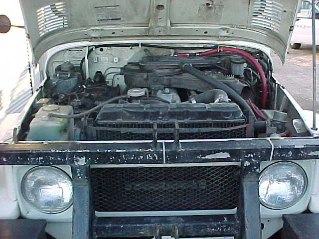

rutbeer - I sent you a PM with my email. Yes, I'm in W-S near Robinhood/Peacehaven area. I had the rig for about two years in the 'pre-resto' condition and it got plenty dirty...attached a few 'before' pictures.
Sad to say, since the resto it hasn't been that kinda fun...the pitfalls of doing a full restoration. Had to do it all over again I'd probably keep it a 'little rough' so as not to hesitate enjoying it for what it is...a tough truck.
Little-joe ...Thanks for the invite to Raleigh....what time? I'll see if I can make it ...Its been about 2 years since the resto has been 'done' so while it still looks good its not quite as 'crisp' as these photos indicate. I'm hoping to install a new muffler to quite down the rig a bit...think the neighbors will appreciate that!!

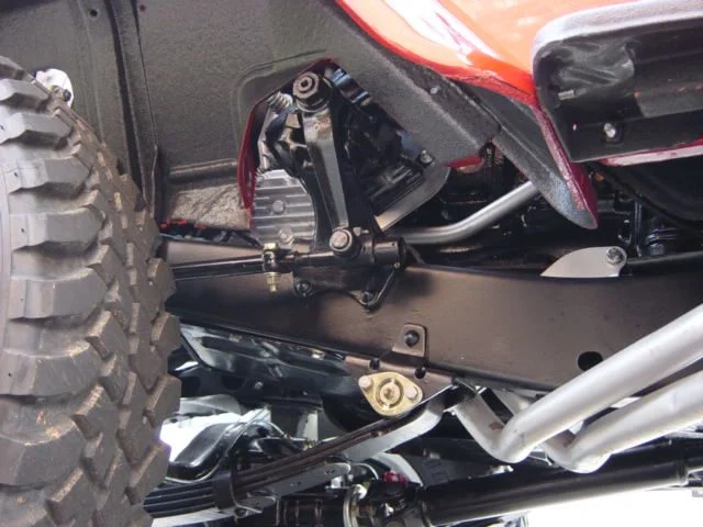

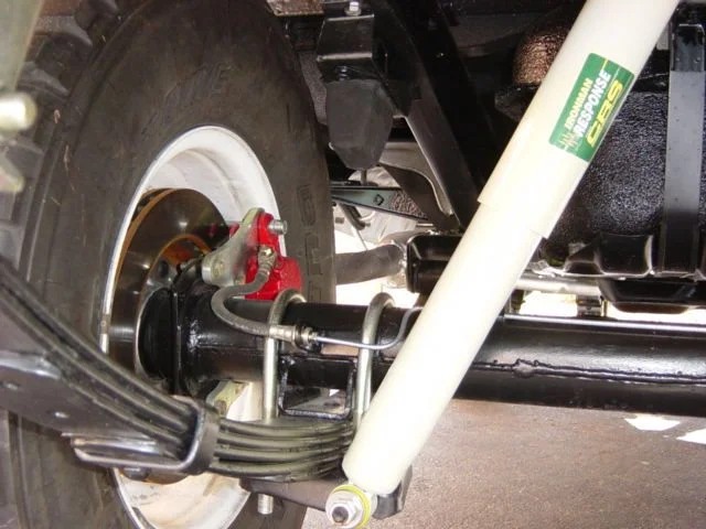

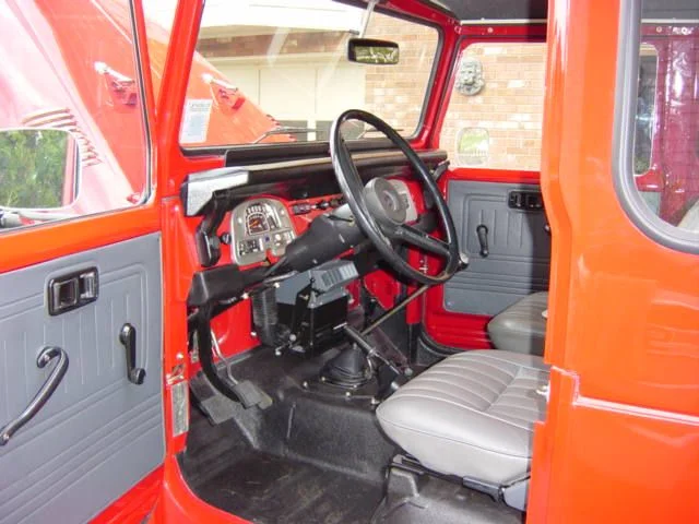

Thanks guys -- appreciate the comments. Yep - those are 'recent' photos...few more attached. Most of the pics I have are too large file format to post on this forum.
The cruiser is basically stock except for a few mods...I did change out the rear drums for the disc brake conversion and when I had the tub off the frame -- blasted it and the frame, POR-15 both and then rhinolined both the under side of the fenders and tub and the lower (below hardtop) inside of the tub. If it could be disassembled and rebuilt it was..I went back with stainless steel hardware on everything but the drive train (grade 8 yellow zinc).
Had the cruiser painted at local place - The Paint Shop by Scott Winfield -- he does alot of hotrods and custom cars mostly. All pieces were painted separately then I reassembled.

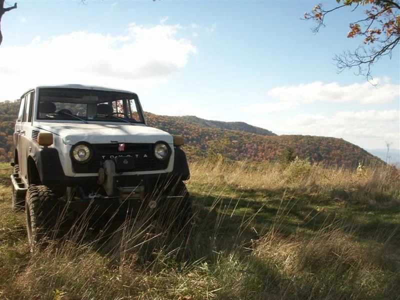

might as well add my cruiser collection.............

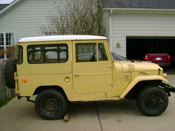

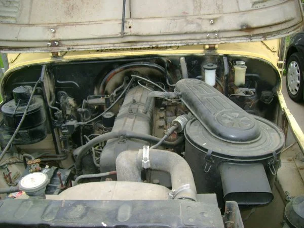

Figure I'd throw in a pix of the 40...here is some info..PO bought it from California 5 years ago (it's true what I have heard, dry climate=minimal rust damage!!), she didn't need too much work, fixed a few things and drove her around on and off...she is mostly stock (90%) with a few minor mods, original F engine and carb., roll bar, front and jump seats need to be repaired or replaced (no biggie), three on the tree (I am going to have to get use to this), frame and chasis virtually rust free, body is great condition no major rust through areas or rot, just some minor, minor surface rust and two areas where bondo was used but not b/c of rust/rot but to repair a very minor bang up, currently swapping out the front drum axle for a front disc axles..ran into a snag with the tie rod but got one from Juan in Raleigh and it should work after some modification...after that we will go to the rear...already have a rebuilt rear axle that needs brackets, rotors and calipers to complete the swap...slowly but surely we will get Old Yeller to URE next year...thanks for looking...Roger

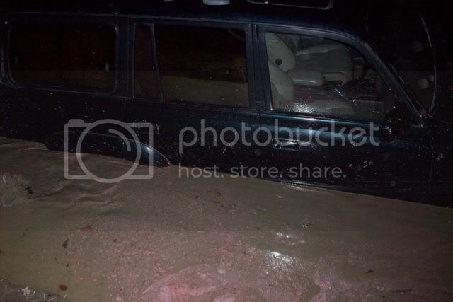

I've been on mud for a while, but new to the NC corner, so heres my stock rig..
STUCK
