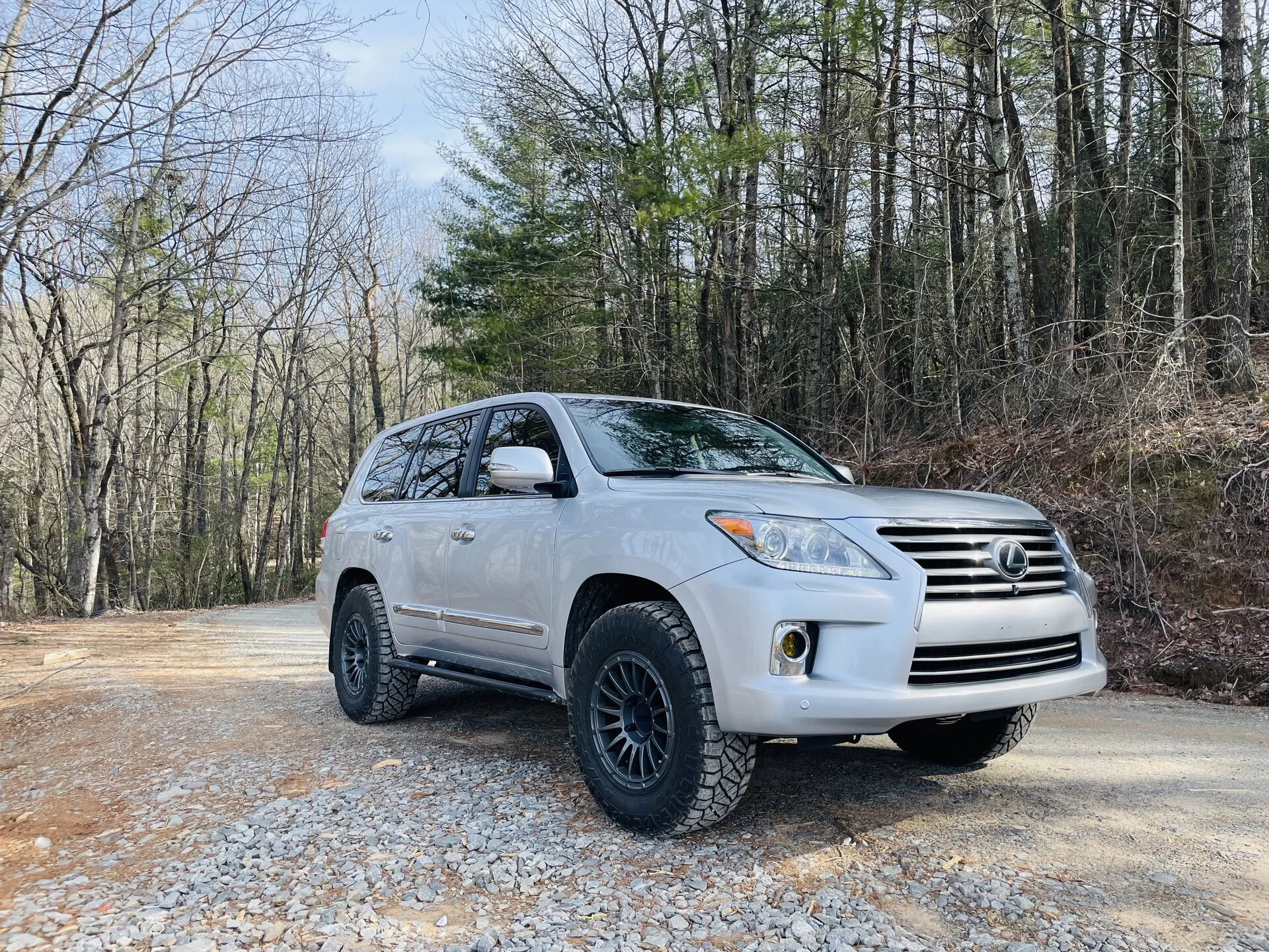

Took my 2 year old on his first mild offroad trip in North Ga. He had a lot of fun bouncing around and crossing streams towards Cashes Valley.

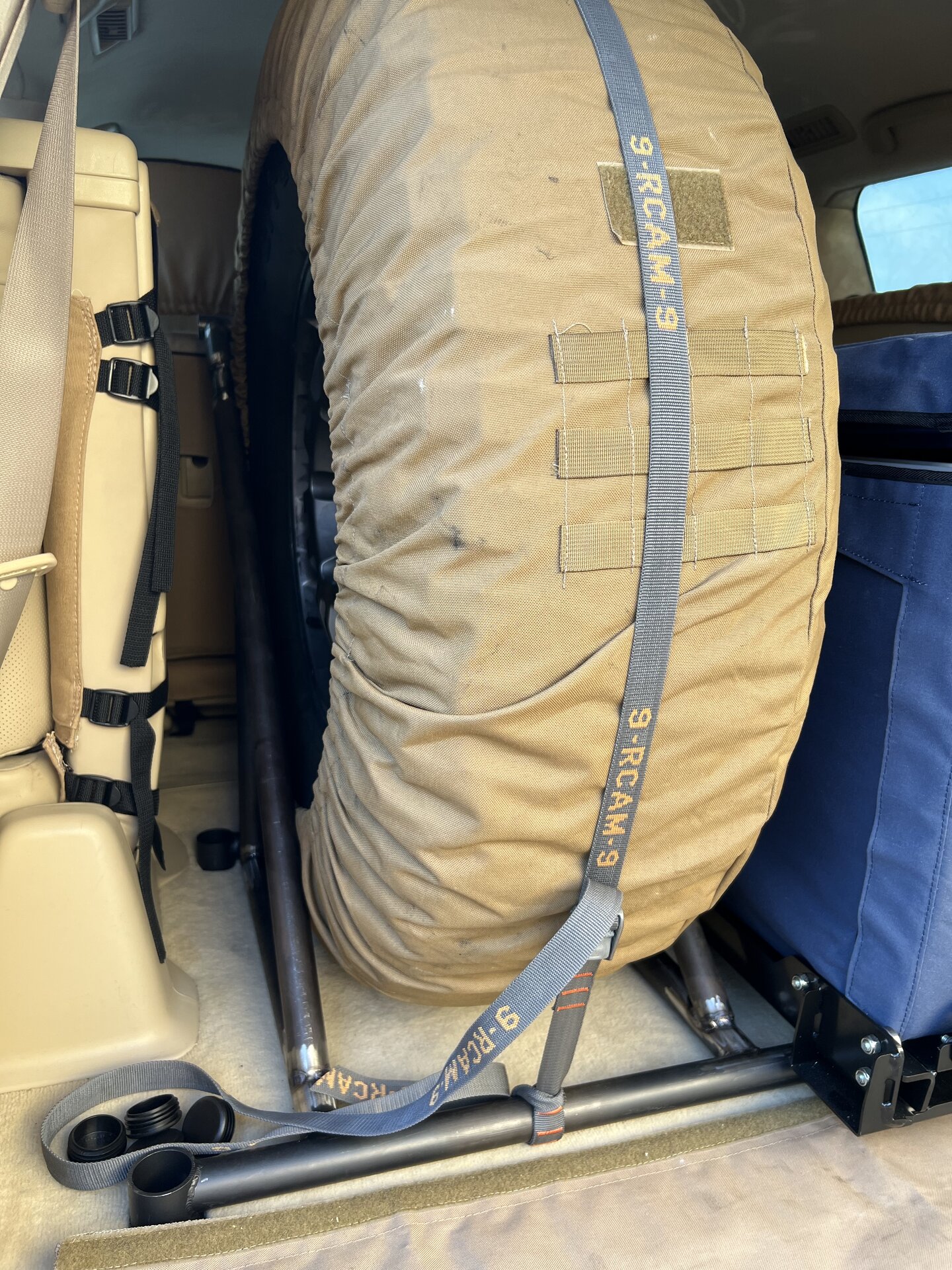

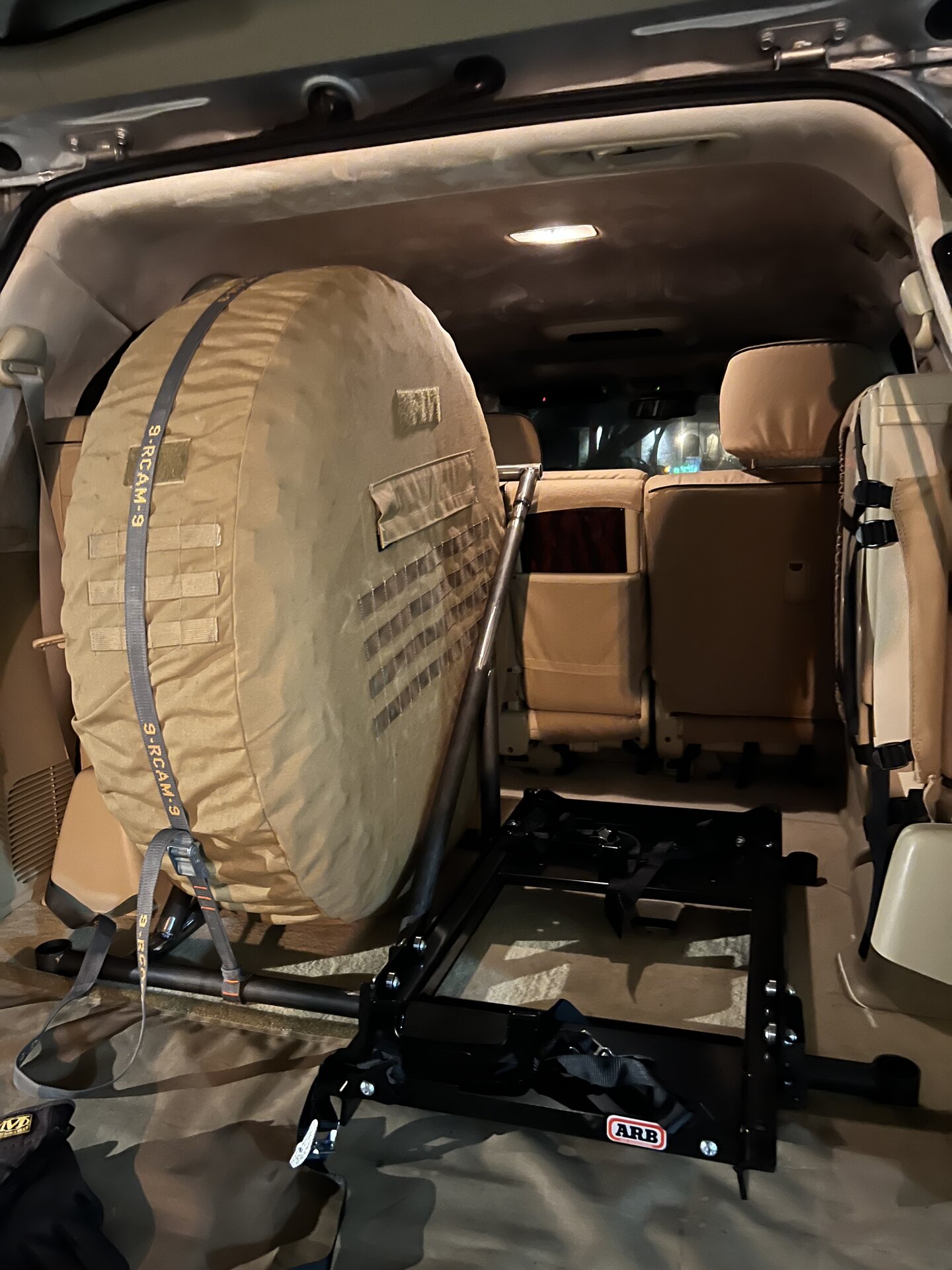

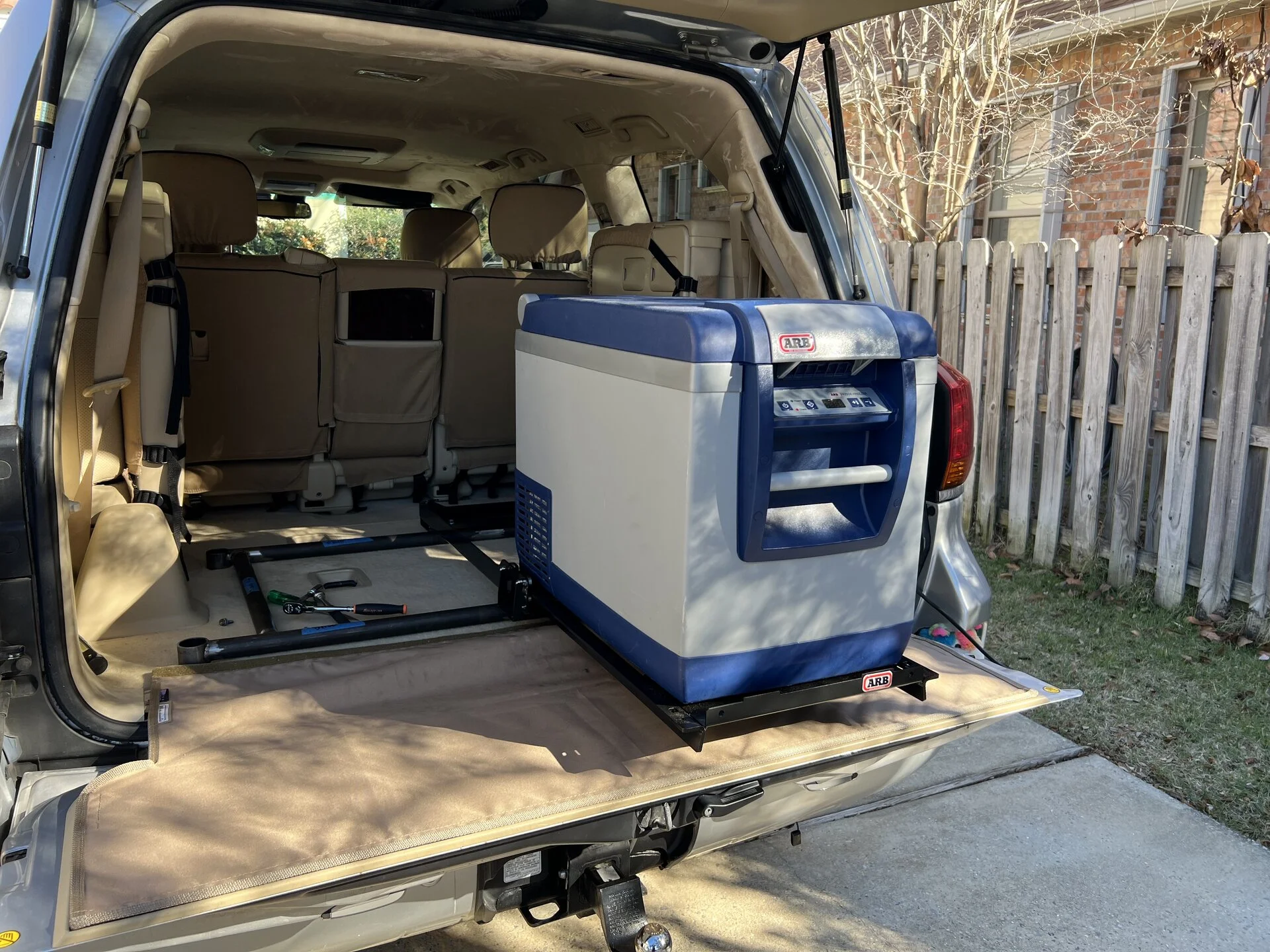

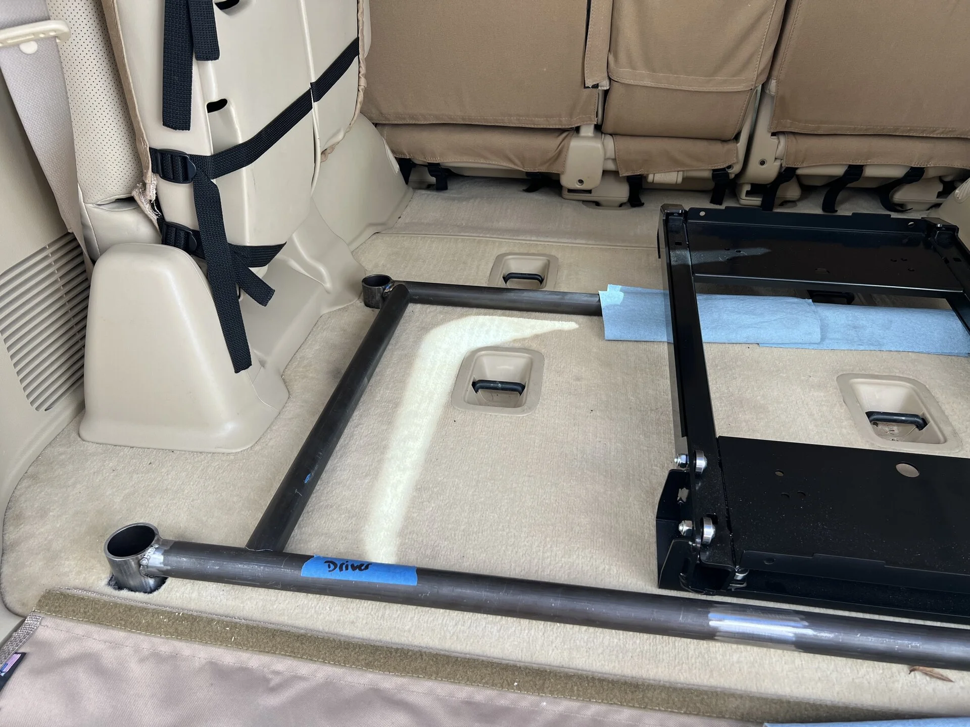

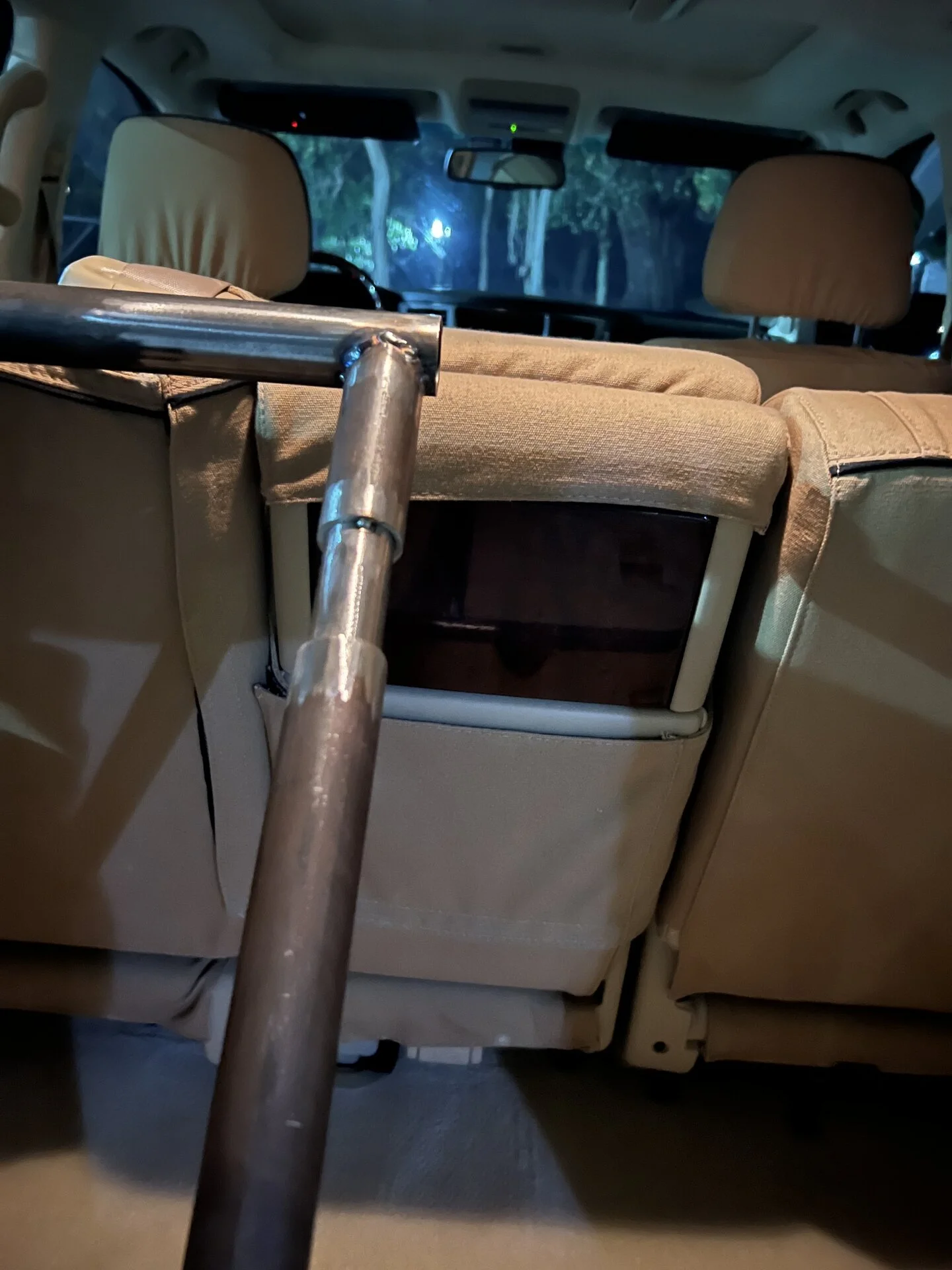

Show more of this inside tire mount please

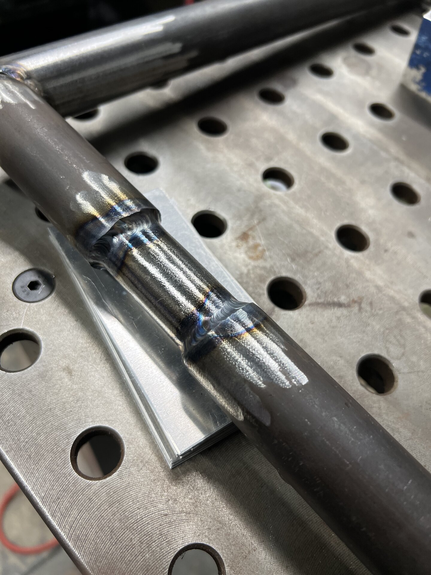

I built it to hold the 37 and a fridge. It mounts to the factory cargo points, then comes up and around the tire with vertical supports for the “hoop”. I don’t have a 1.25 die for my bender so I ended up welding it, and messed up my measurement! Fridge is on a slide next to it with some welded support tabs. Have a tire double strap on order and still need to powder coat it this week.
All DOM .120 wall, feet are 1.75, rest is 1.25. Used 1/8” aluminum spacers below the feet to clear the floor pan ridges, then grade 10.9 bolts to the factory holes. The 37 spare rolls over the front bar clearing the roof by about 1/4”. Side braces keep tire located nicely, and the double strap should keep any movement to a minimum.
Whole thing weighs probably 30lbs and can be installed or removed in about 2 minutes, which was important. And fridge side can be removed to store other stuff, but I had to use all 4 mounting points to be comfortable enough that the tire would hold.
