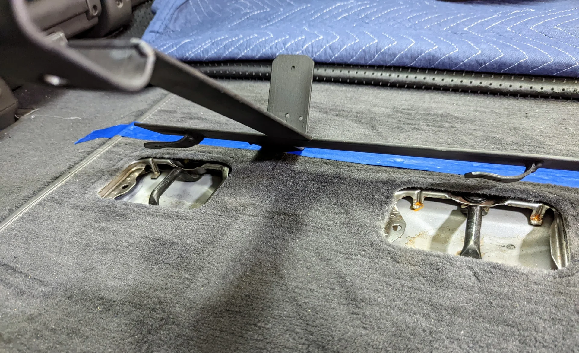

Curious why you went with such a thick baseboard if you have the ability to brake metal? One of the advantages of metal is the strength to create structure with relatively little space and material. Just a thought for opportunity to save that for more gear. Otherwise, it look great.
Seeding some ideas from a recent drawer slide I did. There's some stock bolt down points and other ways to engage the seat brackets
I like your design, my goal was a platform that I could remove quickly to utilize the back seats as well as switch between the lx470 and 570. Incorporating the stock seat anchors makes a lot of sense.Nicely done with the metal slides.

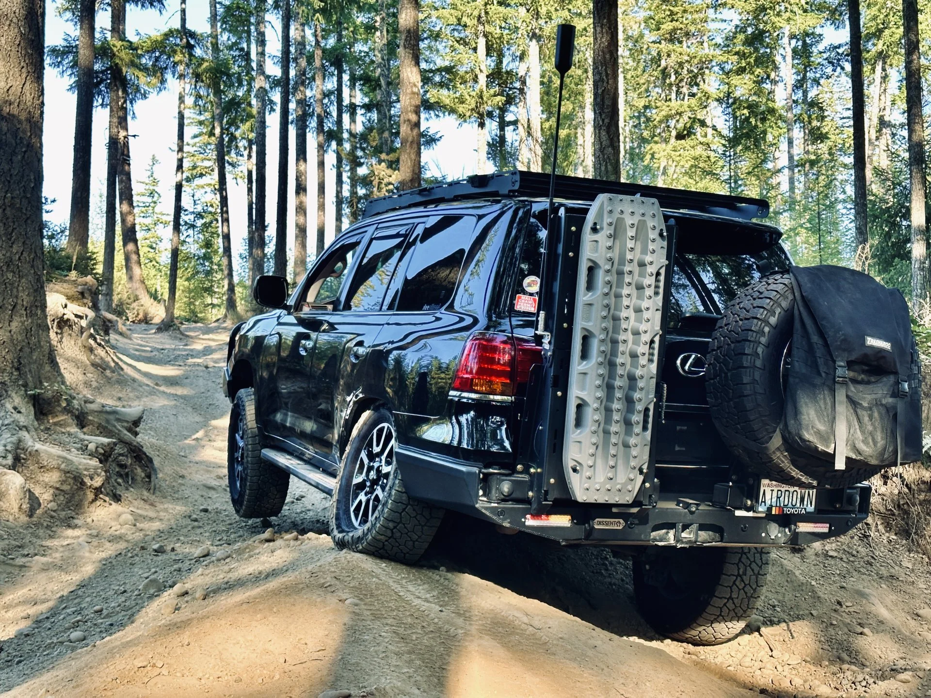

Stretching her legs
BTW at 295/70/18 at 30ish mm offset at 15psi will rub a dissent bumper. I’m considering a set of Timbrens for the rear.
Good ole Tahuya!!! Great looking rig.
If you ain't rubbin you're not using the full flex of the truck or need bigger tiresView attachment 3123027
Stretching her legs
