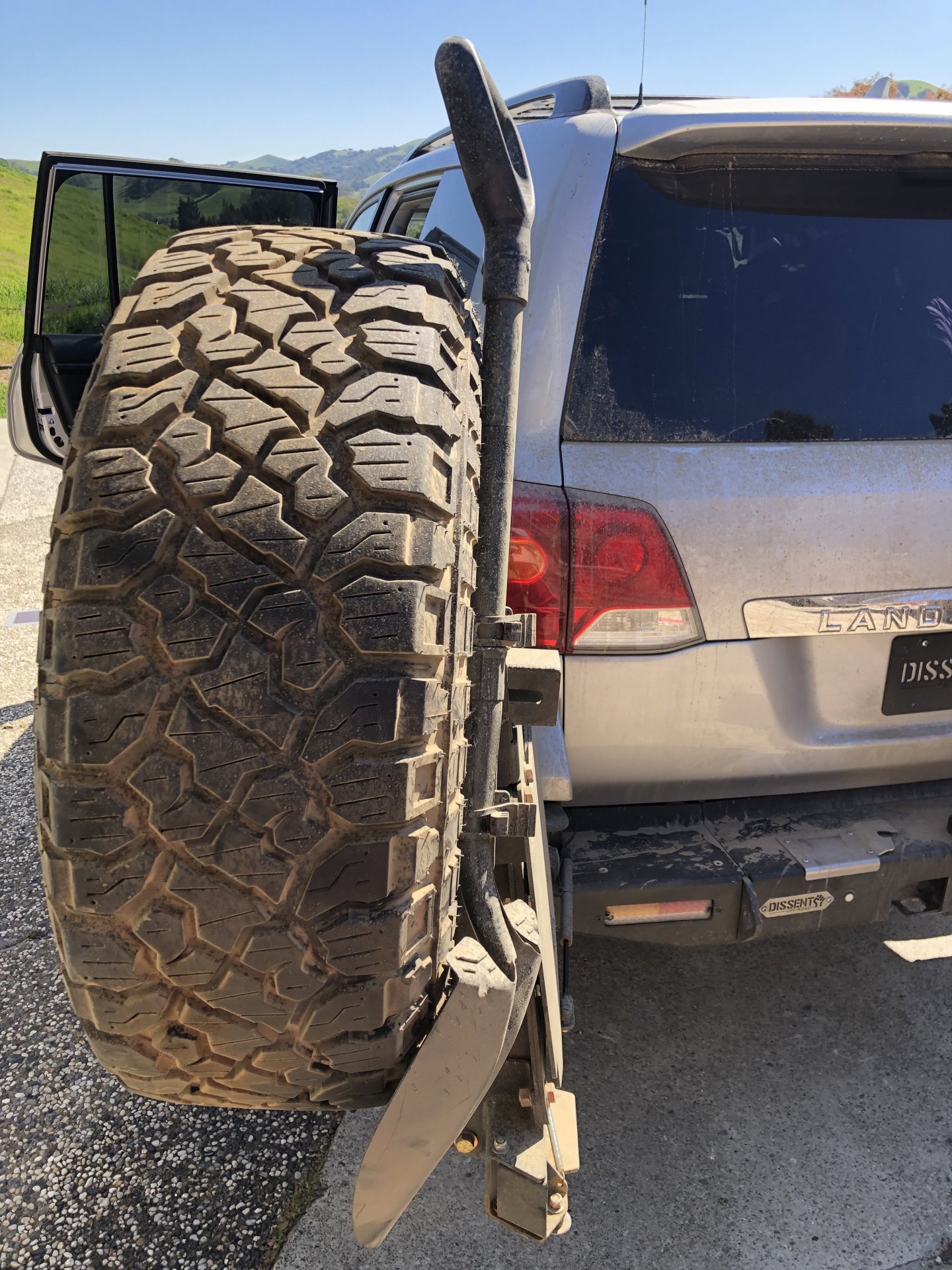

Still pleased with the Kenda Klever RTs? How are they wearing?
I don't want to speak for @TLC2013 , but we were talking about it this weekend and they look brand new. I did not see any chipping or obvious wear to speak of. And its not for a lack of trying 😂
I am, they are fantastic off road and on road is especially good considering the aggressive tread pattern. No regrets at all. Just Wish I could squeeze in the 35x10.5r17 but with the LCs KDSS it would be an issue as I don’t plan on doing any fab/relocation work of the KDSS. The RTs in LT 275/70r18s measure super tall and wide for a 275 tire so I don’t feel a need to go up just yet.
After 18,000 miles there is some road noise present between 45-55mph but not bad at all. I have been doing 5,000 mile 5 tire rotations and they are wearing perfectly.
Photo courtesy of @1world1love

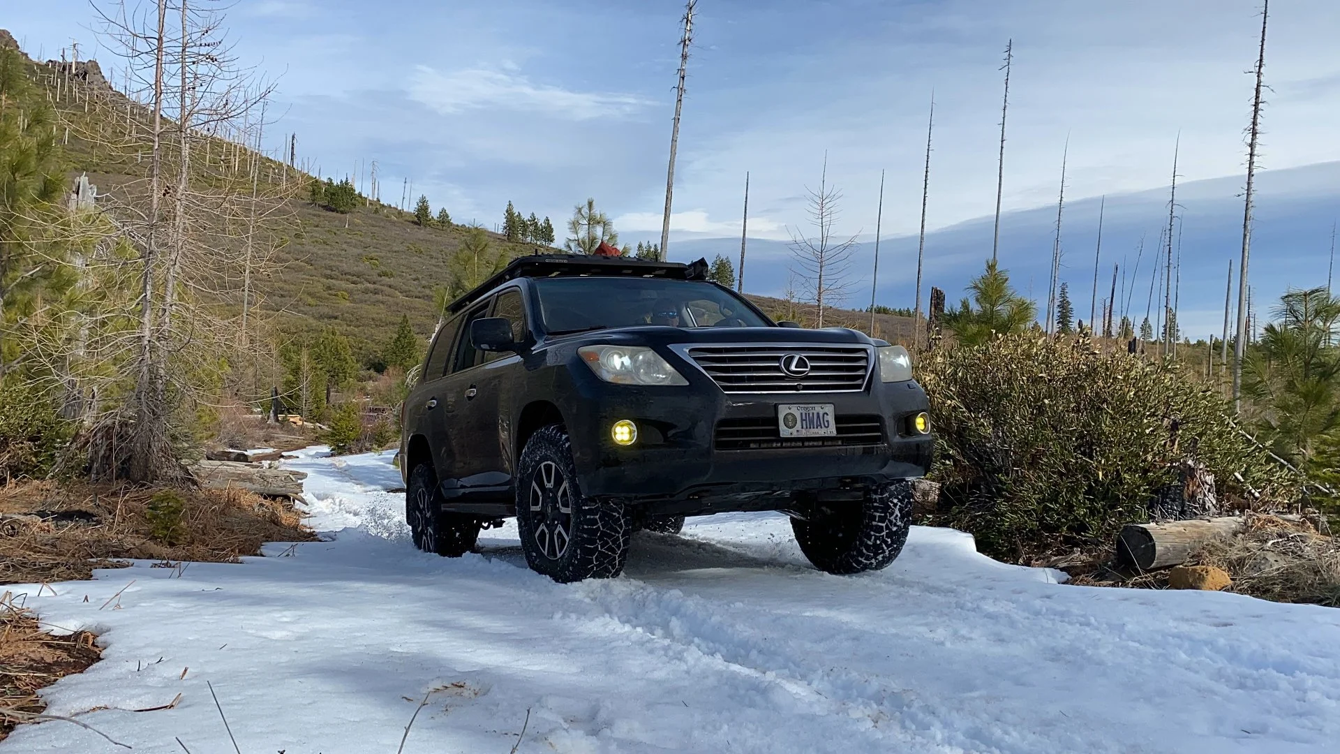

We live in Boise. It’s a very nice and scenic ride up to McCall. We love it here!
I was just browsing the thread and said "Hey I know that LX!" I'm in East Boise, have seen your rig around a couple times.

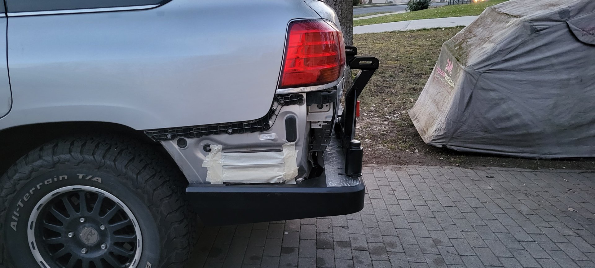

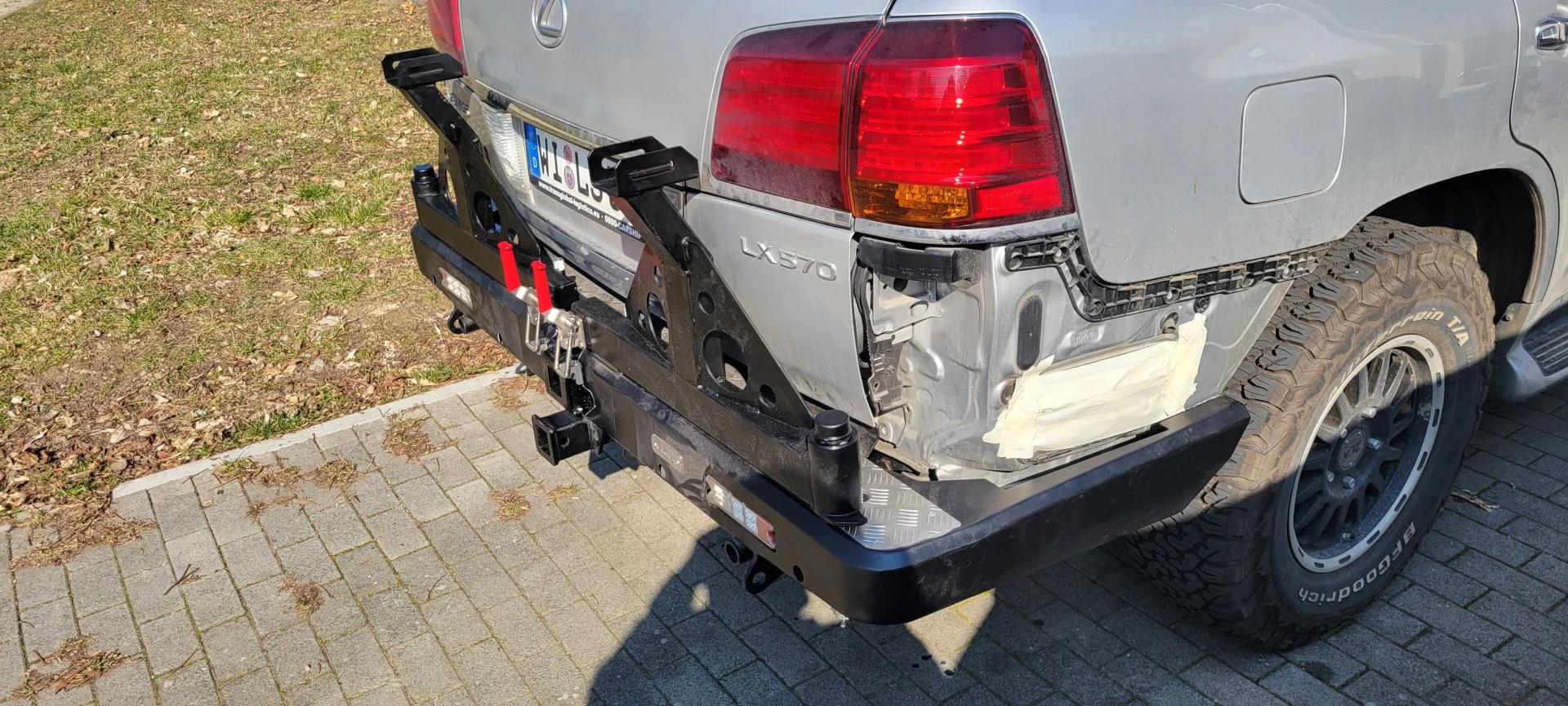

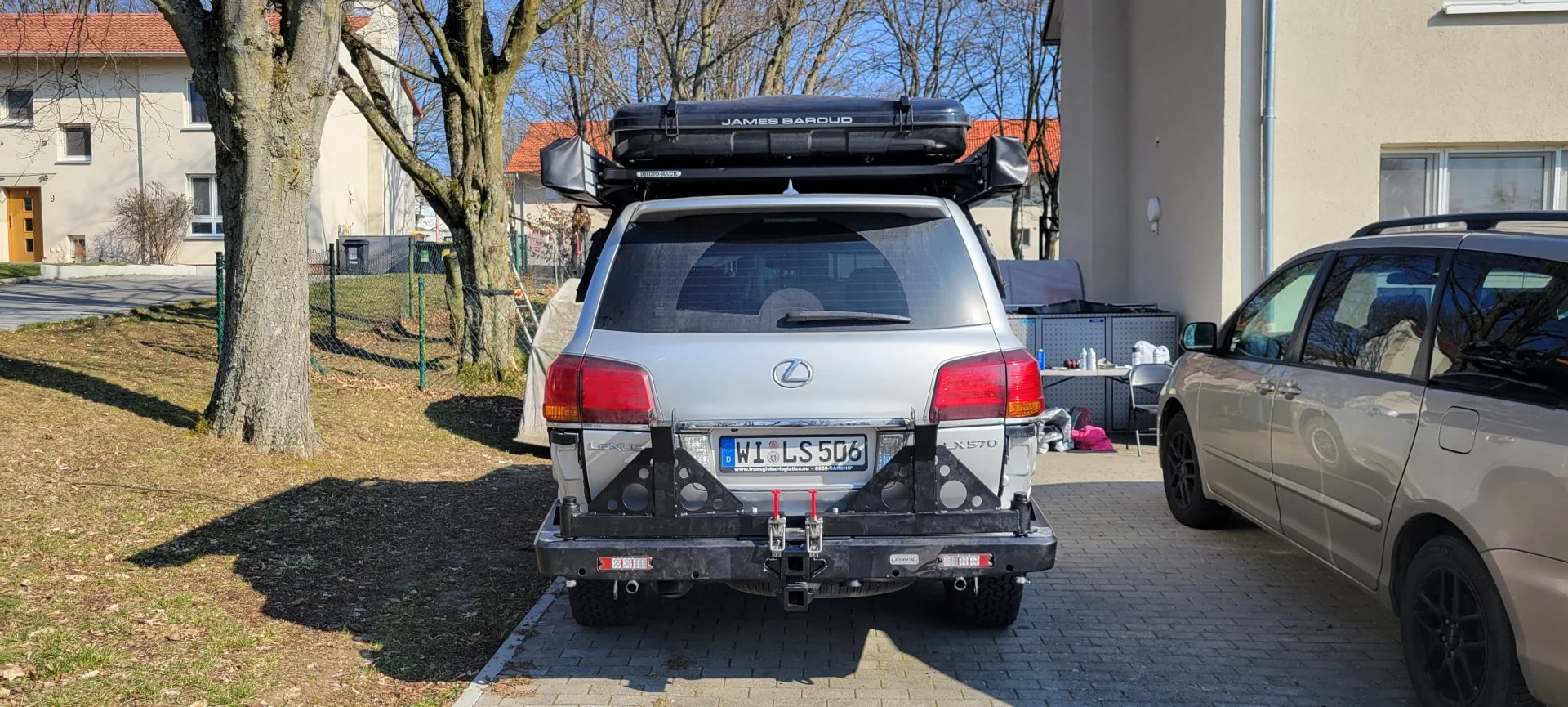

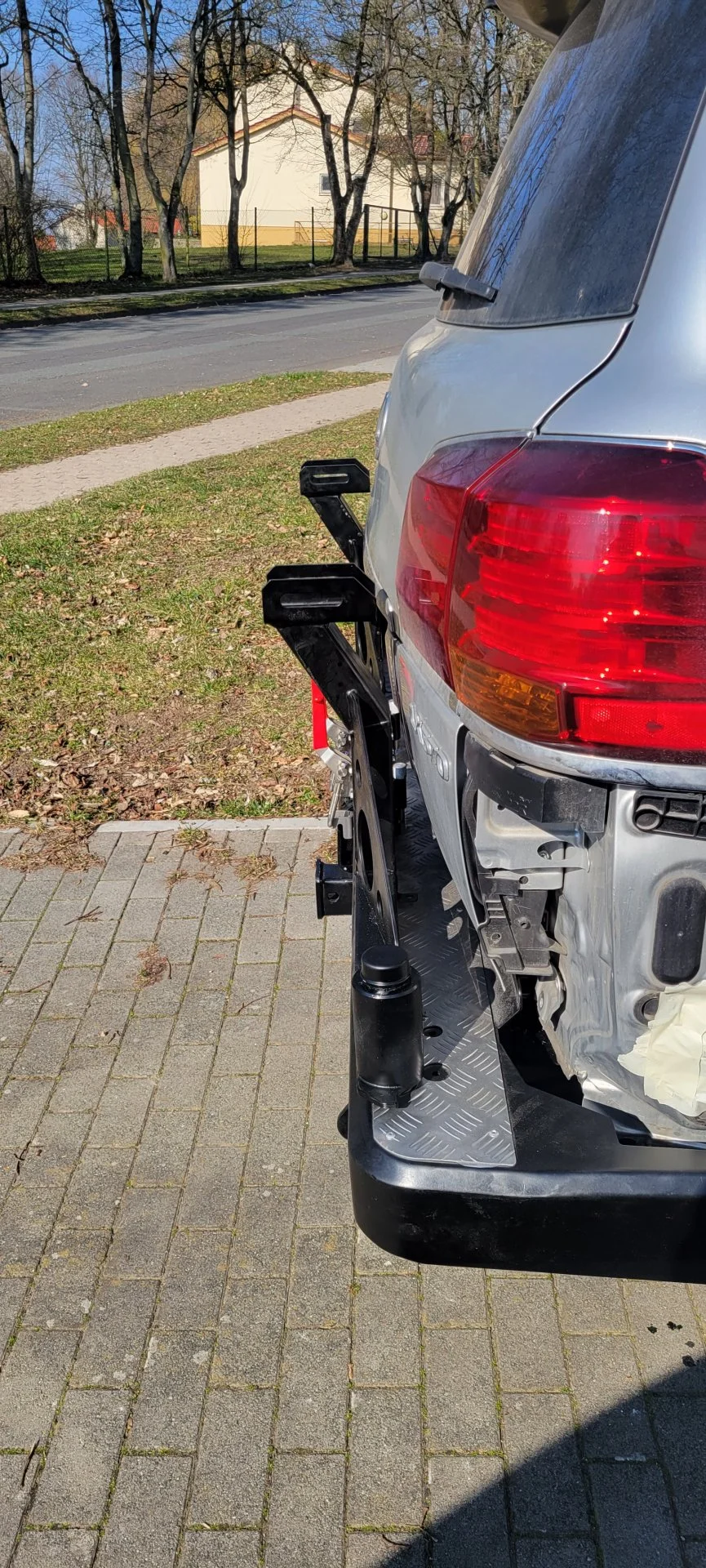

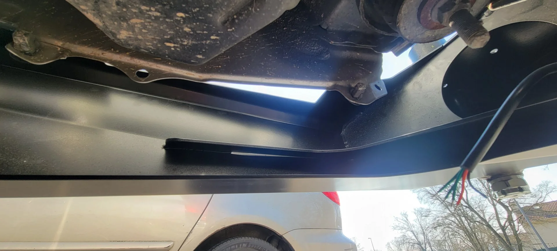

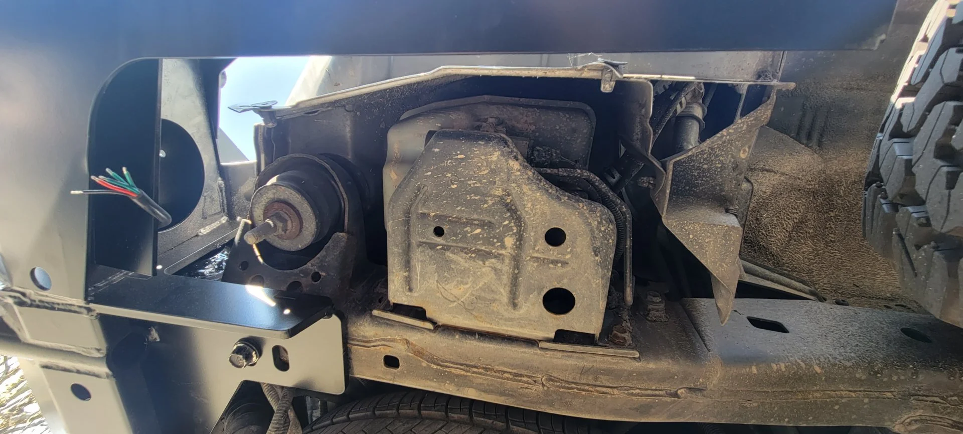

care to share some pics of your wing bracket solution at the ahc reservoir?
Sure, the short answer is that this bumper doesn't have a support bracket for the wings from the frame to the wing. I'm not an expert on bumpers or this kind of manufacturing, but I do think it is a rather special bit of kit. The entire bumper 's literally one piece of steel bent and folded into shape with internal gussets.
Now make no mistake, this bumper was not designed for the US Spec model. The Euro/African spec LC200's have AHC, but they don't have the rated tow hitch receiver. So I had to cut a hole in the bumper and modify the factory receiver to get this to fit. Desperate times call for desperate measures, beggars can't be choosers, whatever cliche you'd like to use, this is the only bumper I had access to other than the ARB which has the brackets for the wings, so this was really my only option and I made it work. Having said that, I think I would do it again regardless.
Now make no mistake, this bumper was not designed for the US Spec model. The Euro/African spec LC200's have AHC, but they don't have the rated tow hitch receiver. So I had to cut a hole in the bumper and modify the factory receiver to get this to fit. Desperate times call for desperate measures, beggars can't be choosers, whatever cliche you'd like to use, this is the only bumper I had access to other than the ARB which has the brackets for the wings, so this was really my only option and I made it work. Having said that, I think I would do it again regardless.View attachment 2943589
View attachment 2943590View attachment 2943592View attachment 2943593View attachment 2943594
Well it's pretty ideal that it is made for AHC! As you say, cutting out the tow hitch square is probably some drudgery, but not particulary 'hard'.

The bumper is a Gobi-X LC200 rear bar. They are handmade in South Africa. The website for their 200 parts is here. You can email Shane directly with questions at info@gobi-x.co.za.

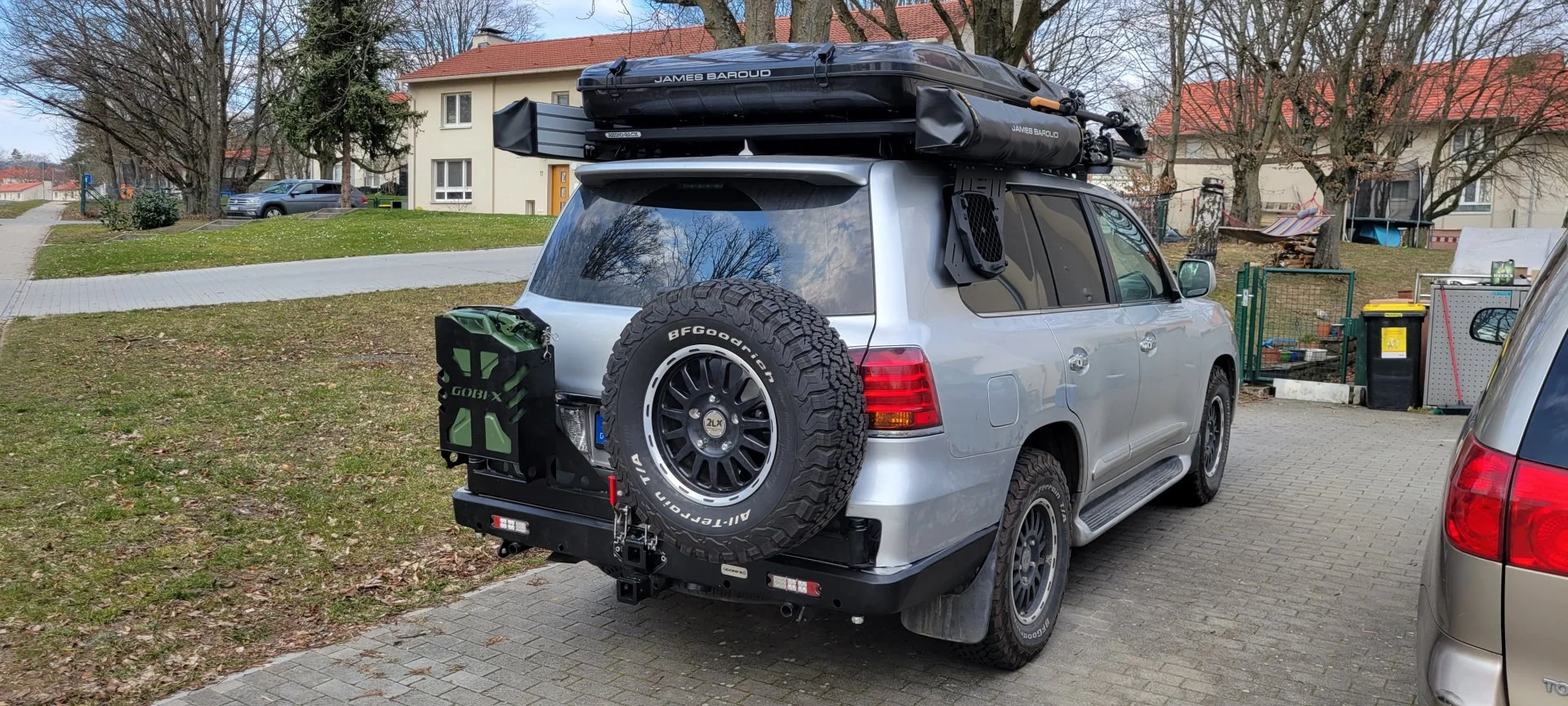

Here is a shot of the mostly final install.
She's really coming together. Looking good.
Regarding the rear bumper shell, can't tell exactly but it looks like the clearance is too tight. Not sure if you're done, but it needs something more like 1/2" clearance between the bumper shell and steel bumper as they will flex relative to each other.
