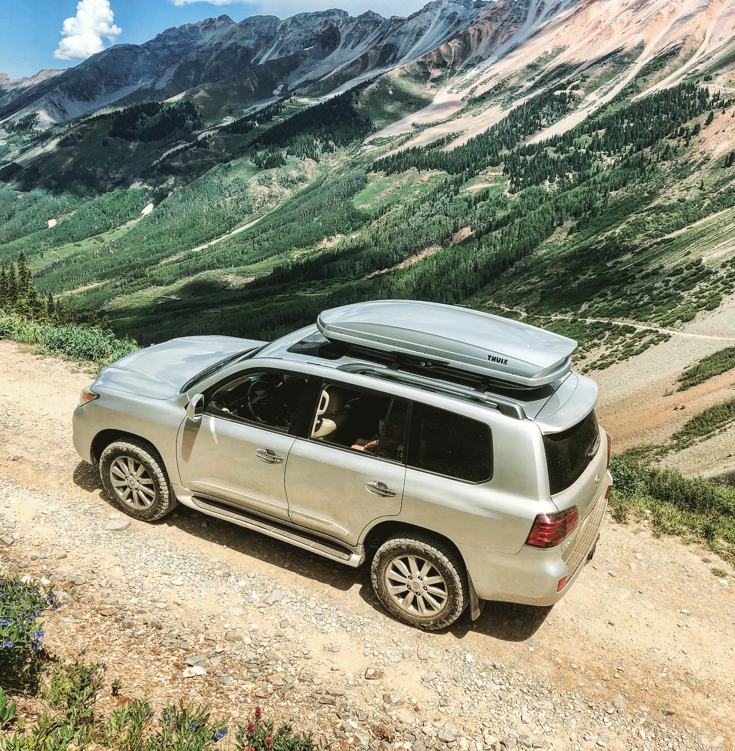

Yes! Cargo box was selected specifically for its lower profile so I can also run my WeBoost Reach antenna a few inches higher than the cargo box and still clear the garage. Top of cargo box with 35's is 92.5" garage door is 96" to the rubber weather seal and another 3/4" before I start contacting the door frame. Plan to adjust the WeBoost antenna so it just touches the weather seal. This puts most of the functional element of the antenna above the cargo box giving a 360 degree view of the horizon. I'll have it on a folding marine mount so I can jump out and flip it down if I need that extra few inches to clear a parking garage. Do you do the same with yours, or just remove it entirely when not out in the sticks?

I'm surprised you guys were able to get a roof box on without it contacting the rear spoiler! I picked up a Thule Ascent 1100 (not 100% sure, it's a few years old) but was not able to move the crossbars forward enough. Thanks to @nakman, I picked up some LC rails, which should allow use of the roof box.
Yup. That's another reason I went to the LC rack. Just not enough length with the LX rack for skis, boxes, etc. Partly because of the spoiler. My old LX470 with a similar short rack worked okay as it didn't have a spoiler.
LC rack with 3 cross bars works great and has handled everything I need. While keeping stock aero and no additional noise.
How it should have come from the factory.

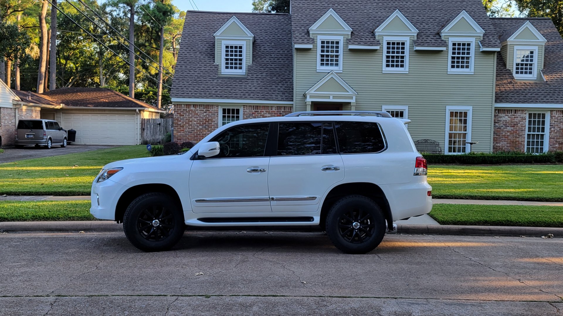

Thank you both. Looking forward to learning a lot more on here. And just to keep this thread on topic, here’s a new to me 2016 LX with 44k miles and a meticulous service history via the Carfax. Was just picked up by the transporter earlier today in Houston and should be delivered to me by the end of the week.
