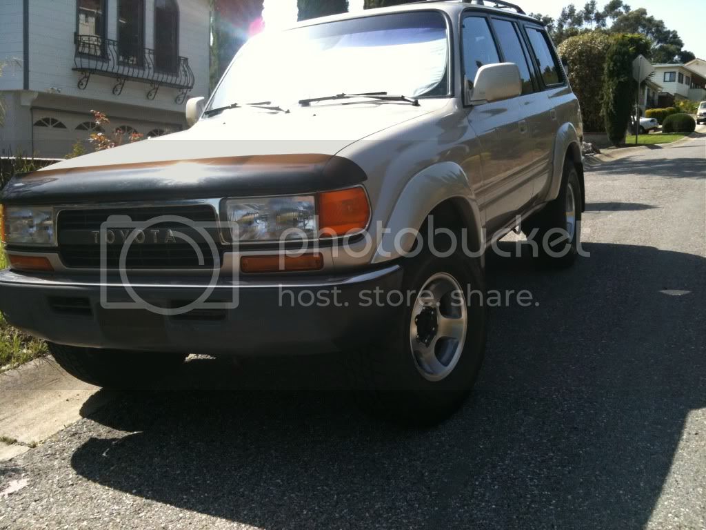

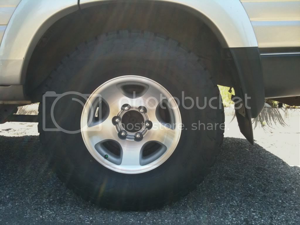

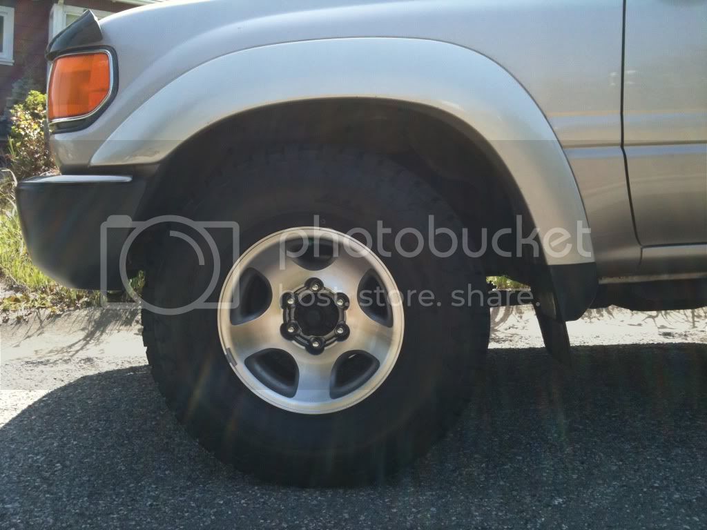

btw, here's the height of the tank currently on 135k suspension:
A little taller and improved cornering performance and I will be one happy camper :D
