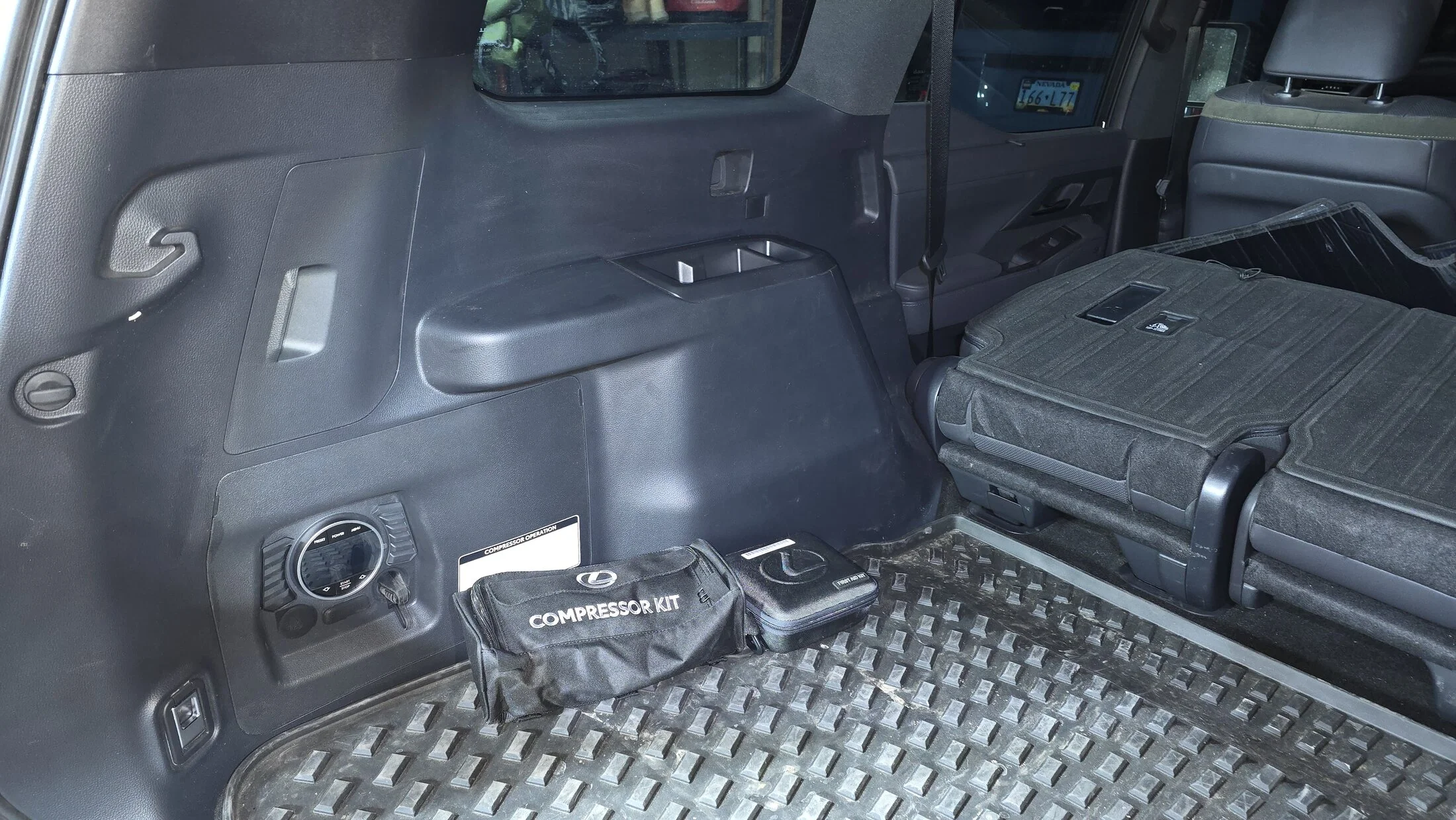

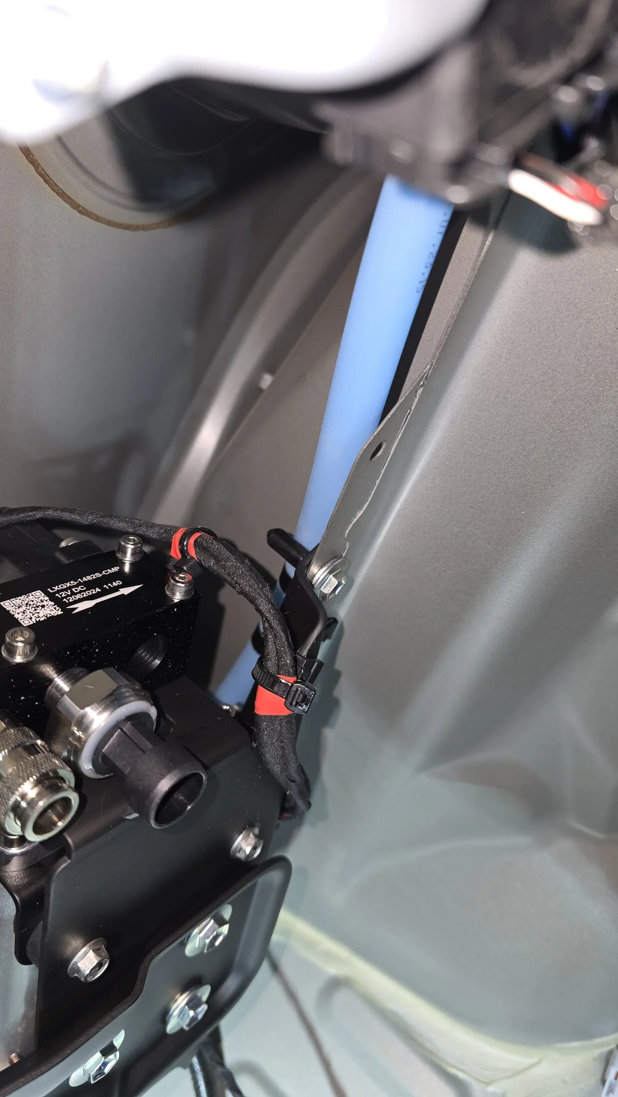

I did a full test this afternoon. I typically air down to 24psi over here, took 6.5 min to air back up all 4 tires to 35psi.

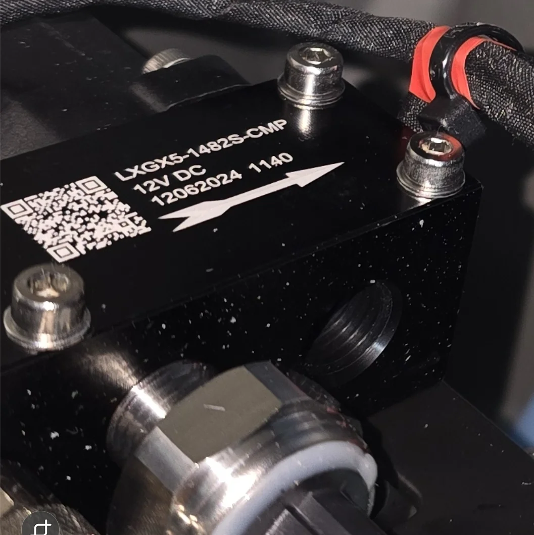

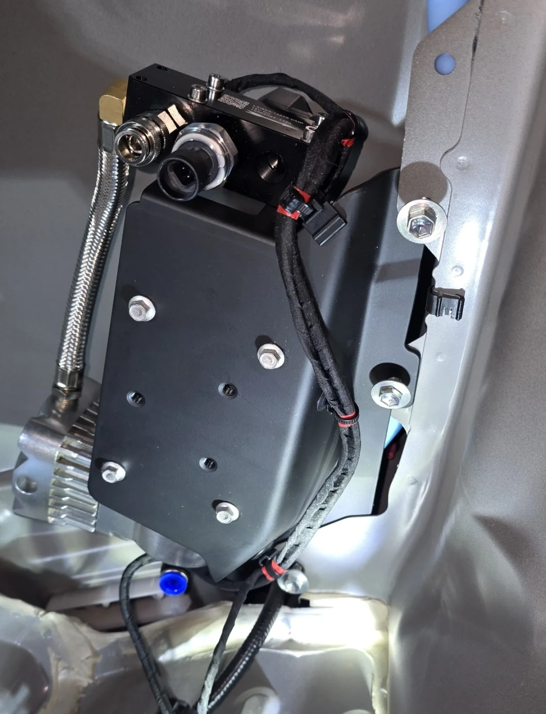

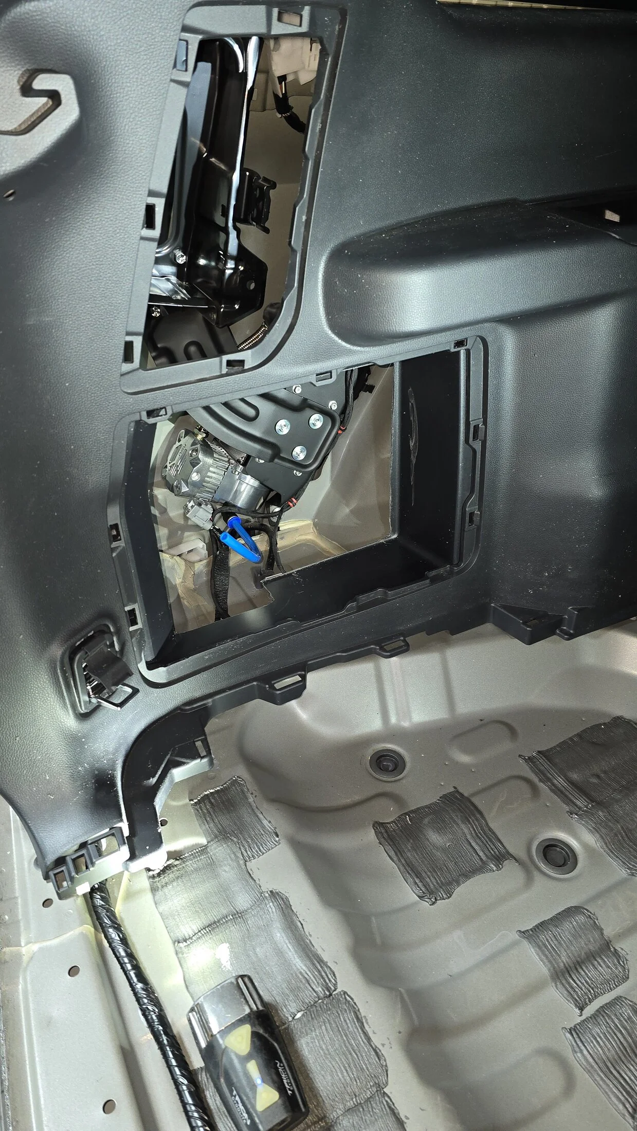

Placement doesn't seem as immediately obvious as the GX, but there seems to be plenty of space behind the interior paneling. Is that a manifold on the compressor body?

Yeah, the manifold.

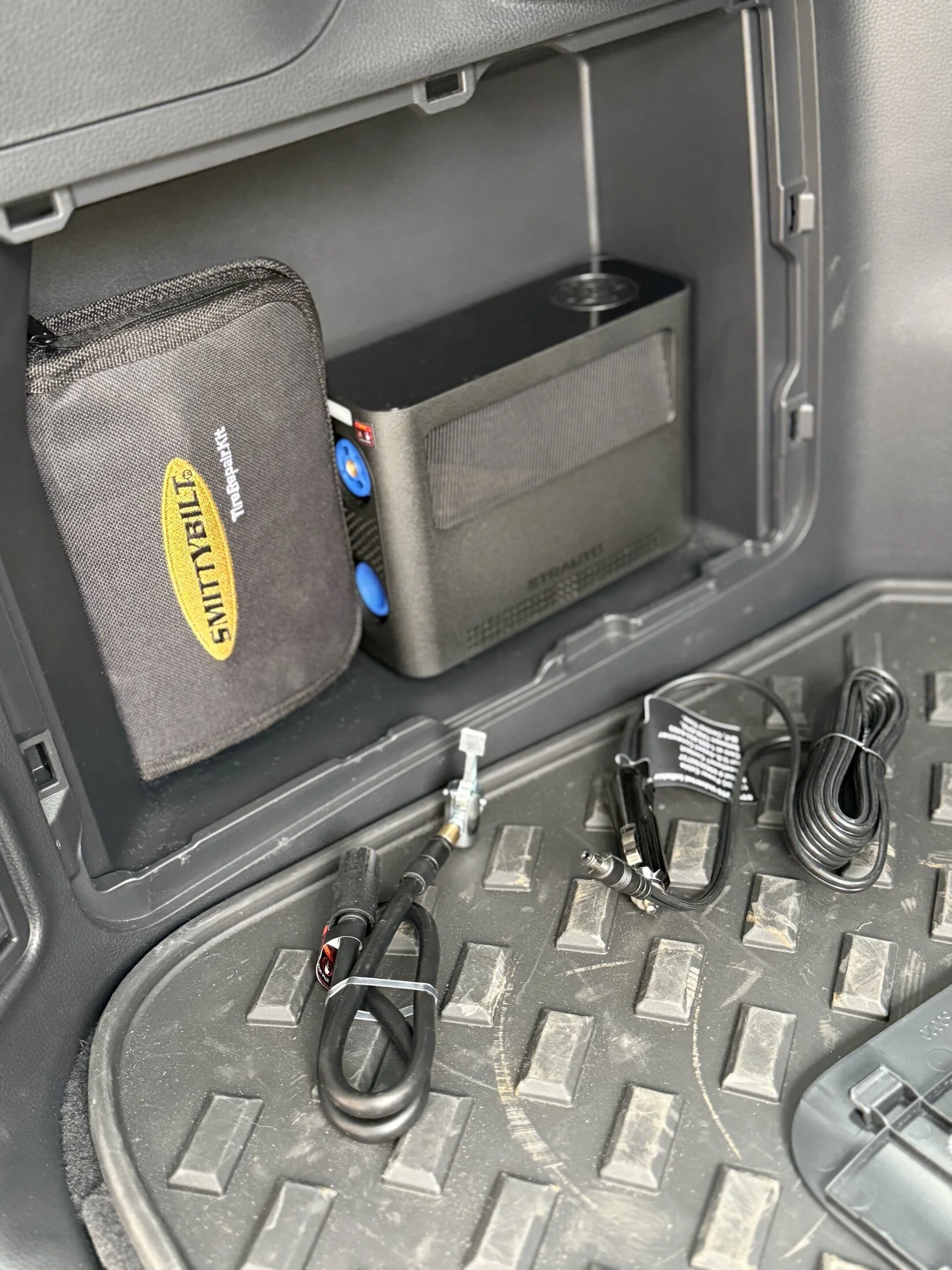

Here is my cheap-o interim alternative for air with me when I don’t have my Milwaukee inflator or until I step up to integrated air like OP.
~$90 at costco, battery powered, fits in the side cubby. I hope it’s battery doesn’t short out and burn my truck to the ground.

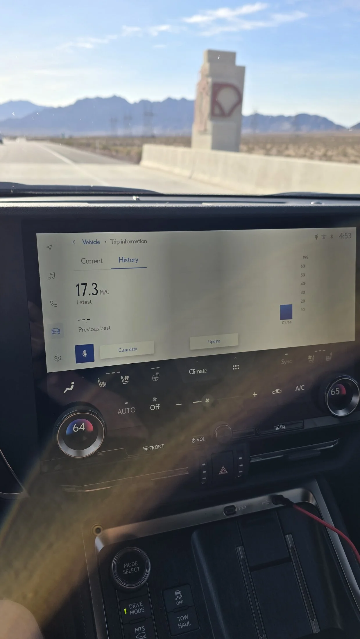

7,500mi and averaging 17.3 mpg overall since purchase on my 24 OT+
