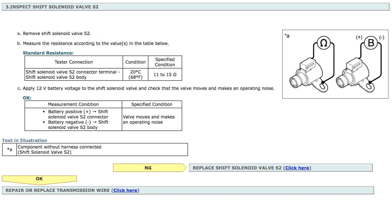

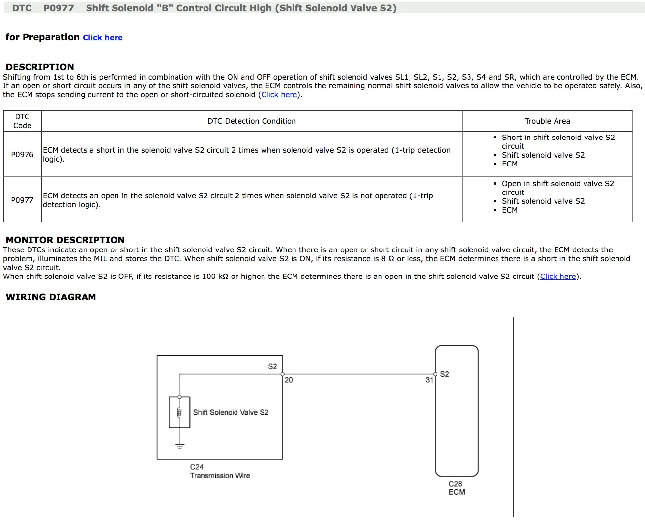

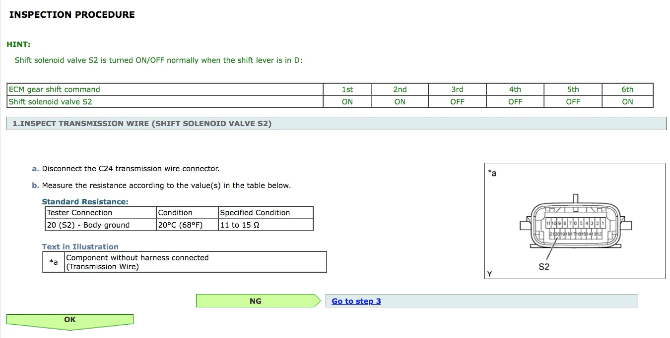

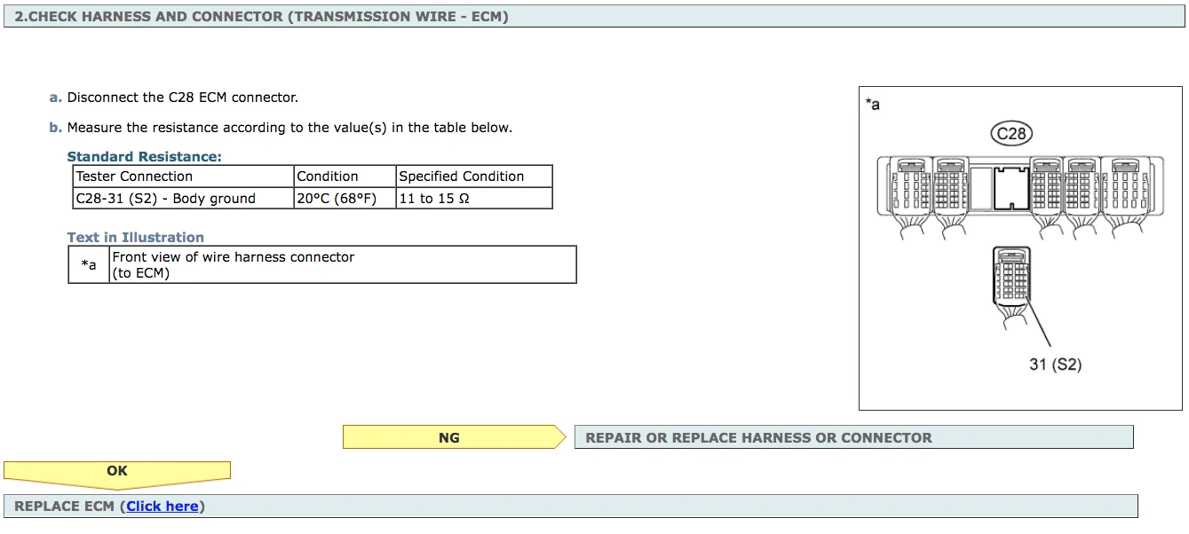

ECU replacement is part of the FSM flowchart
