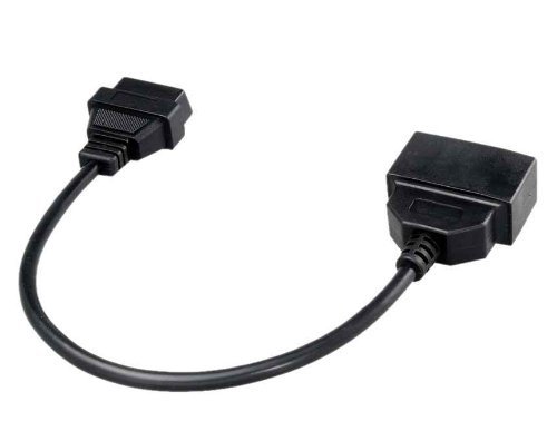

There are other, cheaper.. OBD2 scanners that will read Asian vehicles or Toyotas, but OBD 2. I was wondering what info these would read if we used this $8 , 22-pin OBD1 to 16-pin OBD2 connector cable?
Amazon.com: e-Joy® Connector Diagnostic Adapter 22 Pin Male to OBD 16 Pin Female for Toyota (Black): Home Audio & Theater
