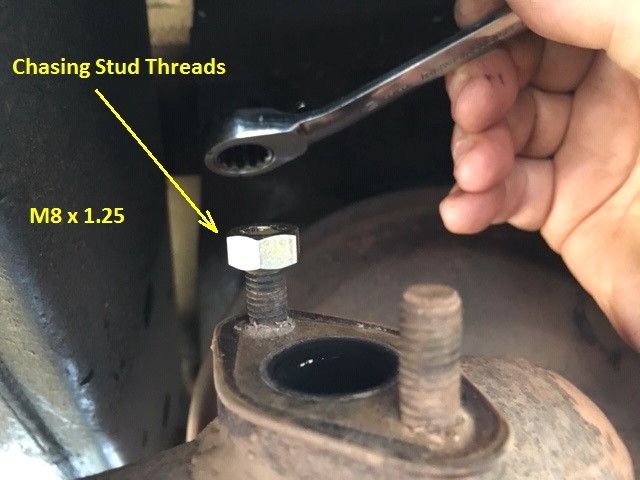

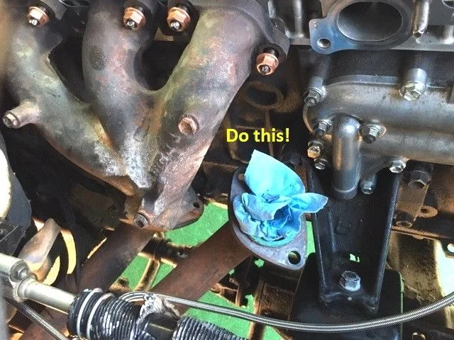

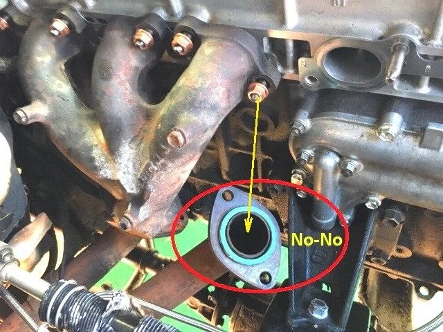

Soak the studs down real well the night before. Take your time removing the old nuts.....especially if you are in the rust belt or an area where they salt the roads in the winter. You don't want to bugger up the threads. Then 'chase' the threads before installing the new O2's.

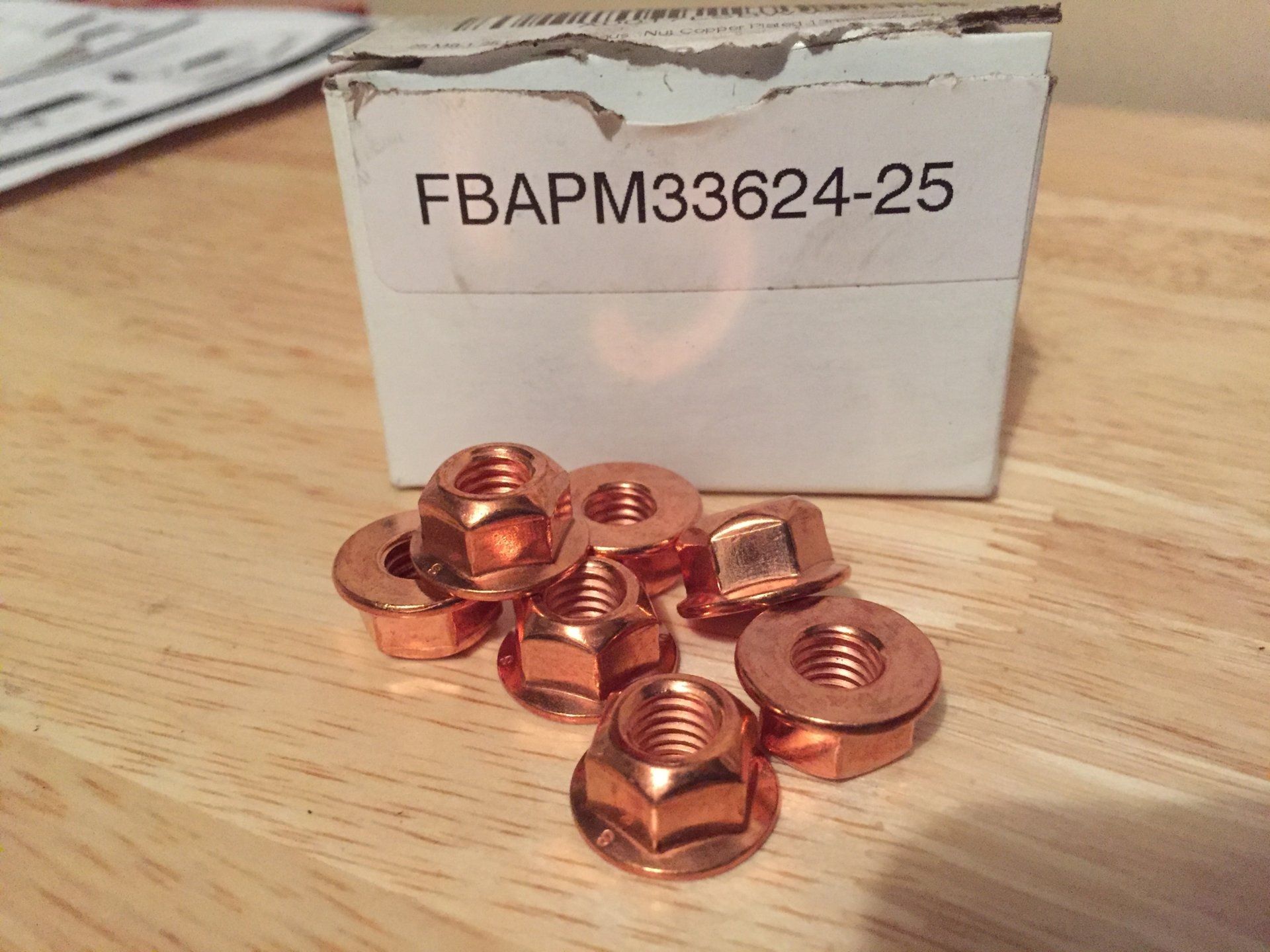

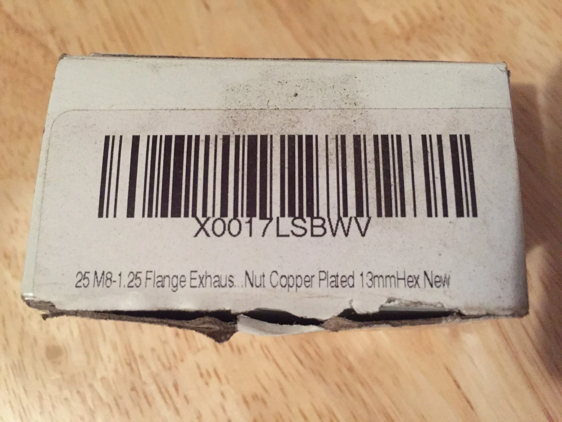

I use copper nuts on my O2 sensors....easy off, no fuss
My sensors should get here today and I’ll confirm they include the gaskets. Great idea on the copper nuts. I’ll order them now!

Here's a pic of mine
