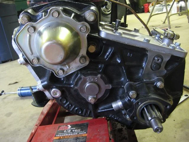

Mine is #493. I had a few issues getting it all together and I used about 5 different cases for parts so all of the internals are almost as good as new. It will be a 10 spline input w/ a fine spline main shaft (post 75ish) and a stock Ft output. It is a 4:1 case and the High speed gear that they sent me didnt want to slide over the main shaft without some serious honing.
I used a stock thrust washer on the high speed side and a stepped washer on the low speed side.
I used a OEM shift Fork(clearenced) and collar w/ the OEM Rail and AA detent ball and spring.
Also in the process of disassembling 5 different t-cases from 71-77 I came across a few interesting differences in the cases. Some of the Shift forks were cast differently and the collars were a bit different. All of the parts looked dimensionally the same and function the same but some just looked a bit "updated" and the older parts looked a bit crude by comparison.
Also the shift collars are not the same front to back so if it is installed backwards (which would be easy to do) it would cause all kinds of strange shifting problems.
Well my #493 is going behind a 5.0 and a NP435

we had broken the front output on the first orion i ever built ( years ago ..... ) screwing around and were really bummed out about it. that particular case was/is an early production model. it has never popped out of gear, ever. and we beat the snot out of it every chance we get. so taking it apart was a little nerve-wrecking since we did'nt want to "disturb" anything. turns out it still works great. we had it at the roundup in TX, beat it like a red-heahded stepchild and it's still never popped out of gear. good times.
Just picked up an Orion case yesterday (will go behind a 465). Case # 459 with 4:1 ratio. Should have it installed in the cruiser in the next month.
Will report back on any issues then.
