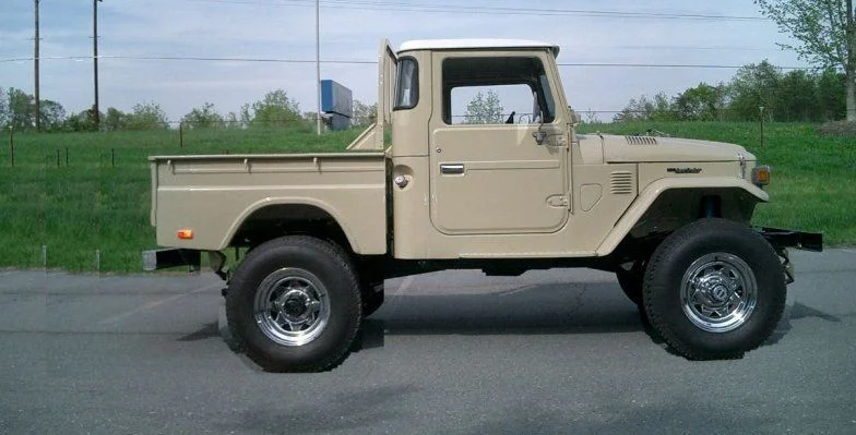

there were a few reasons for shortening the bed: 1) the frame I had was a shortbed frame but the bed I had was a long bed. 2) I like the look of the long bed box better than a short bed which always looked to me like a modified 40 tub.
I could have just shortened the front (as I have seen others do), but I didnt find that visually pleasing apect ratio wise. Plus I intend to actually wheel it, so I wanted a pretty agressive departure angle, and the long bed in its original form is WAY too long in the rear so I made it what I consider visually pleasing, but still good departure.
Besides... why should the bed not get heavily modified like every other stinking peice of the truck. "in for a penny, in for a pound", that's my motto on this one.
Back when I first got started I photo shopped up what I wanted the end result to look like from a photo of another rig... here is what I envisioned. I think I did a not bad job of acheiving that.
