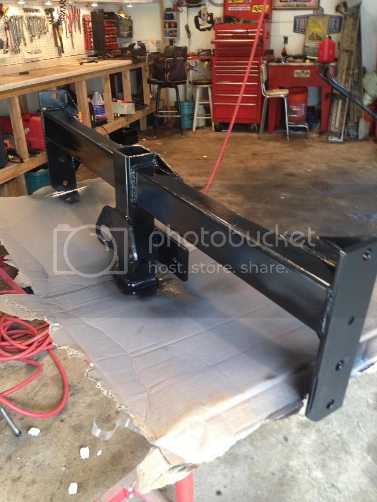

I used a home made press brake in a home made press. Otherwise I only have a 30" brake, but I can't wait until I can get a box and pan, or a tig, or , or , or......etc
Final test fit this weekend. Ill post up some pigs of the hitch.... its stout, well designed and built....

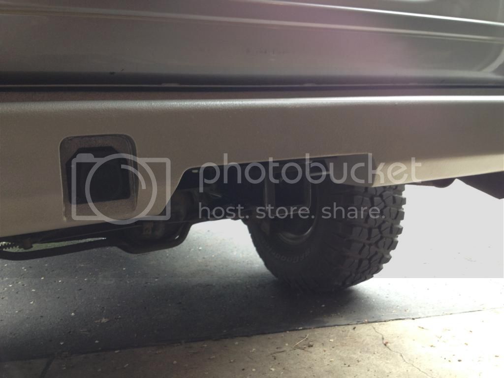

Finished up the hitch install Sunday.
Paint..
Hitch mounts up in the frame rails. Frame was sleeved. huge bolts..

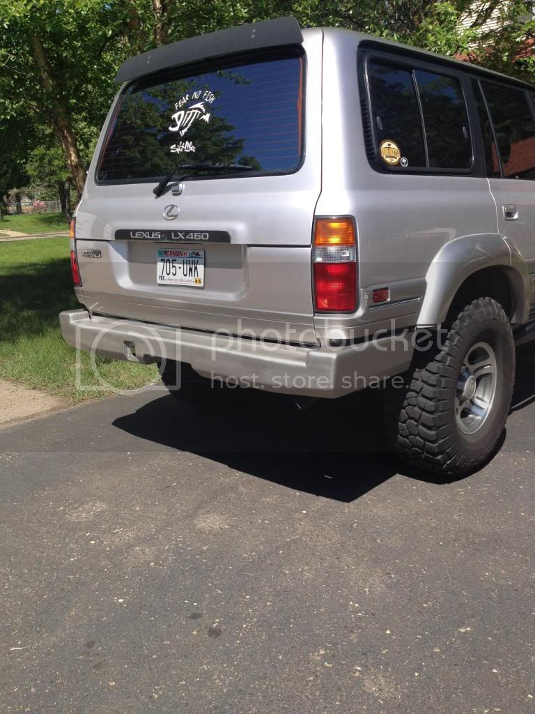

Finished look after 7 pin install
Very happy with how it all turned out. Retained the stock look, very stout.
Wow, I really like the way this turned out! I would definitely be interested in something like this if @LAME decided to sell a kit.
I would love to retain my factory mudflaps and hopefully have them sorta look like they fit though. Looks like you left just enough room on the corners to put a pivot for a swingout if you ever decided to go that route?
Great work. Looks very oem but will sure take a better beating
I like the stock look! Also cool loomis sticker, guess you use them for surf fishing?
