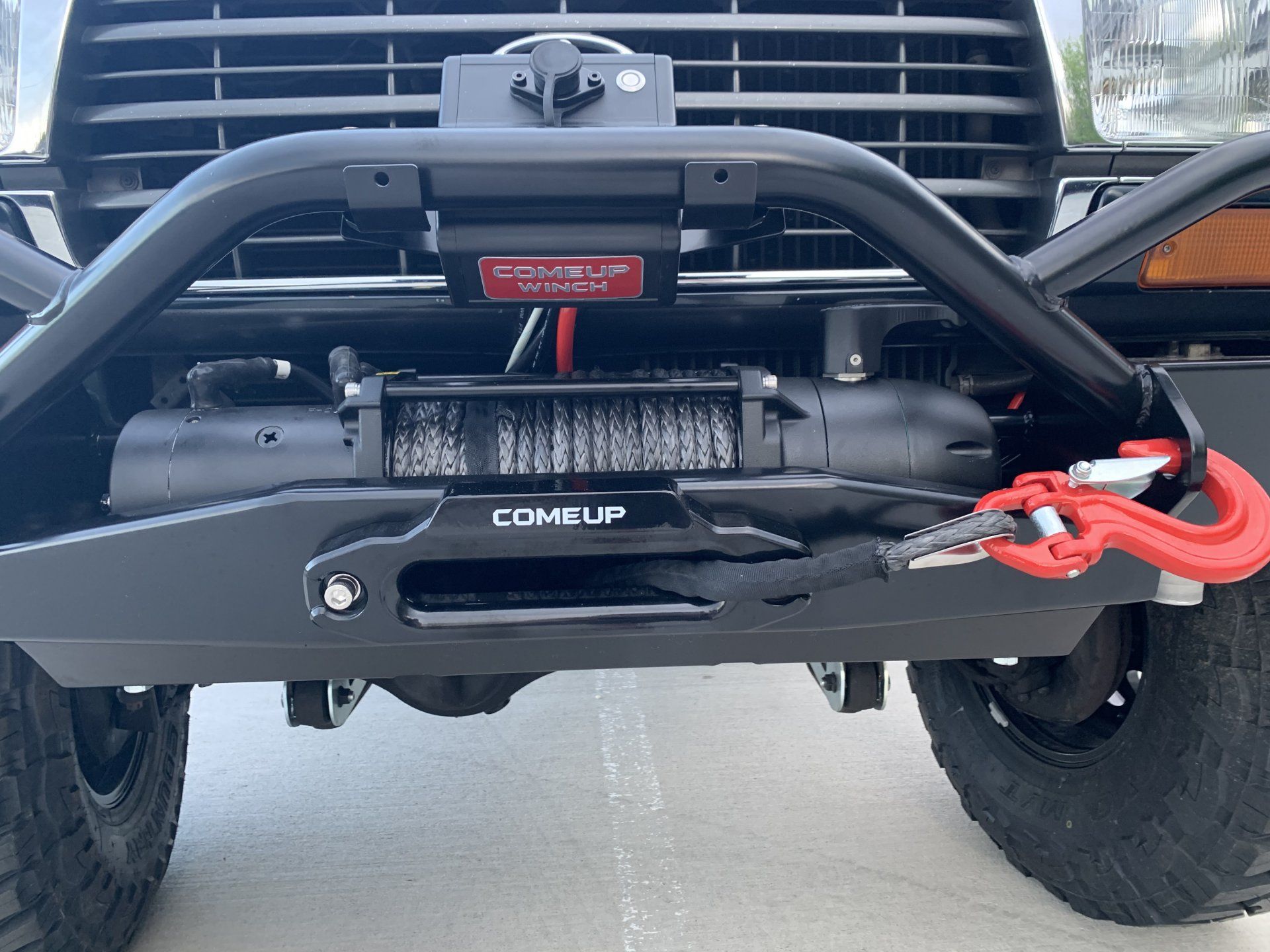

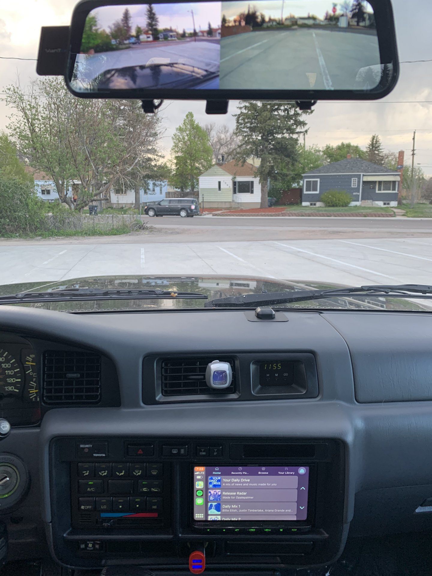

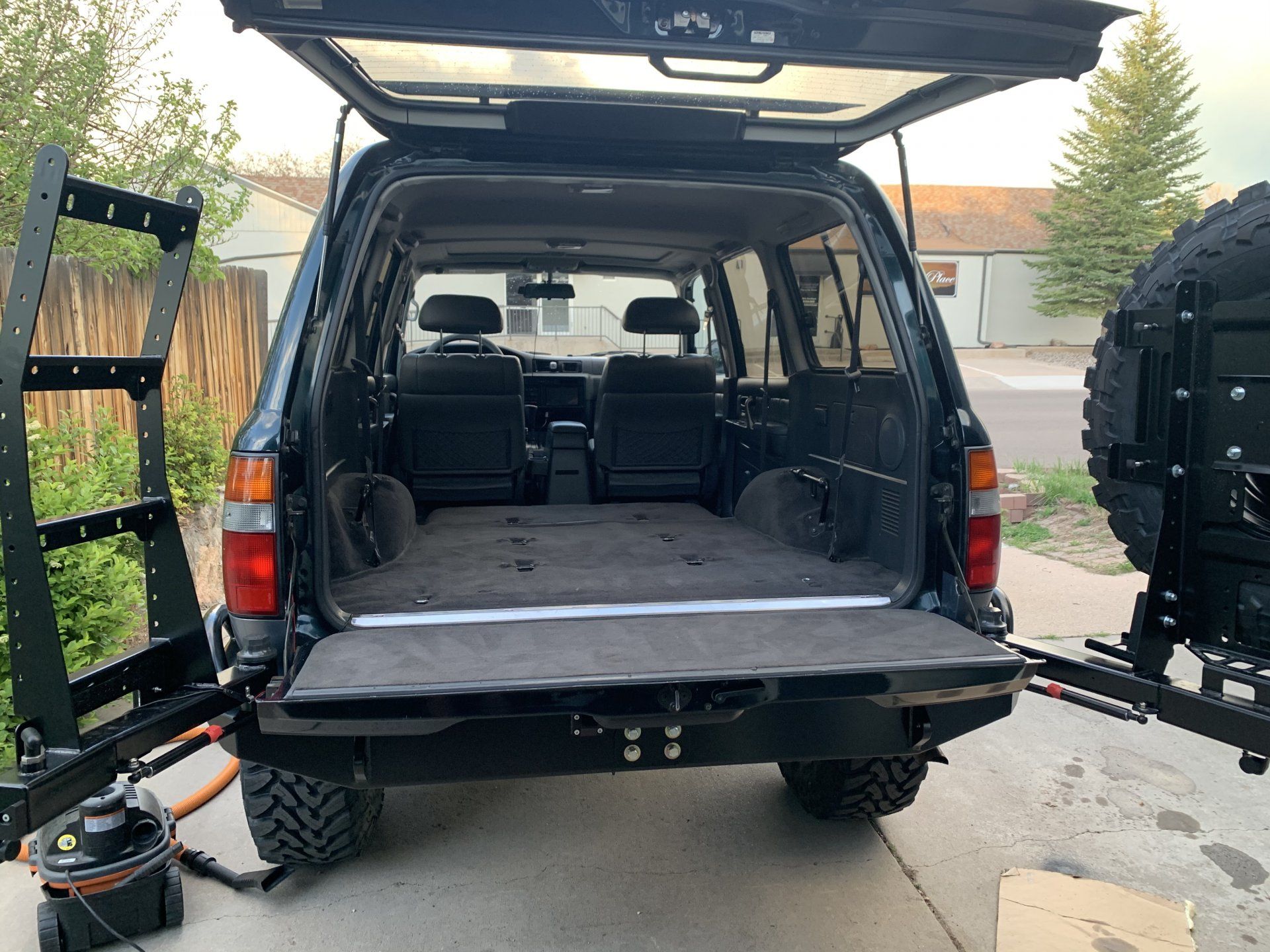

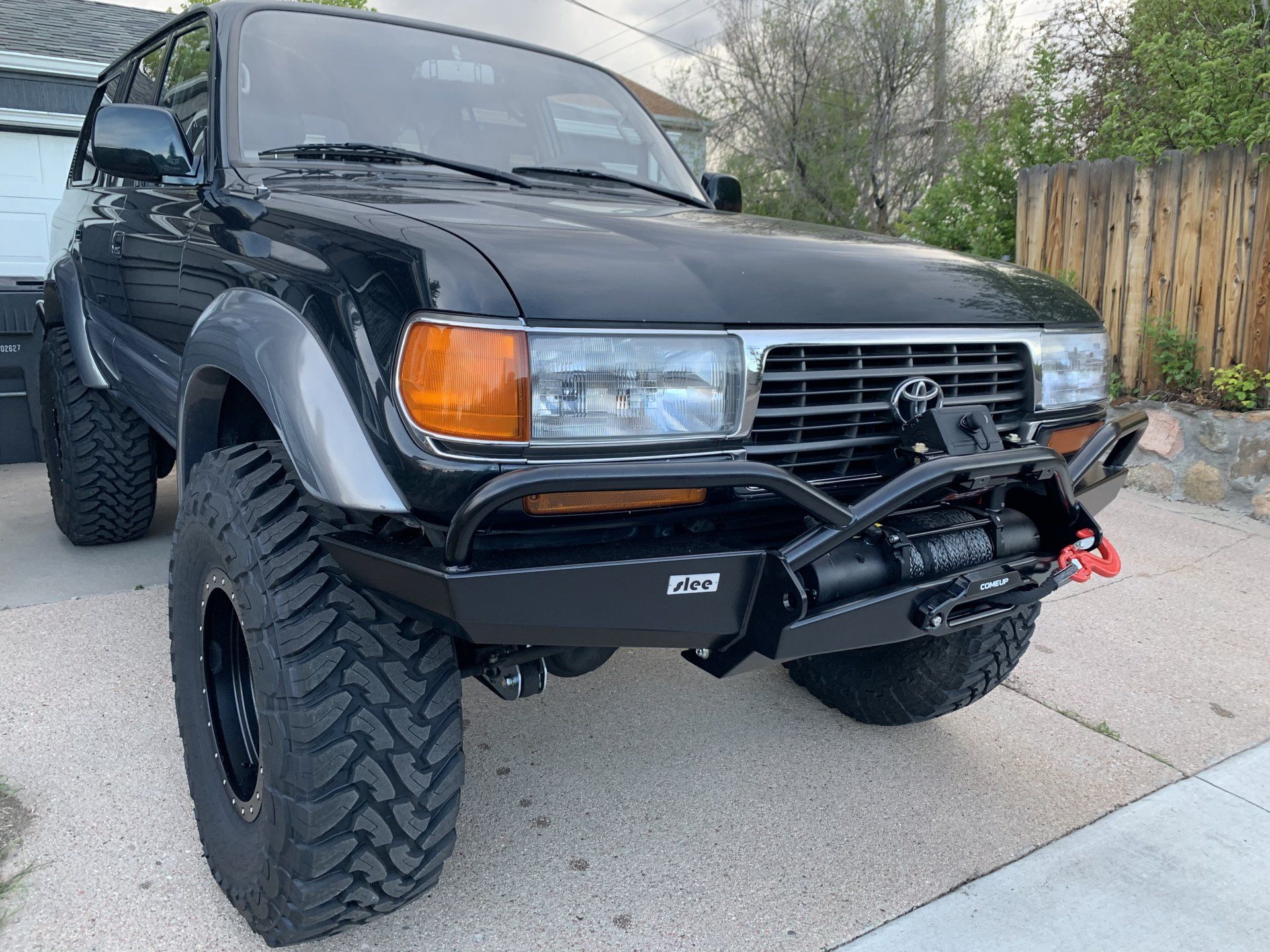

Buncha little stuff today. Removed all back seats, wired up rear camera to mirror, plate light on bumper, updated radio firmware. Tomorrow the winch goes on

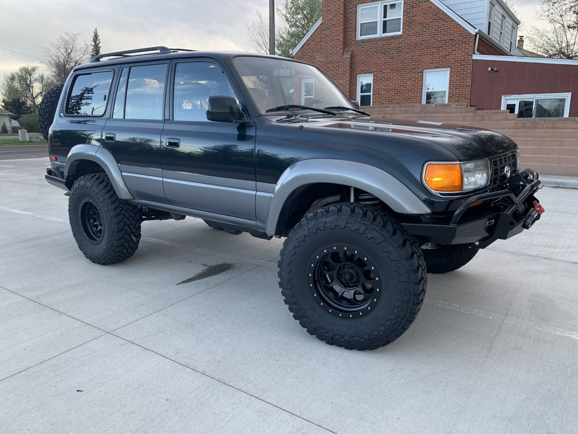

That is one very sweet looking truck. The paint looks immaculate. Why cover it up with white?
Not fond of green or two tone, paint is in decent shape now but white hides the inevitable pin stripe scratches better :)
Don't expect to repaint any time soon, already spending a butt load on this thing

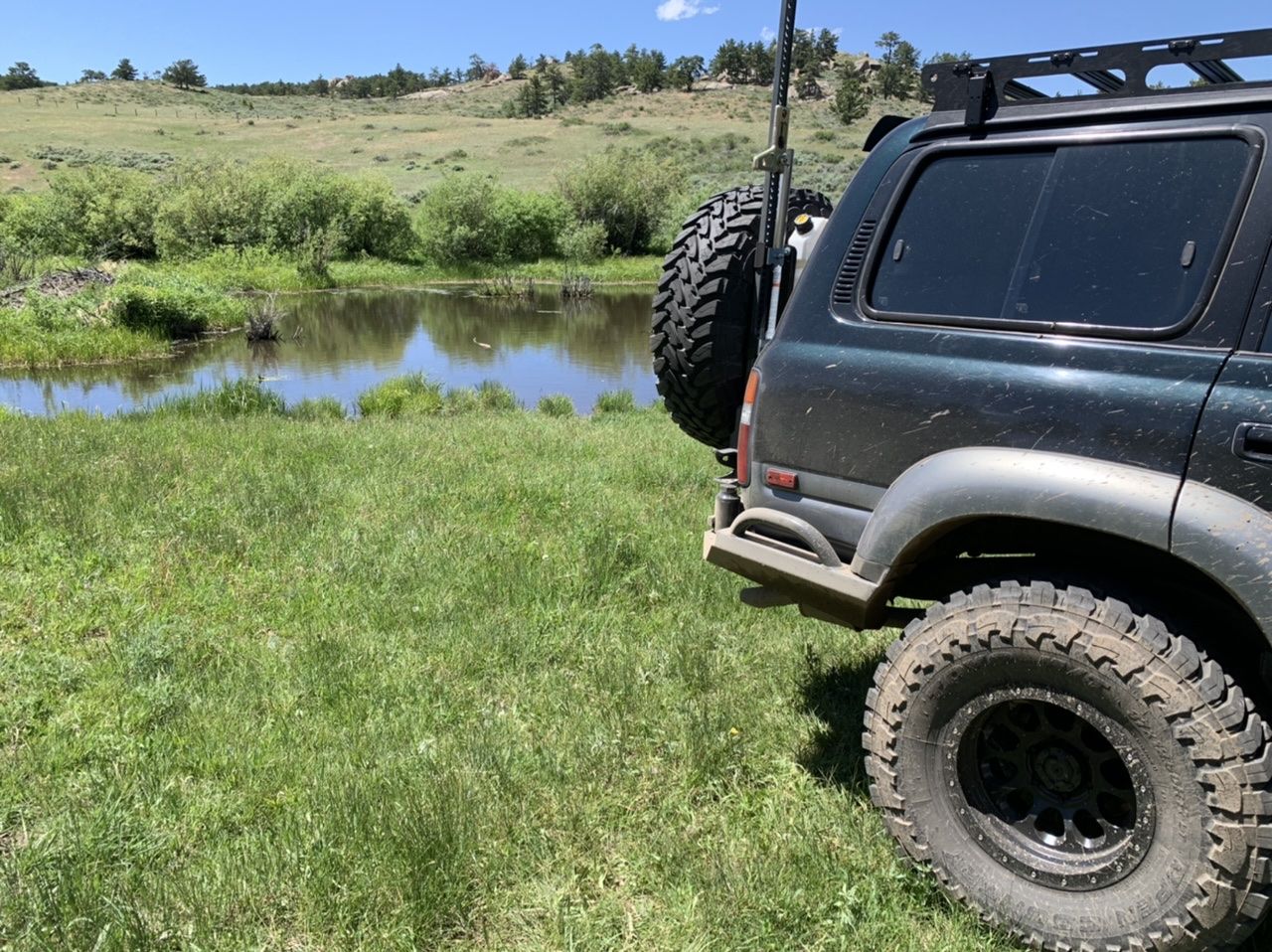

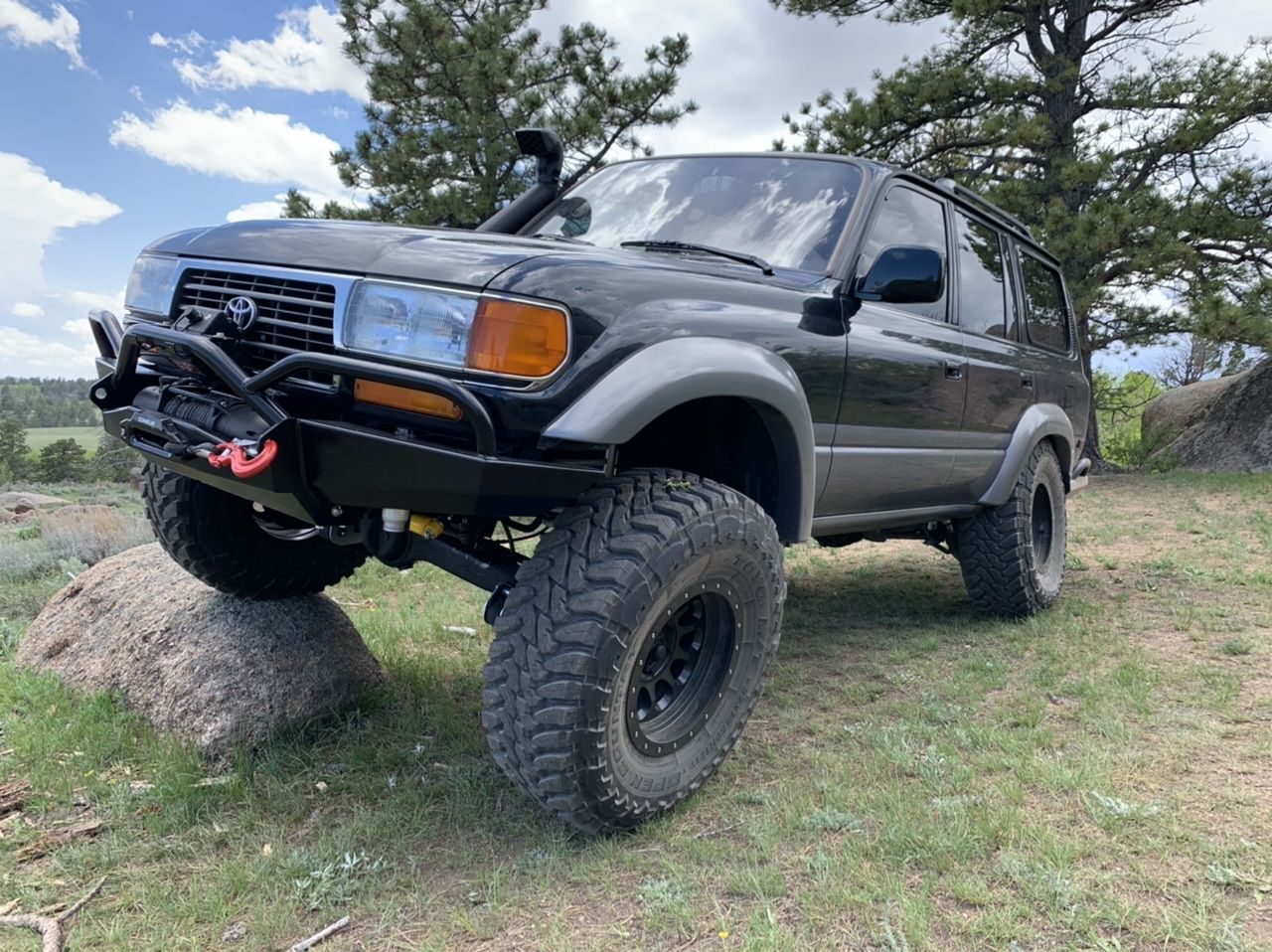

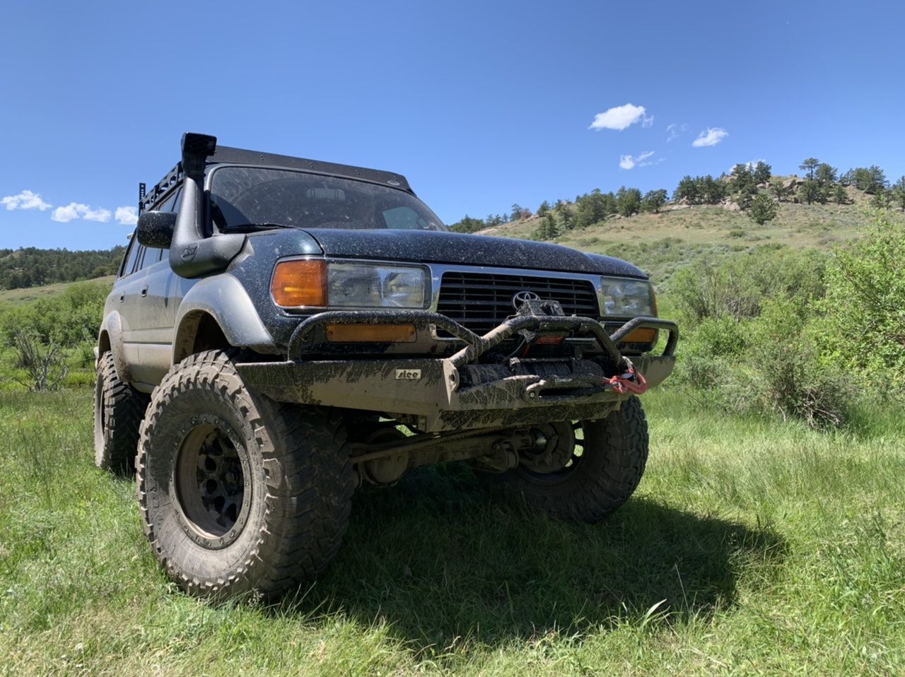

First time off-road since mods, seeing where I'm at with flex. It's stuffing pretty good but does need a tiny bit of rear trimming, anything rough would pop a flare. Gotta admit I'm pretty pleased with slee lift so far, feels more comfortable and less firm than my last couple set of Kings on other rigs.

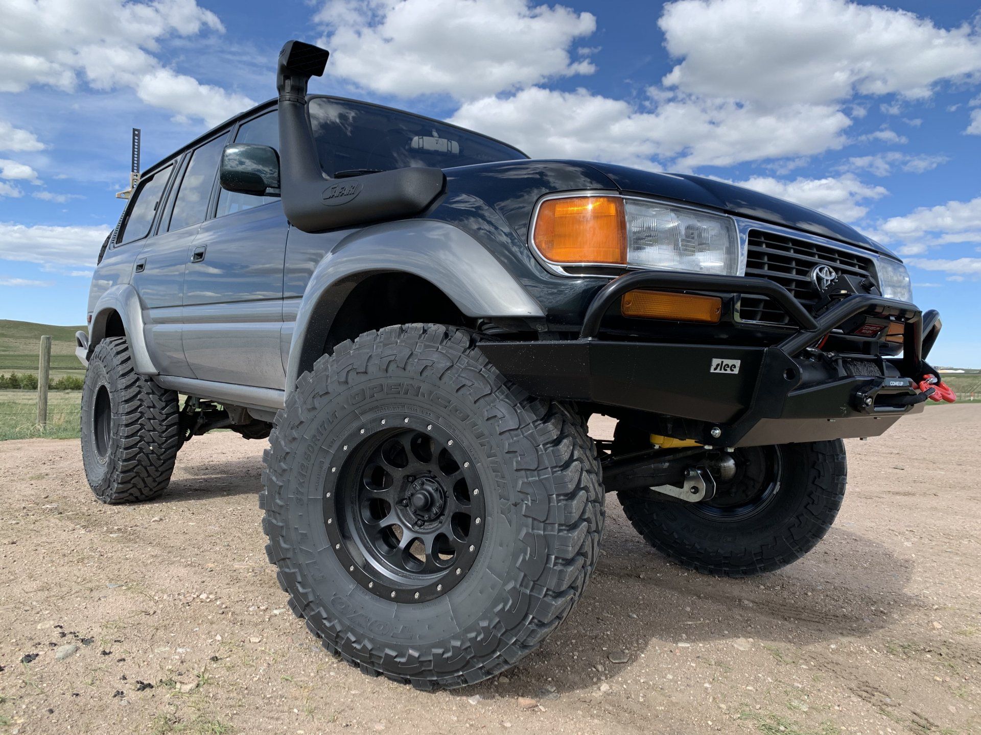

Dialed in the panhards to perfection today, flex testing was pointless after I noticed dogwalking down the road :rolleyes: I was off by quite a bit and had to adjust drag link also. Now she's straight as an arrow.

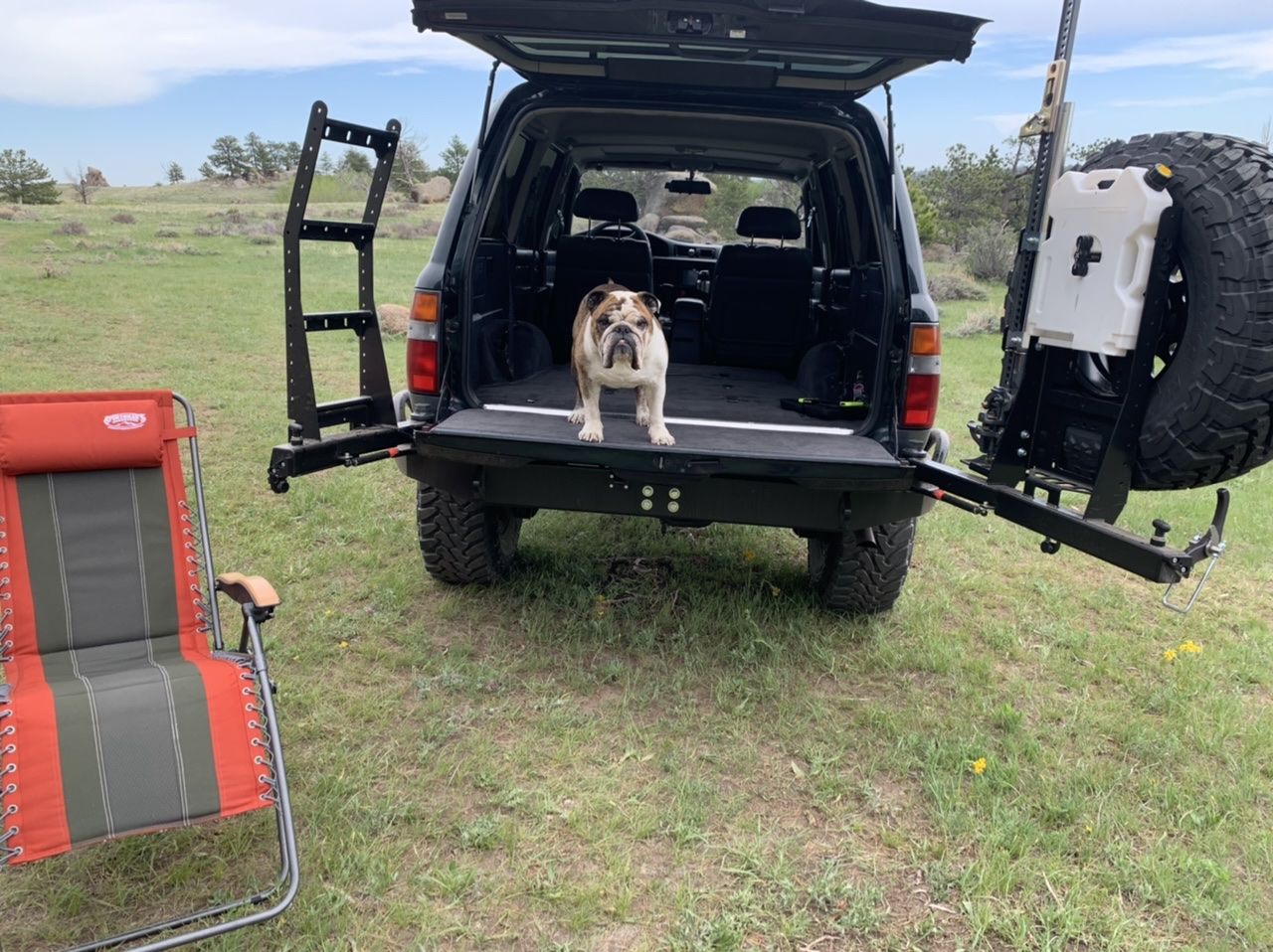

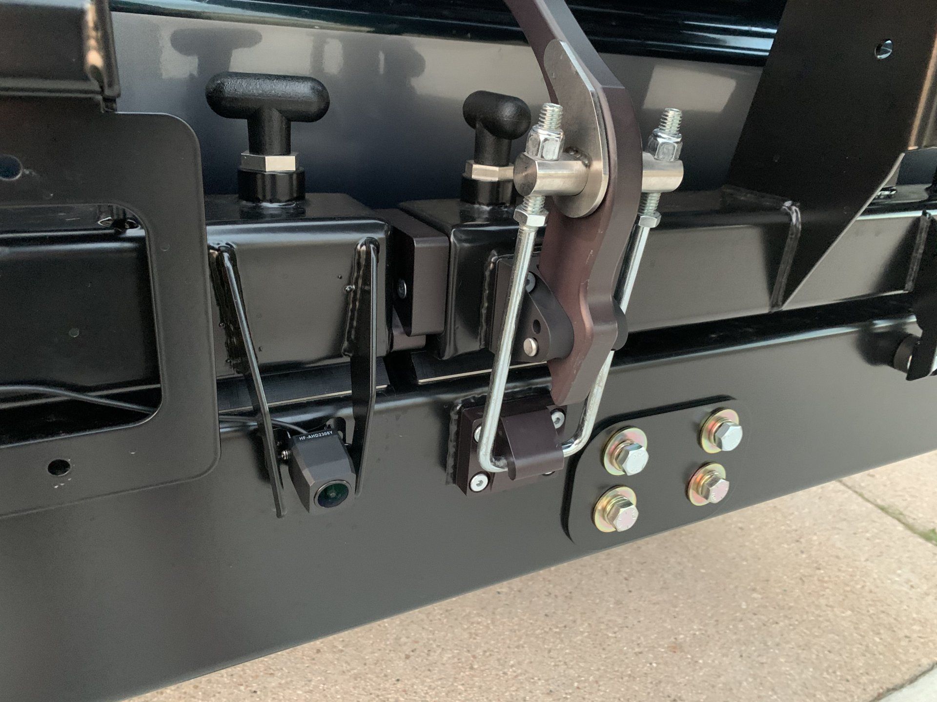

Having trouble with the slee rear bumper, weight on spare arm causes abnormal arm angle with unlatching and shake. Counting on those guys to help me out but I wonder if anyone else had issues with theirs

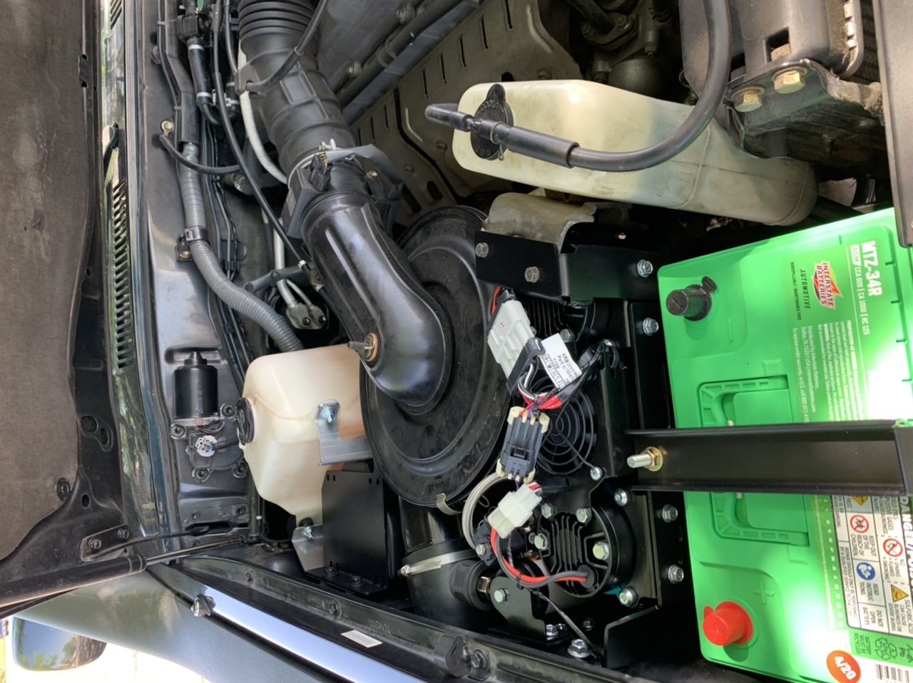

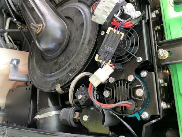

Slee installed a prototype battery/redarc/dual compressor mount, Jackson/Brian and the crew did a great job getting me sorted.
Also got a replacement rear bumper on, regeared to 5.29s, added lockers, cdl switch, and fixed some of my carelessness! The rig is feeling sooo good with the gears.
Installed the bowfin as well, even being so similar to my last Prinsu it's still much better quality. Thanks @dogfishlake !
