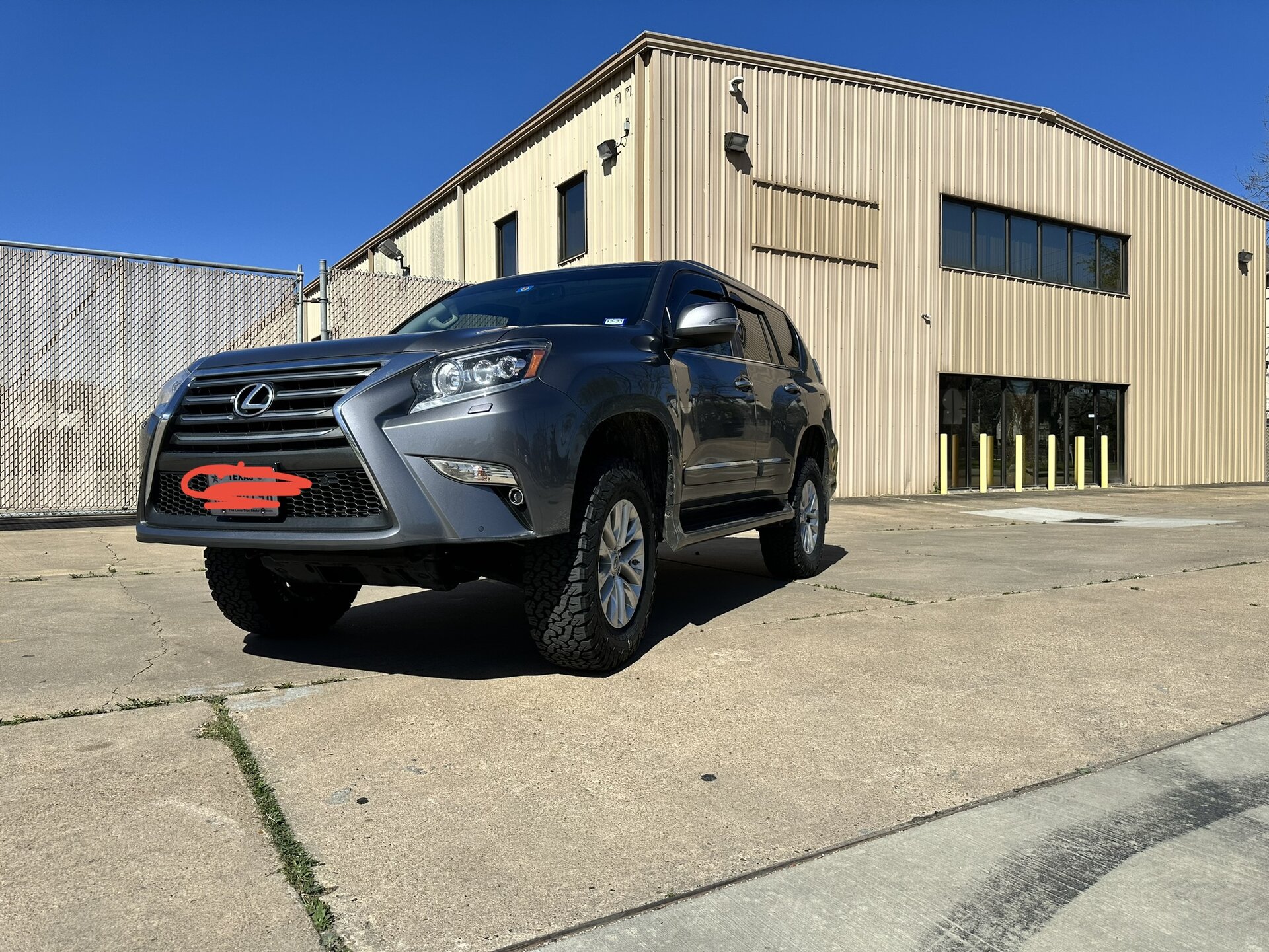

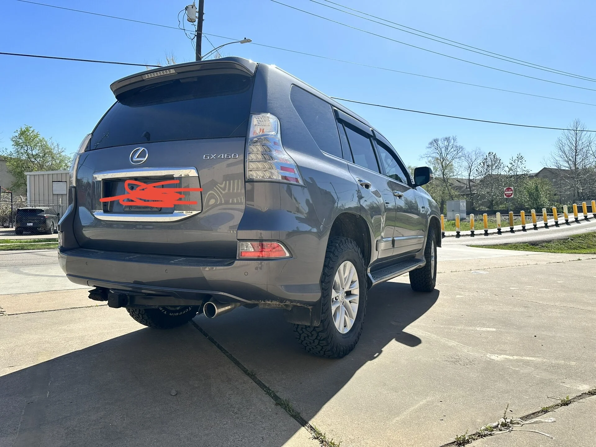

2019 GX460. 25k miles. Located in Houston.
No frills, yet.

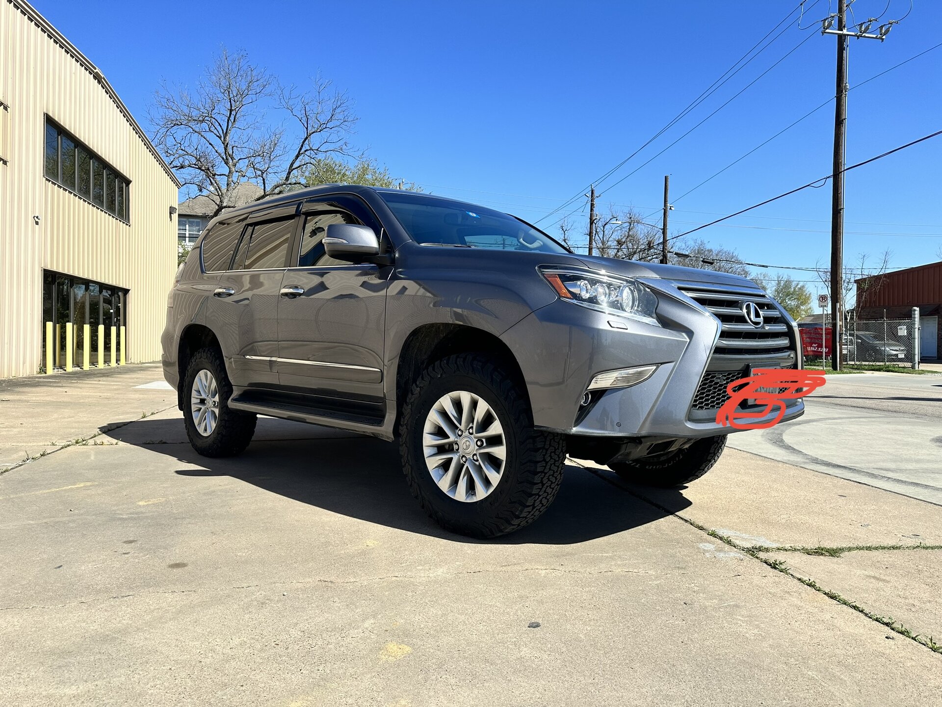

Plans... well, of course. :D
Got the Ironman FCP lift in the garage, Magnaflow exhaust on order, and patiently awaiting a reply from the folks over @ RCI on their sliders.

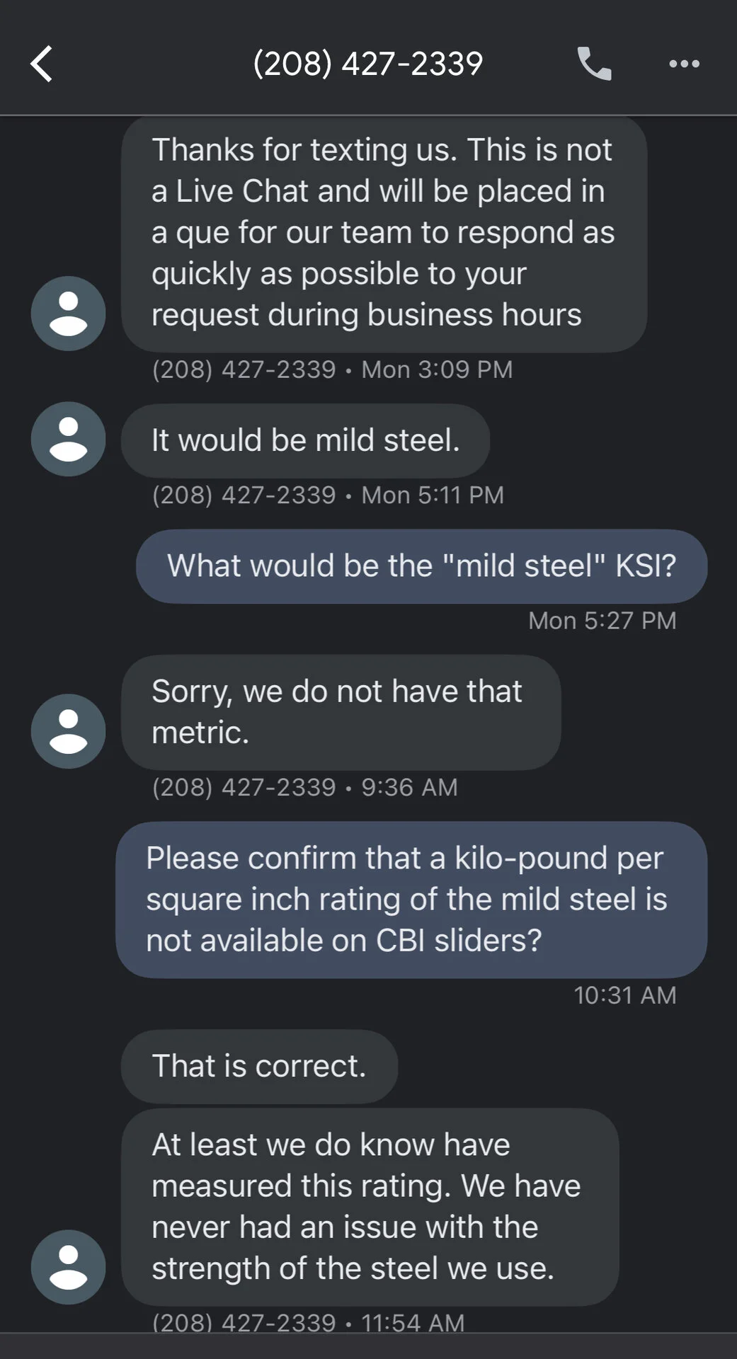

I was strongly considering CBI until I texted them with a general spec. question. Most of their competitors specify the KSI rating - some even offering the choice between HREW or DOW steel tubing for costs analysis/ savings. I reckon they just expect everyone to get in line after Lexus enlisted them on the GXOR concept - but thats none of my buisness...

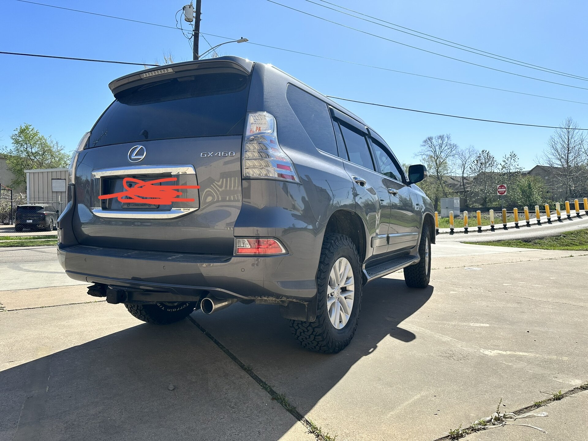

LOL... ya, this is definately on my mind now; especially since I ripped out that dumbA$$ magnaflow overland exhaust system!

I had adjusted clamps, took it apart too many times to count, reset the rubber hangers, twisted and turned the exhaust pipes... literally adjusted everything that connects the exhaust due to clearance and fitment issues for the piece that routes over the rear differential assembly. No matter what I did, once the car heated up… that piece would always make metal to metal contact with the heatshield creating a horrendous screeching/squeaking sound. Not to mention, when performing normal city (at minimal speeds – like less than 45mph) or God forbid highway driving over minimal bumps… the exhaust would hit the underside of the SUV – that sounded similar to driving with a door not fully closed. It is in the process of being returned to MagnaFlow.
