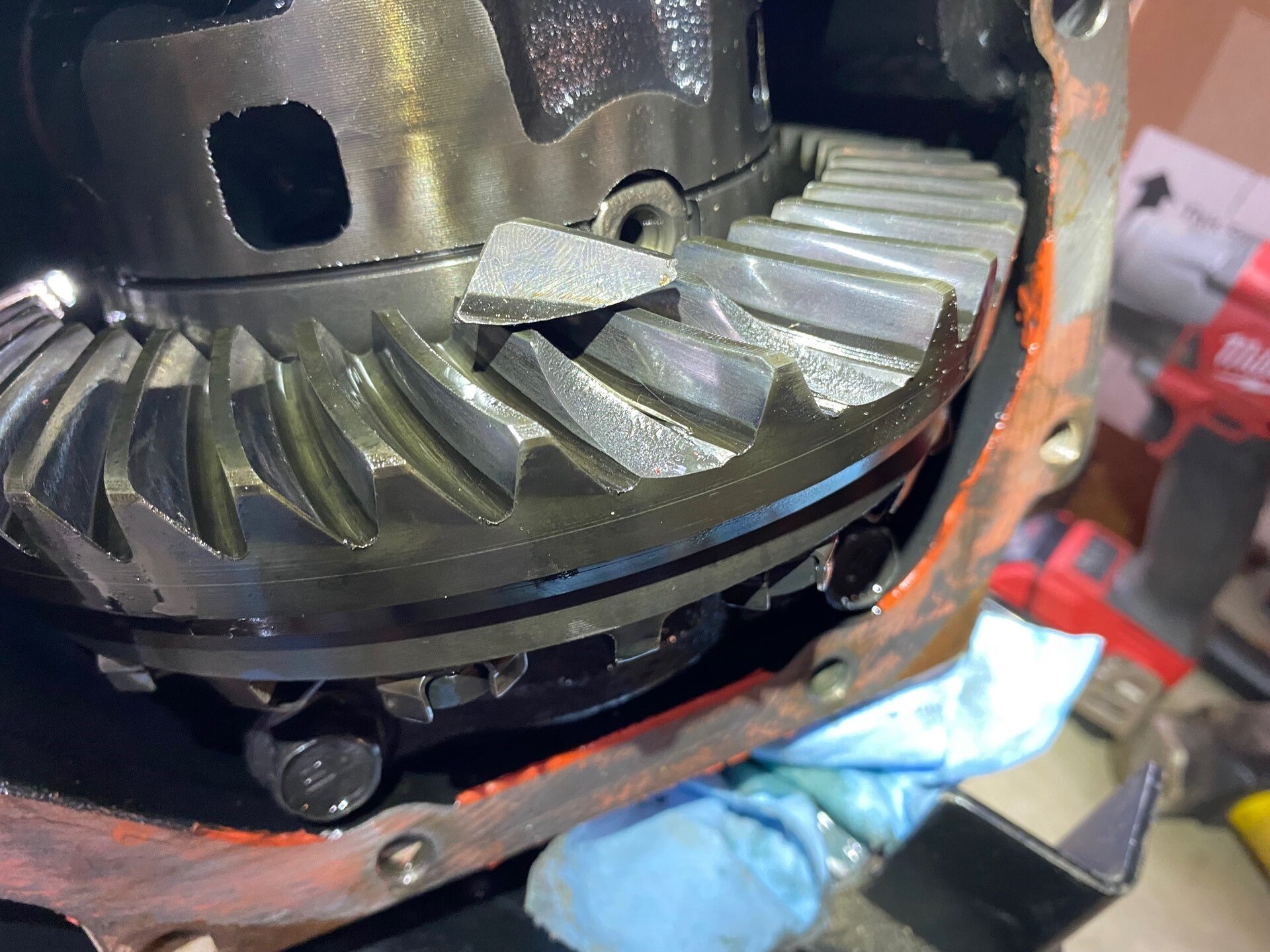

@Chadk15 : I've been meaning to post the closure on this item so thanks for reaching out. The conclusion in my previous post that the failure was inside the front diff turned out to be correct. After removing the diff and opening it up, I found two of the teeth on the ring gear had broken off (see pictures). I found both of the broken teeth inside the diff. It makes sense now why the sound occurred with every wheel revolution: the "woo" sound occurred every time the broken teeth passed over the pinion gear. I got new gears, new bearings, and an e-locker ( :) ) and a local shop rebuilt it for me. Since then no more sounds!
As far as I know these are the original gears. No idea how the ring gear teeth broke.
View attachment 3209522View attachment 3209523View attachment 3209524
Glad you were able to find a resolution! Looks like I may have the very same issue after reviewing your investigation... I appreciate the update!

Mine turned out to be toasted front diff, also. Exact same symptoms as yours. Thanks OP for all the diagnostics and video…large cost to replace, but saved me a lot of time and frustration of throwing parts at a terribly annoying woowoowoowoo noise .
