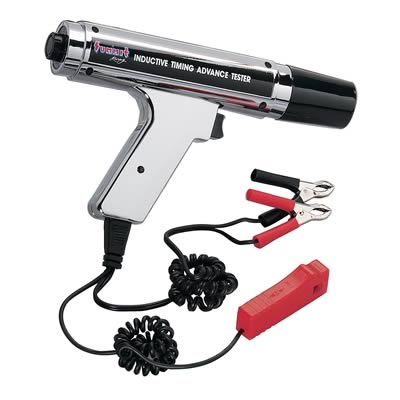

Hooked up properly, and connected to plug wire 1, the timing light flash was horribly erratic....like a few flashes, then a pause, then a few more, then a longer pause...no pattern to it. I had the plug wire clamp pointing in the direction that the instructions said, as well. I tried moving the clamp to each plug wire and results were the same. For whatever reason on plug wire 4, when I reversed the direction of the clamp, it flashed more consistently...this was only true for this wire.
I wanted to confirm the timing light was working, so I hooked it up to my 4runner and it worked perfectly...independent of the direction the clamp was placed on the wire as well. I moved back to the FJ to give it one more go and at least pointed it at the flywheel, but it was hard to draw any conclusions because the light pulses were so erratic. The BB was just moving all over the place, left and right. It sounds like all cylinders are just misfiring like crazy, and maybe the RPMs are so low and the misfires are common to each cylinder so the engine doesn't really sound like it's misfiring to the ear. It just has that "rough" running sound...that chugging along about to stall.
I assume attempting to check anything related to timing with this erratic of behavior and low idle is fruitless. I'm going to try and check vacuum tomorrow to see if there are any major indicators there. If for some reason vacuum readings are good, is it worth just loosening the dizzy clamp and rotating it a bit while the engine is running to see if I can smoothen it out and get the idle up?

Surely if the timing gun is showing intermittent ignition, there must be something amiss related to ignition? From my experience, a vacuum leak shouldn't prevent it from running.

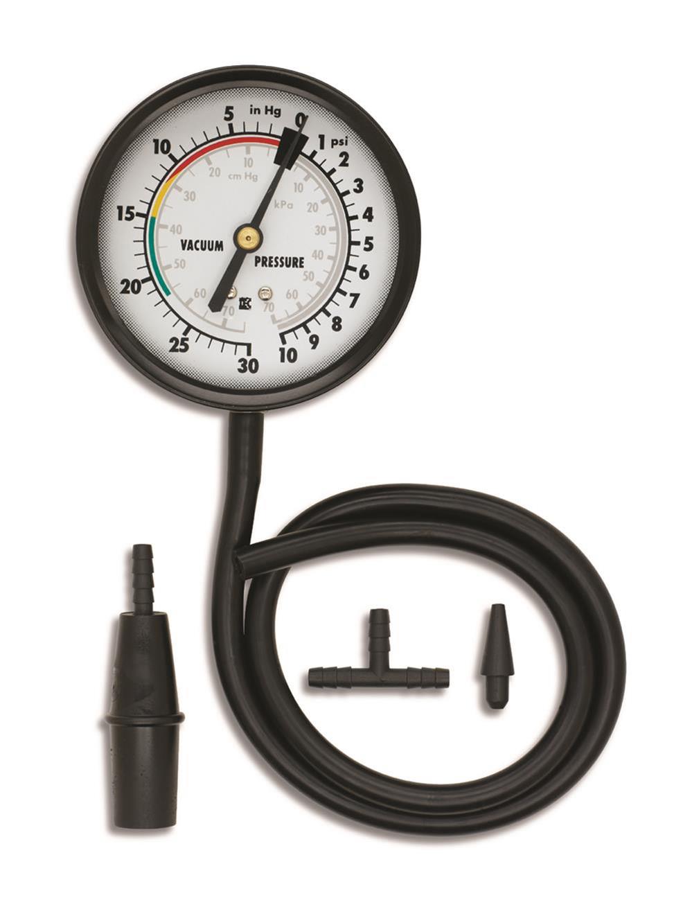

I'm not really sure if I can draw conclusions from any of those tests. My vacuum gauge and dwell meter didn't arrive today, so I couldn't check those. I did try spraying a bit of carb cleaner around the intake manifold and carburetor base, but couldn't register any changes...the truck was just always on the verge of stalling anyway.
