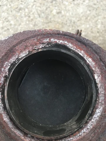

Image here shows the backside of the second catalytic converter...the honeycomb looks fine.

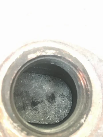

This image shows the front side of the second catalytic converter...the honeycomb is about 98% blocked...thus the total loss of power, I can't believe the engine would even run, but this explains what sounded like an exhaust leak under throttle by the exhaust manifold...pressure built and forced exhausts out the between the gaskets...this also caused the silicone tube to blow off the EGR and shoot hot exhaust all over the valve covers melting the plastic cover. And, I could hear the loose catalyst in the front catalytic converter rattling around under throttle...sounded like a loose heat shield.

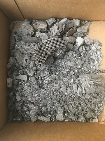

This image shows all of the debris that came out of the first and second catalytic converters.

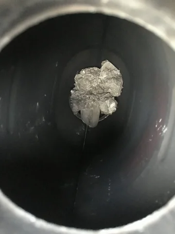

This image is looking down the front catalytic converter...all you can see is one small piece of broken off catalyst...it was too big to fit out of the opening, but it could be broken up and shaken out.
