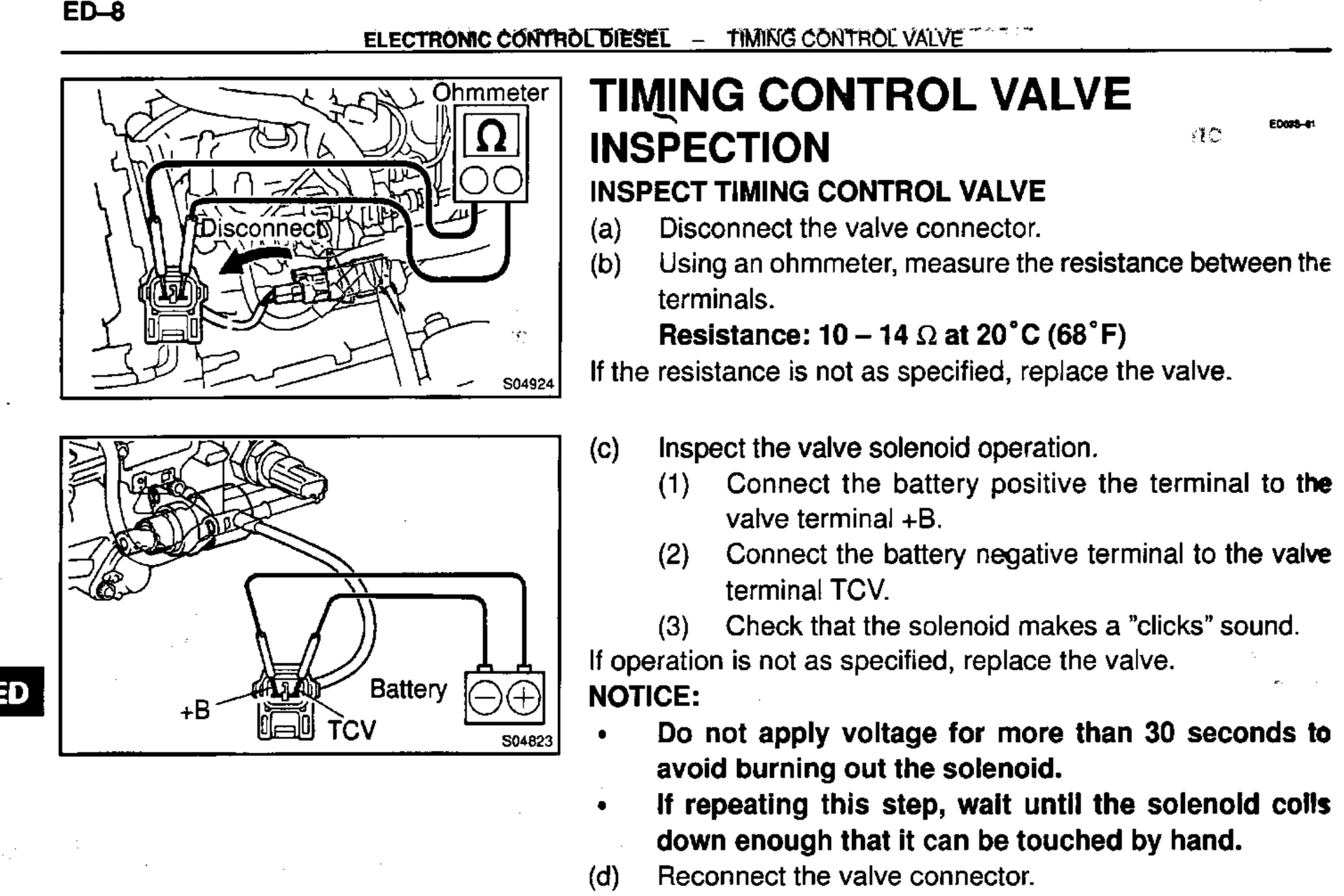

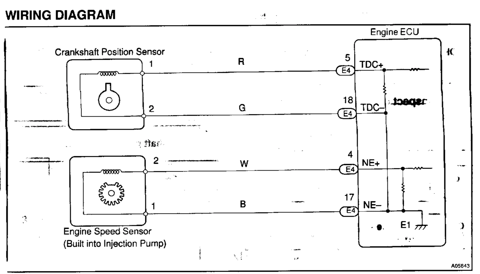

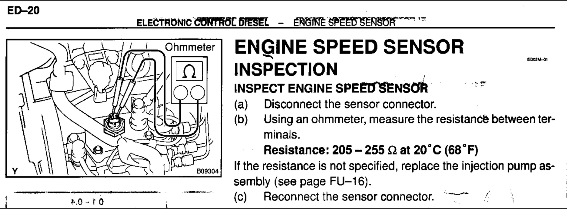

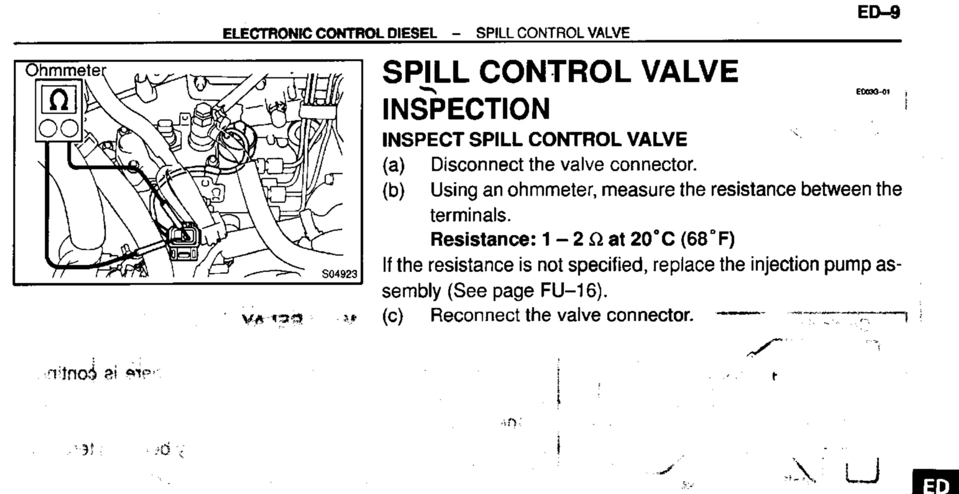

Just fought this issue this week ...
- Check SCV (Spill Control Valve)
- Check crank sensor+ wiring (and correct polarity on wires)
- Check TCV (Timing Control Valve) in the back of the injection pump
- Check ESS (Engine Speed Sensor ), on top of the injection pump
