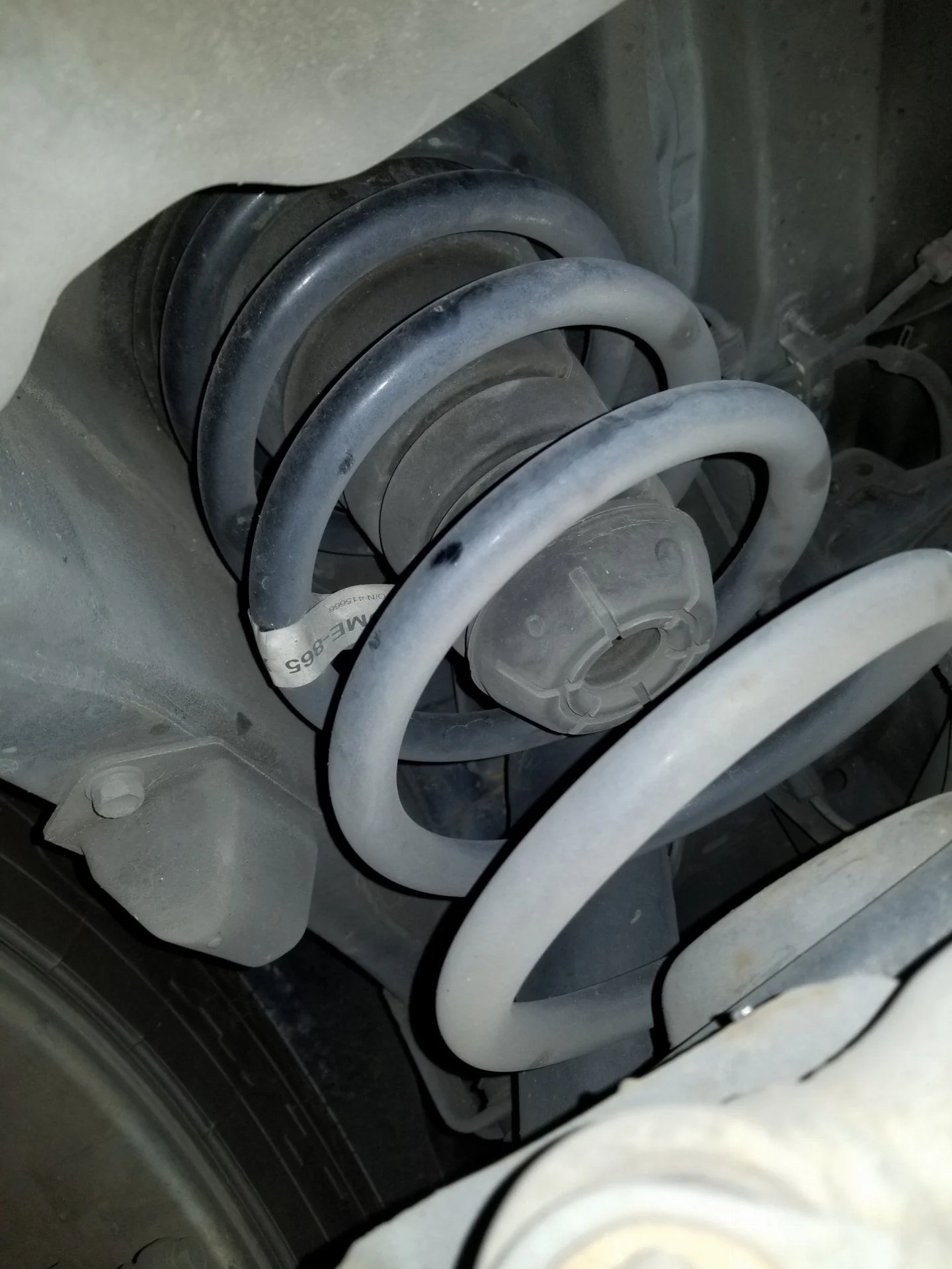

Nice Rig! take and post some pictures of the springs and torsion bars and I bet many are here can tell if they have been replaced or not!

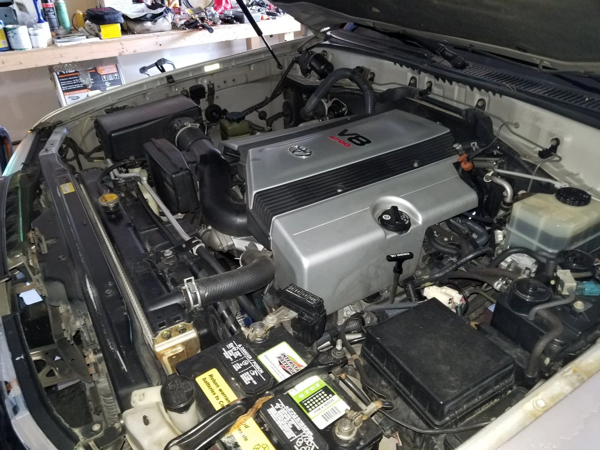

Did some PM today
Mobil one extended performance with a team Ultra Synthetic Media filter. Never liked Fran but these score very high on bobistheoilguy.com.
New indicator bulb in the rear PS and high been in the PS.
Crawled around it some more and im still surprised how vlean the belly of this beast is. Has brand new o2 sensors. I thought it was slightly lifted and finnaly found a tag on the rear springs. Has the OME 1.5 lift.
Cant figure out if the torsion bars are stock or ONE

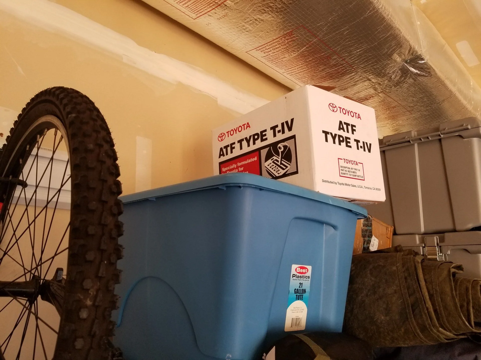

Also got a box of the good stuff. Trans fluid looks fine but want to baseline as any fluids as I can right now.

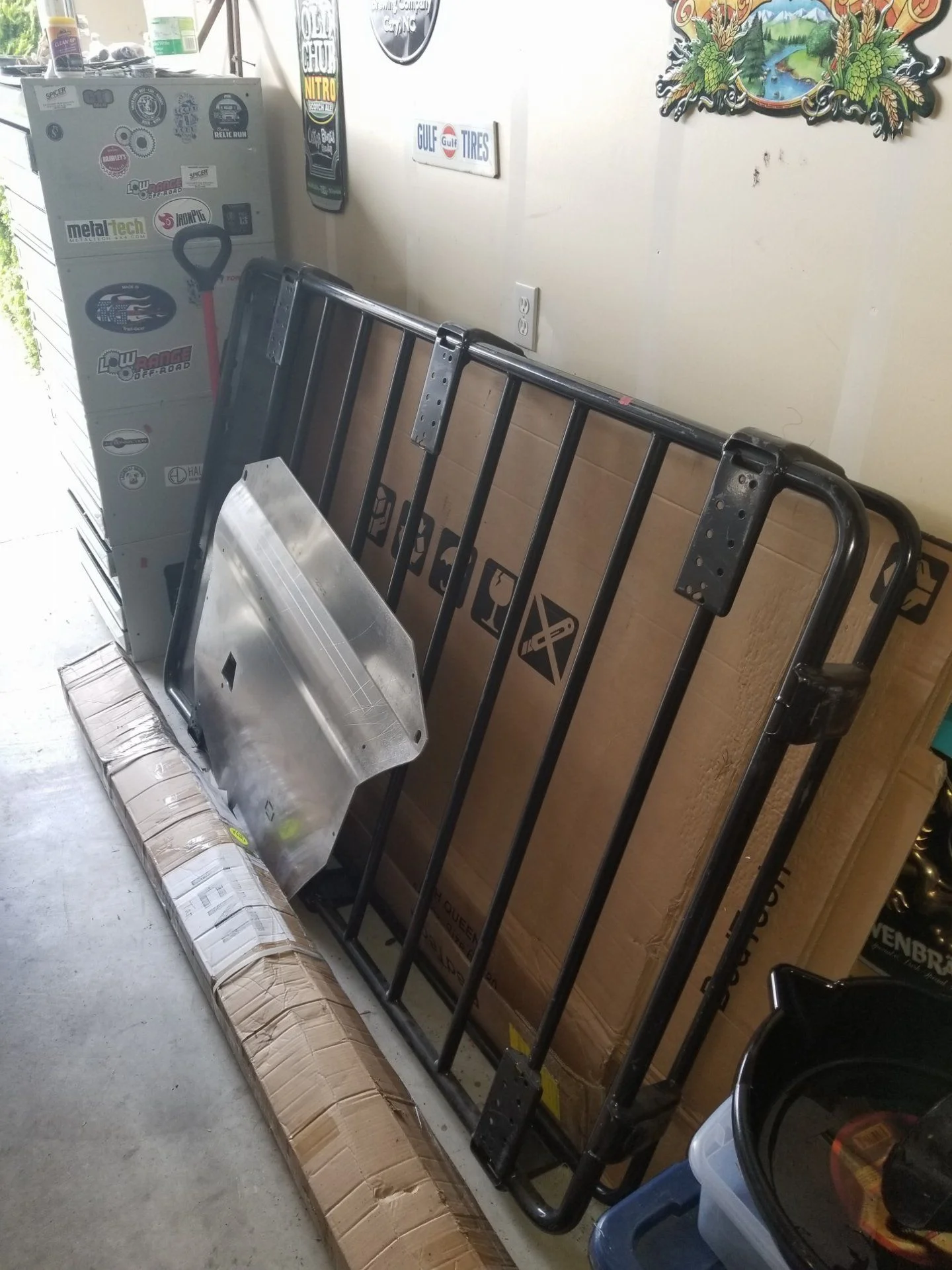

Going to sell my ARB roof rack soon, decided I need something lighter to take on and off since that will stop me from parking in my apartment parking garage and the ARB weighs near 100 lbs by itself..... I pulled it on and off a few times last weekend when I was trying to figure out the mounting for it and decided after a long wheeling/camping trip i'm not really going to feel like pulling that thing off by myself after unpacking everything.
So i'm going to make a J-moose style rack for it. Going to use trailtaylor mounts most likely.
But that won't be until after the sliders and skid plates. Just going to use my yakima load bars for now.

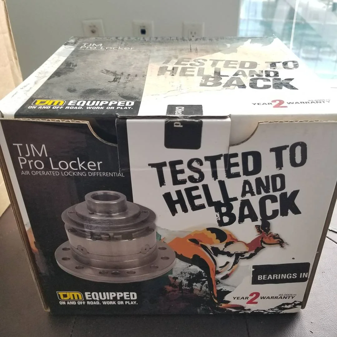

The brown man dropped off some goodness to me today. TjM front locker to strengthen the weak 100 front.... double that for the 98-99 model.
I missed the summit sale but luckily found someone that bought one and decided to go in a different direction. So I got it for the sale price.

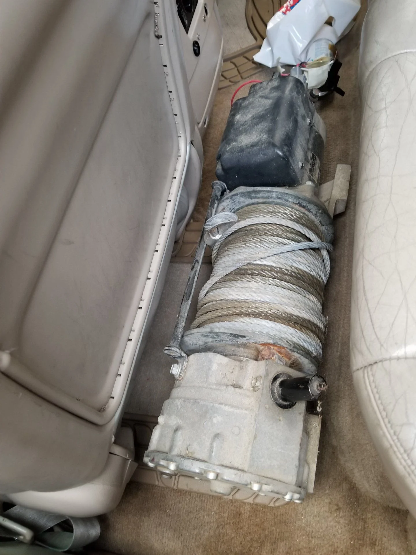

Picked up an OEM winch for the hundred tonight. Woot!!
Congrats on the hundy!
OEM winch is cool. Chrome wheels are not, lol...
Bet you sell em on Craigslist quick, :D
Please update when you figure out if the TBs are stock or not.
I'd love to have a set of the OME rear springs like you have and can crank my stock TBs a bit more.
I have a lifetime alignment at Firestone so it doesn't bother me to adjust em, hahaha...
I'm almost 100 percent sure the bars are stock
