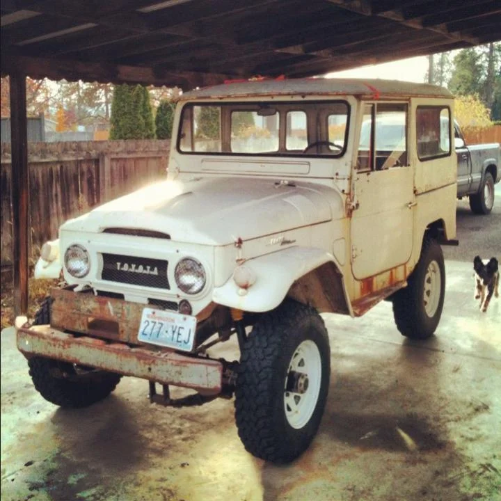

I hope this is being post in the correct section, if it isn't I'll gladly delete and repost in the proper area...
I've always wanted an FJ40, I just have never been in the position to buy..till the other day. I picked up this pile..drove it home about 30 miles!
The previous owner jacked up the roof, so that will be my first project.
I got the dogs approval as soon as I brought it home.
Really nice score:clap:!! What's your plans....resto, modify or a bit of both?? Either way it looks like you have a nice starting point. Did you get any history on it? Looks like it's been looked after for almost 50 years.

Nice rig. The '66 was nice because it had thicker sheet metal - that's why they tended to last a bit longer before the rust demons got to them and you will find it a bit easier to weld patches into without oil-canning it.

Check your vin...looks like it might be a '65...
As for resto/mod...and this is only my opinion, you might want to look for a newer 40 to resto mod...and here's why;
The older 40's had the older, weaker ball and claw axles, for which parts are getting harder and harder to find. It has drum brakes all around on a single circuit master, with a 3 speed tranny, and if still stock, the older/weaker F135...which unfortunately most guys will just remove and dump for a newer 2F or dare I say...350. If this is what you want, I bet you can find a 40 with those mods, for a whole lot less than what it will cost you to swap all this stuff out on yours. Your best bet for a rest mod would be a '75 and newer 40.
Also, since I am a purist, I should note that if this rig is still all stock and original, then it would be a shame to take apart a rig that has lasted this many years. As the years go by, less of these older stock rigs will be around....and I think it has more "value" as a stock older rig, than one with mods. If mods are still what you want, then if it were me, I would look at selling it to someone who appreciates the older rigs, and take that money to buy a newer rig to mod.

Did you check your vin number? That windshield is from a '65 and older 40. If I could see the heater air intake on the front passenger cowl, it would help date your 40...if it has an intake cover with a diagonal grill, then it will be a '65...which was probably sold and titled in '66 :beer:
Did you check your vin number? That windshield is from a '65 and older 40. If I could see the heater air intake on the front passenger cowl, it would help date your 40...if it has an intake cover with a diagonal grill, then it will be a '65...which was probably sold and titled in '66 :beer:[/QUOTE]
I did check VIN, from what I understand it is a '65.
Very interesting...
That windshield with the lower vent came on '65 and older 40s...with a corrugated top. The interesting part is that it was in mid '65 that the corrugated top ended, and this model of top started (with the rear corner glass) so my question is...was this one of the last 40s with this old style windshield, and they ran out of the older corrugated top, and started with this newer style top...or was the top simply changed at some point in the last 45 years +
Is your frame anywhere near 35340? This would be mid year '65, and about when the 40 changed from corrugated top, to the newer style top and windshield, and to doors with wing windows...the corrugated tops had doors with bug catcher windows.

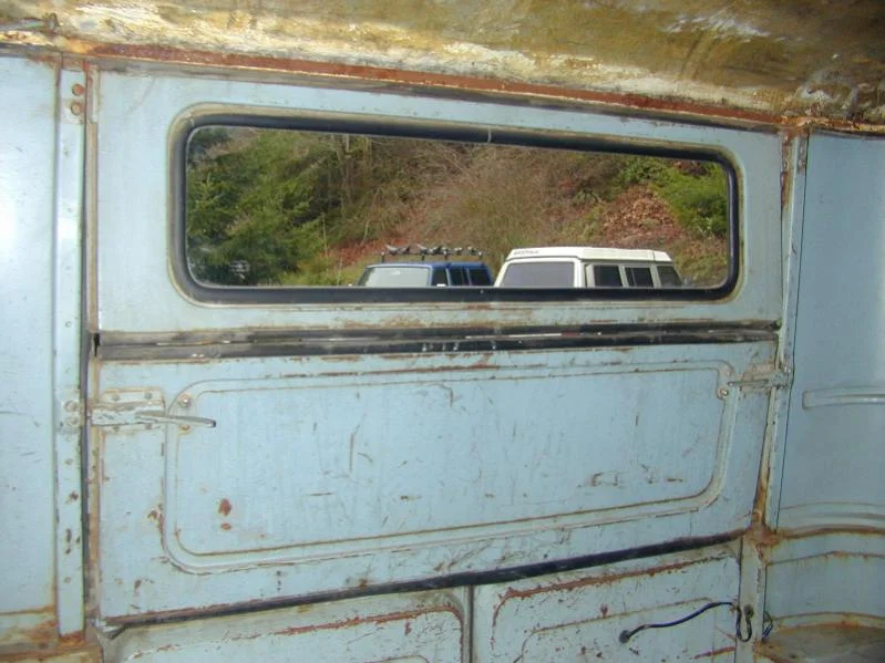

If you did not know what a corrugate top was, here are a couple of pics of Landpimp's '65. Notice the diagonal grill on the heater air intake on the front passenger side of the cowl, and the rear bifold door with the smaller top window.
My vin # is right around there, I emailed the previous owner and he told me that the "son" who owned it replaced the top with a newer model..so that is why I have the corner windows..
