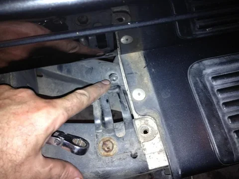

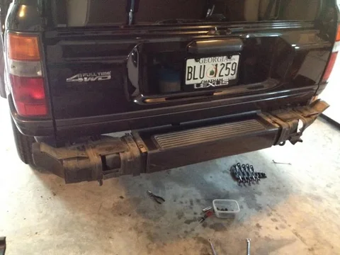

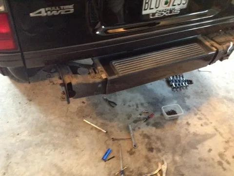

welcome to mud ************ My LX is almost exactly the same. If you're referring to the aluminum step found on the rear of LC's, then yes, it does bolt right up. Here's a link: https://forum.ih8mud.com/80-series-tech/141641-rear-aluminum-step-lx450.html
I'm in the middle of doing the same on mine. Remove the corner bumper covers and metal frames and you can get to the four bolts that hold down the center section. Same bolt pattern as aluminum step.
